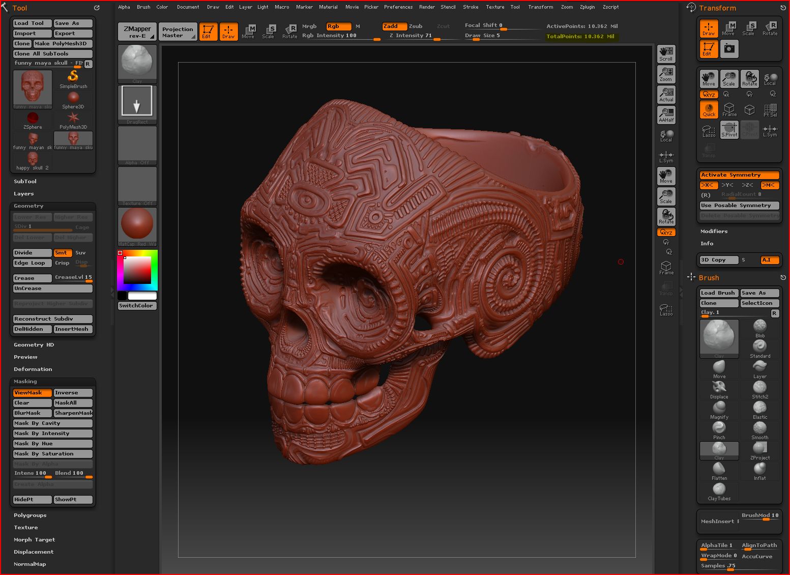

what I think I’ll do is mask cavity and push the detail fo the milling models.
I usually have to push out the details for milling, especially when I do small pieces.
but i’m have problems crashing out when masking… i’m a little anoyed.

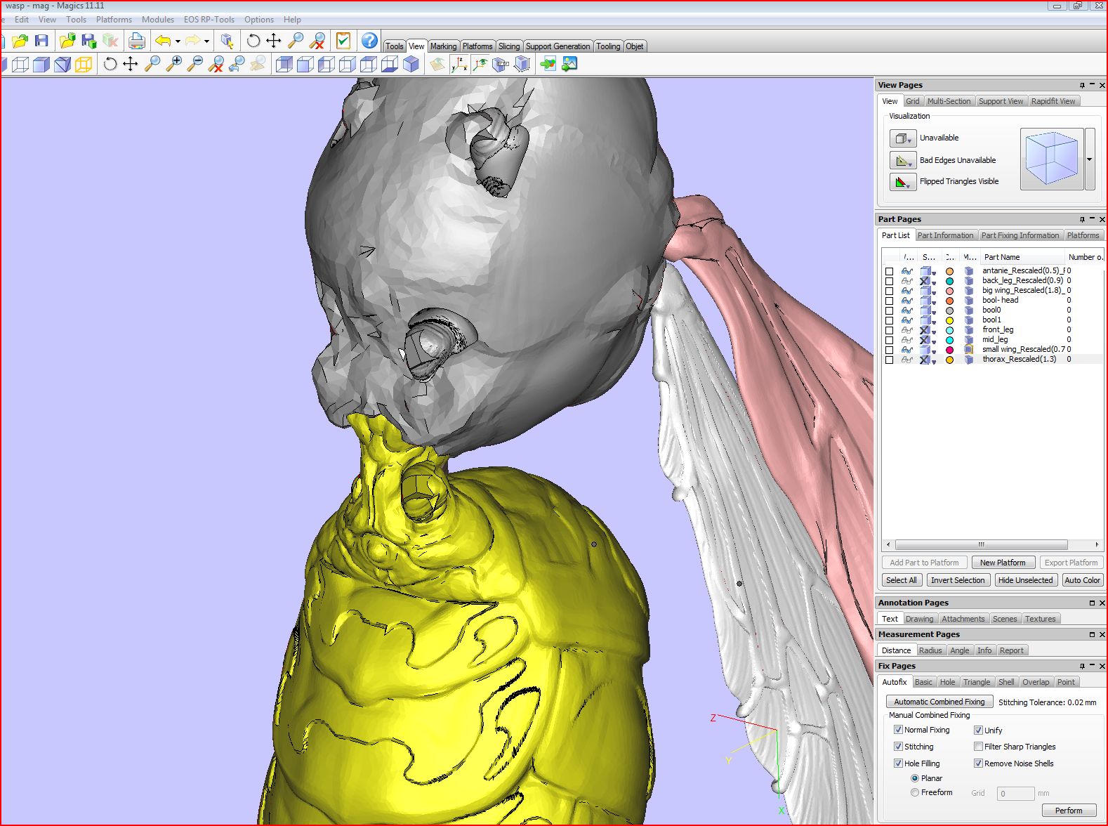

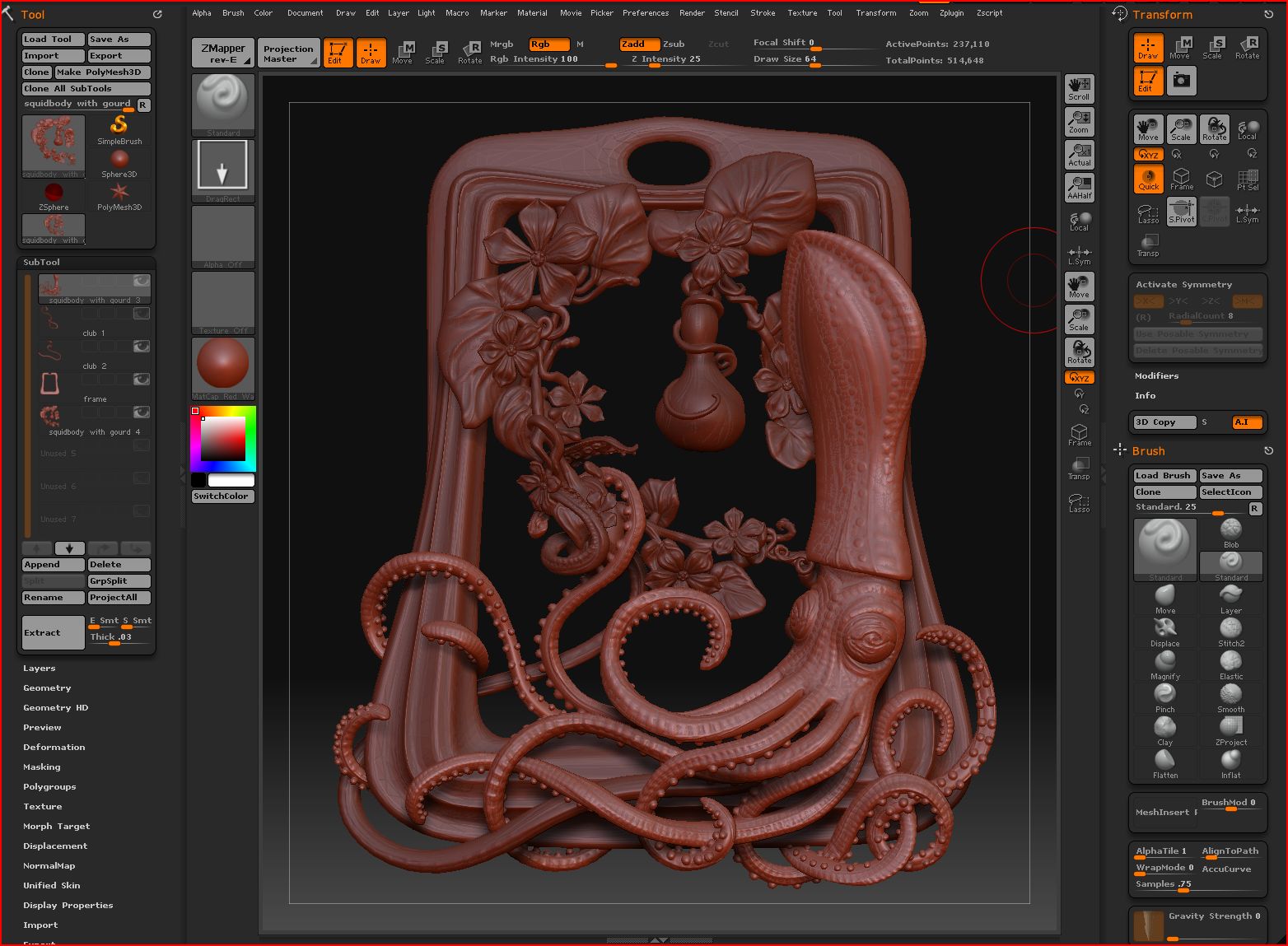

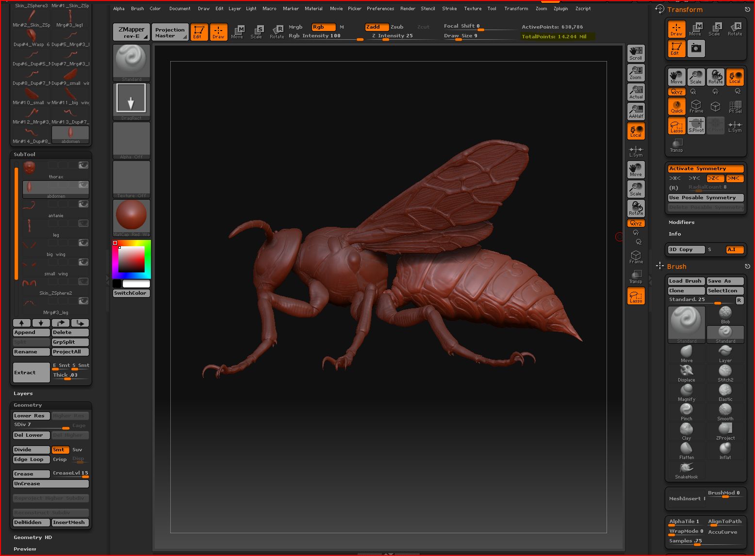

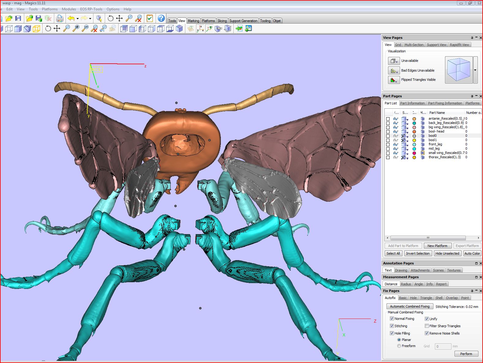

Sigmund Hentze - I used to have to use 3 programs to get the model down to where i could build tooling paths. and the stls that rhino would export were sloppy. it couldnt tell the difference between sharp details and inverted norms or noise shells so it would screw the details.
I dont know what they did in there but the stls are very very clean. I run one or two passes in magics and the shells are beautiful.
yes it is, they made it too easy… lmao
wolfie - yes it is.
AngellDude- I go through rhino so I do all my scaling there before I build my milling paths. now what ever program you are building your tooling paths in, you should be able to solv the scaling issues there.
as far as work flow it took 3 other programs I used down to a two button process, my god it made my life sooooooooooooooooooooo much easier.

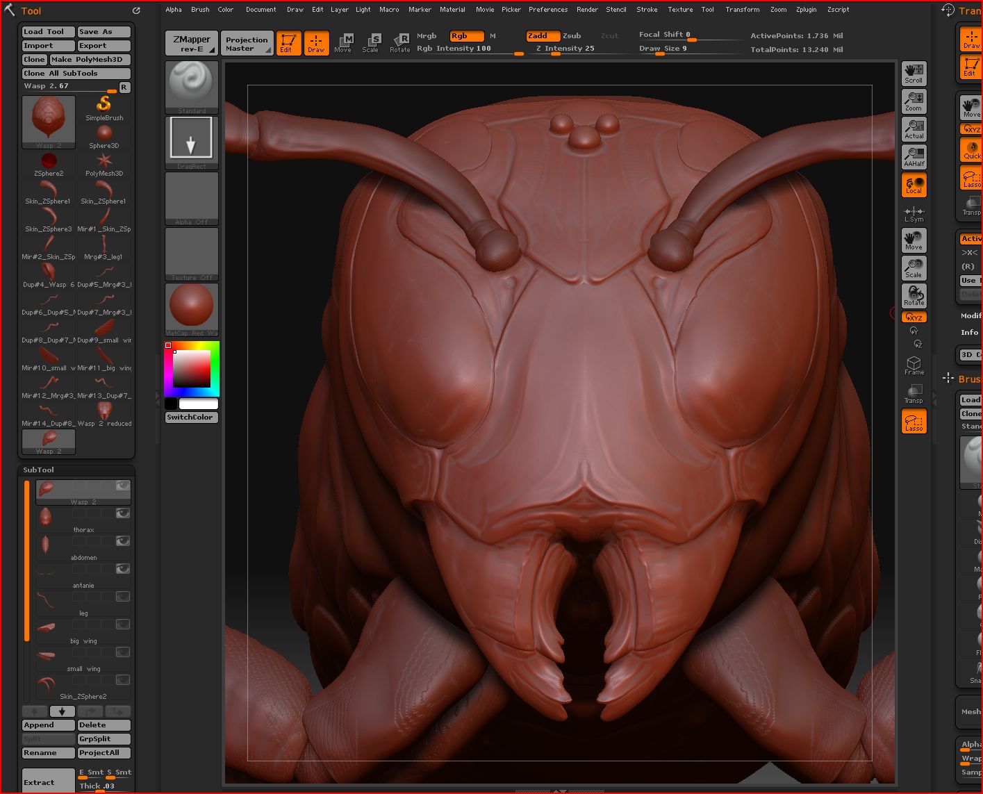

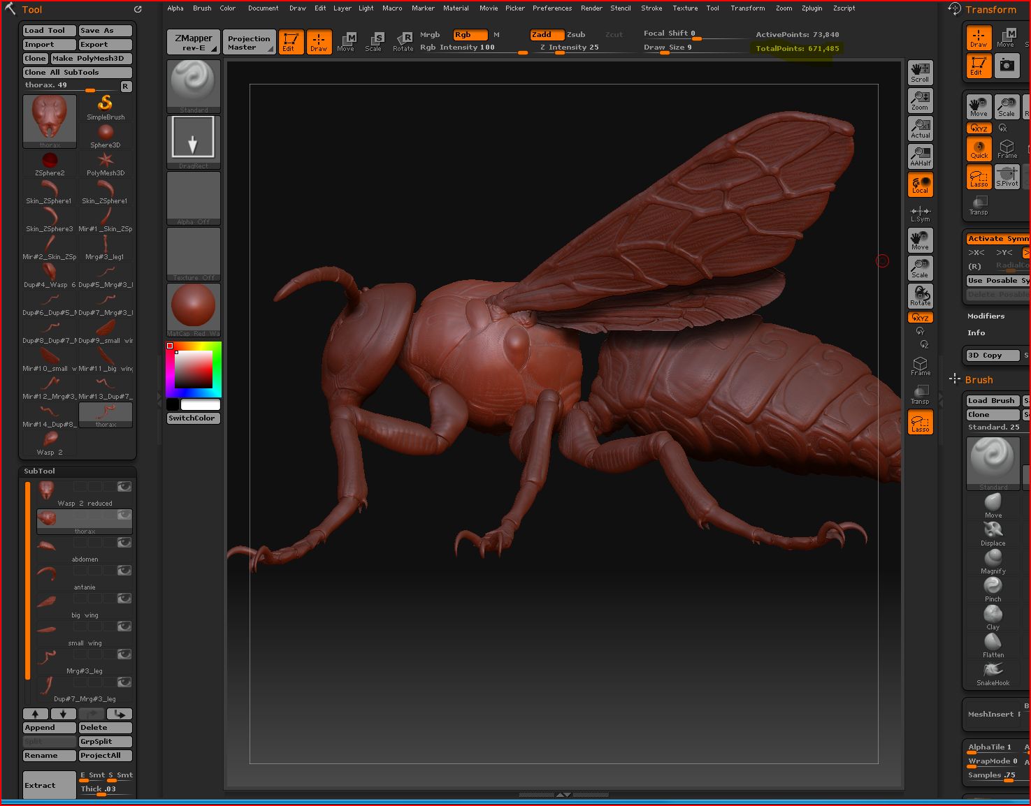

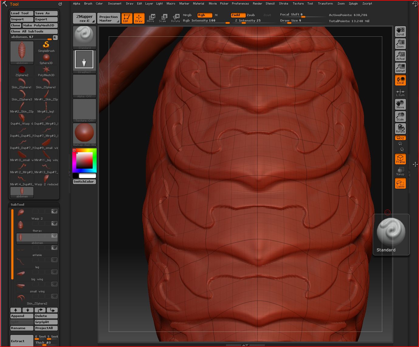

here are a few projects in process steps.
I’ll dig up a few others tonight or tomorow.

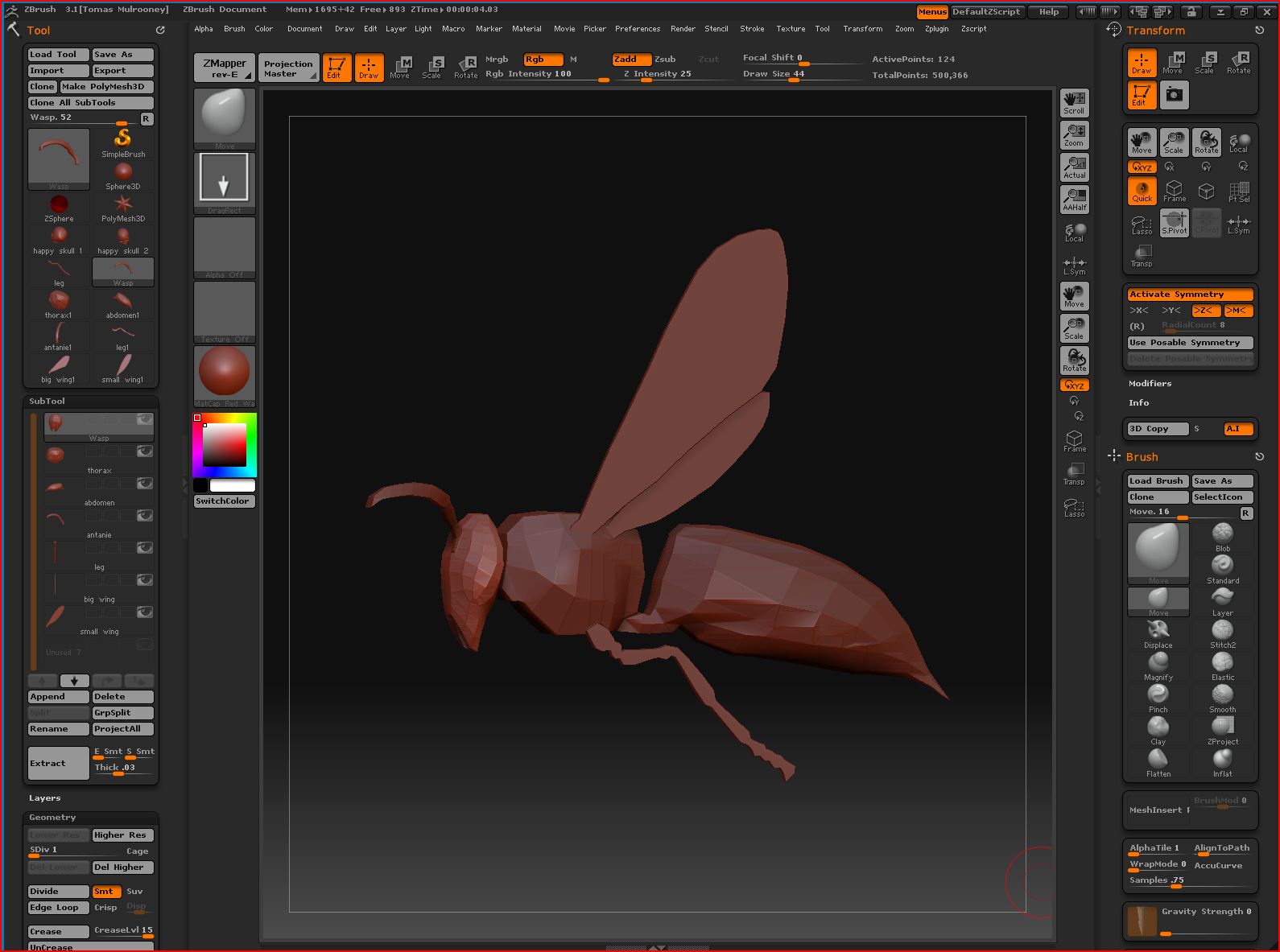

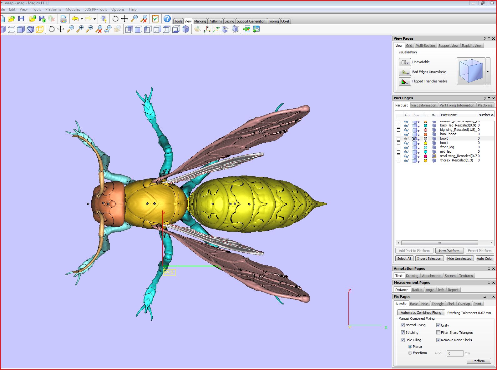

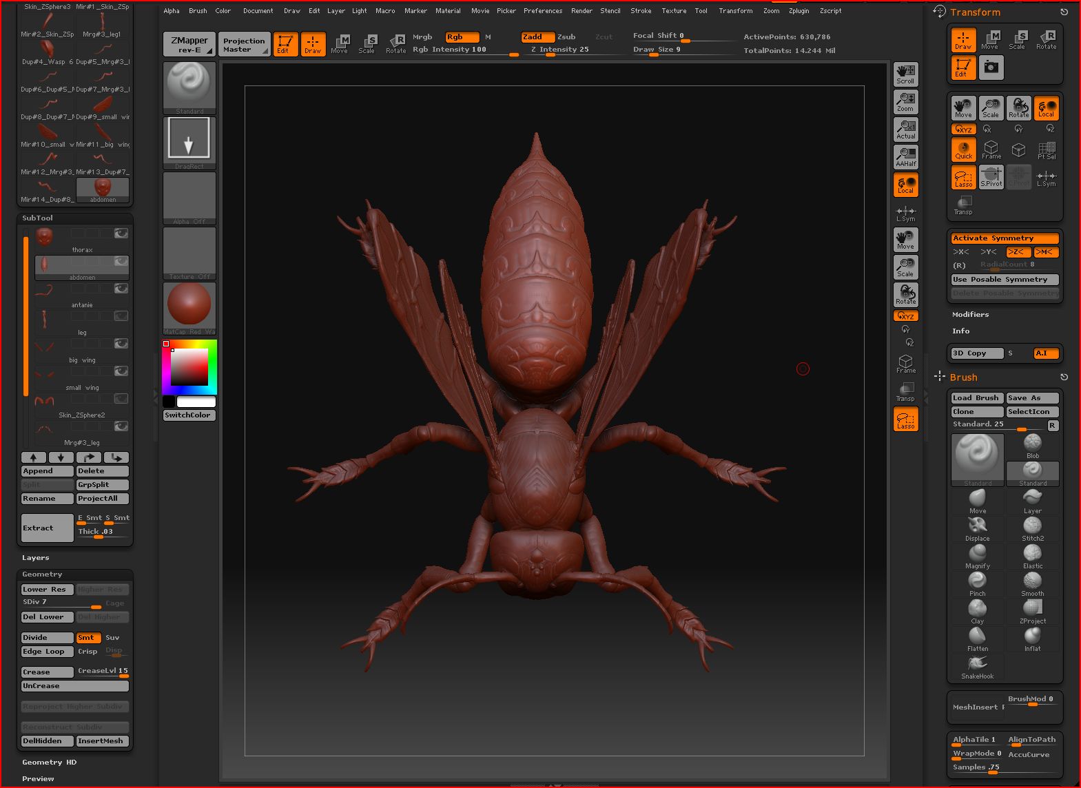

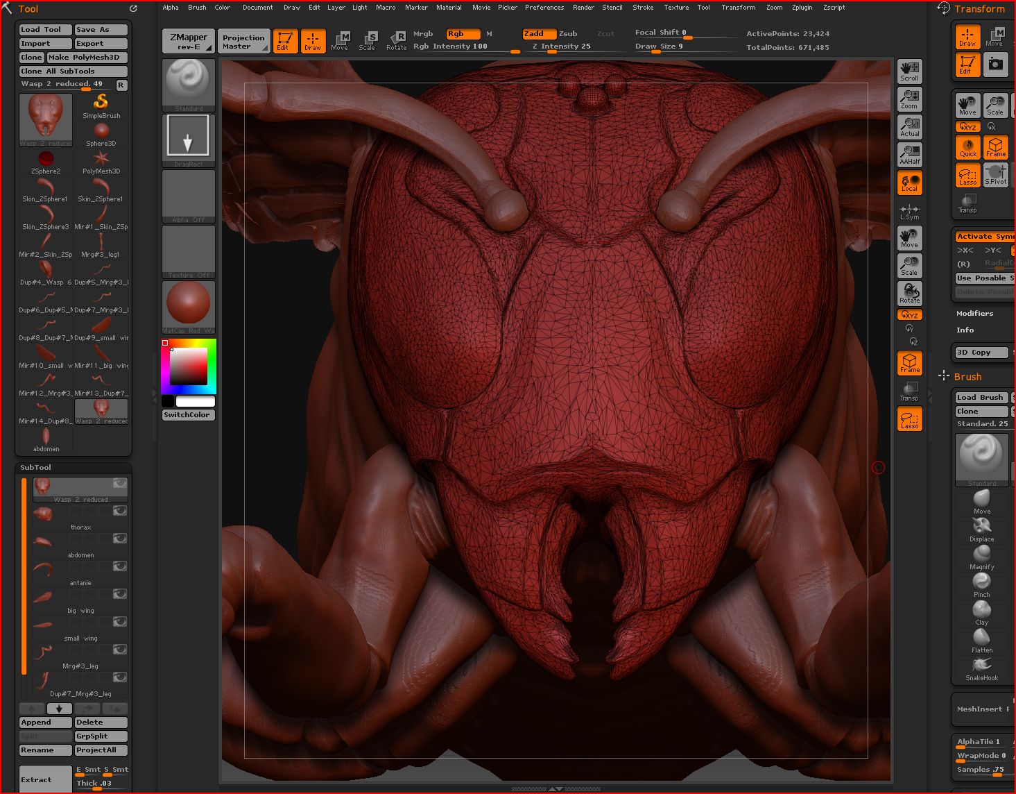

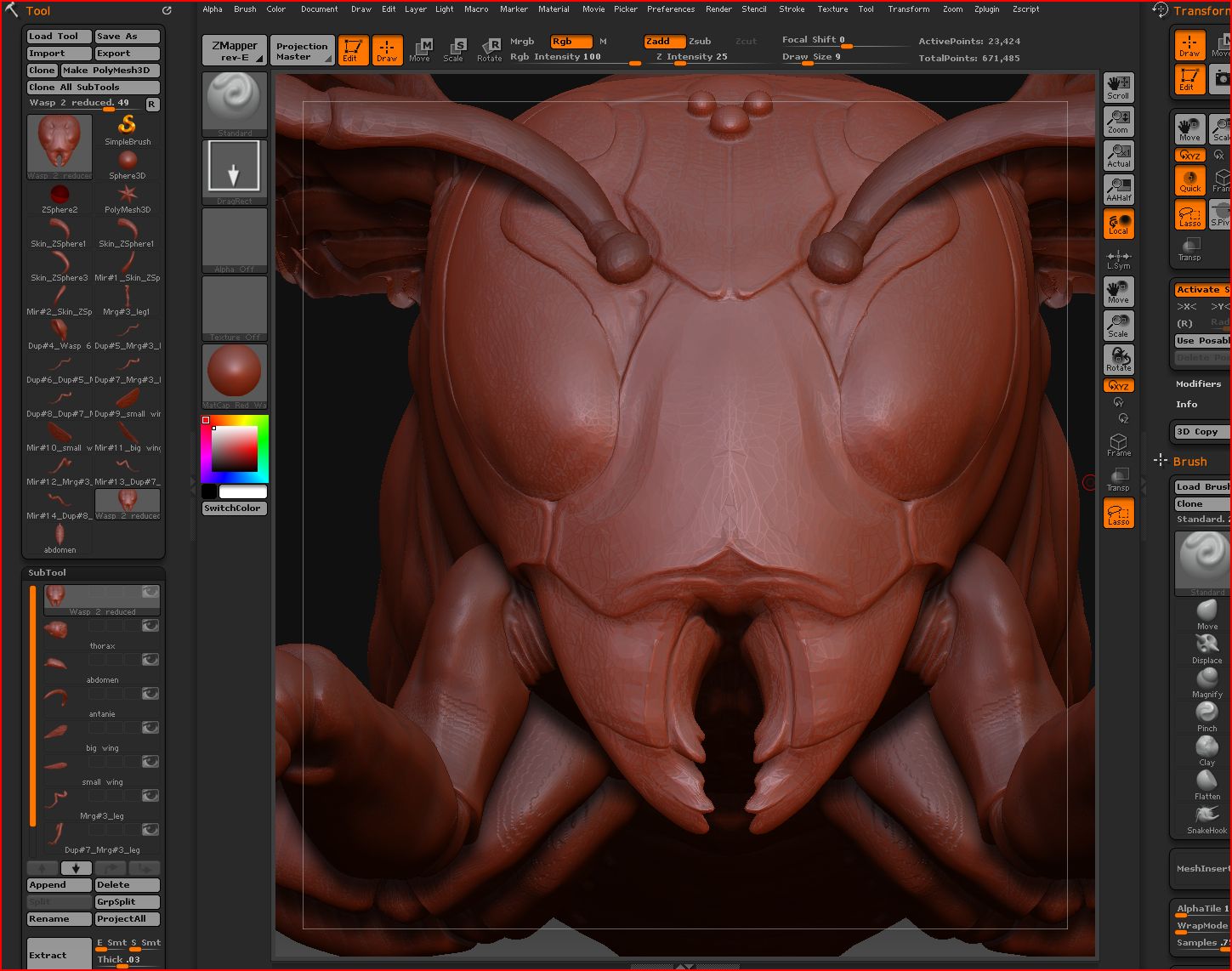

wasp-
the base model was 13,000,000 +
the reduction was 700,000 +

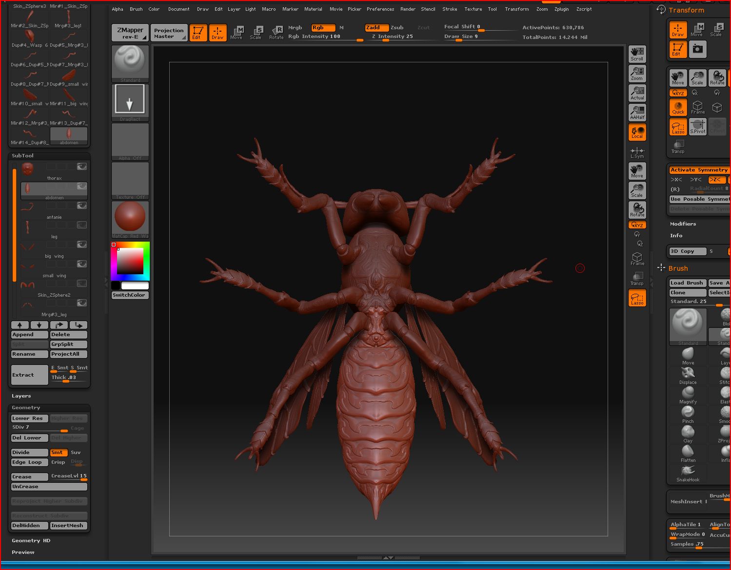

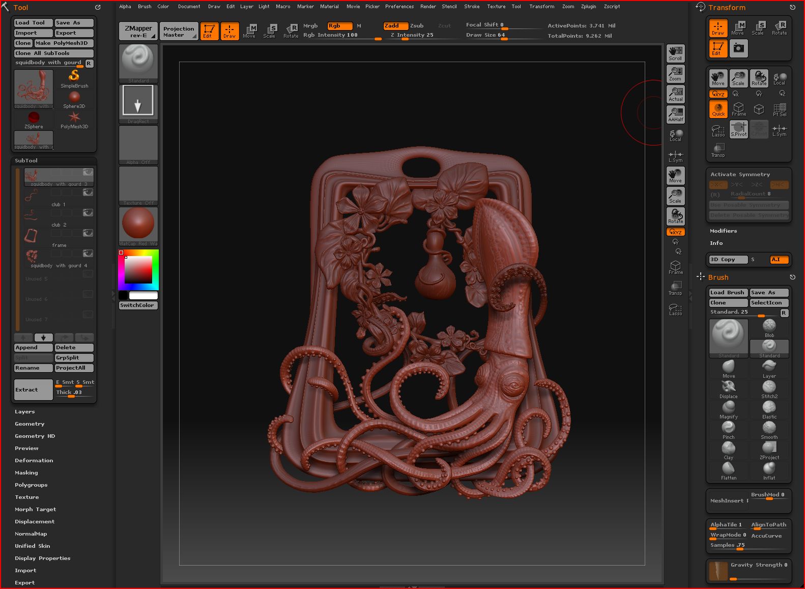

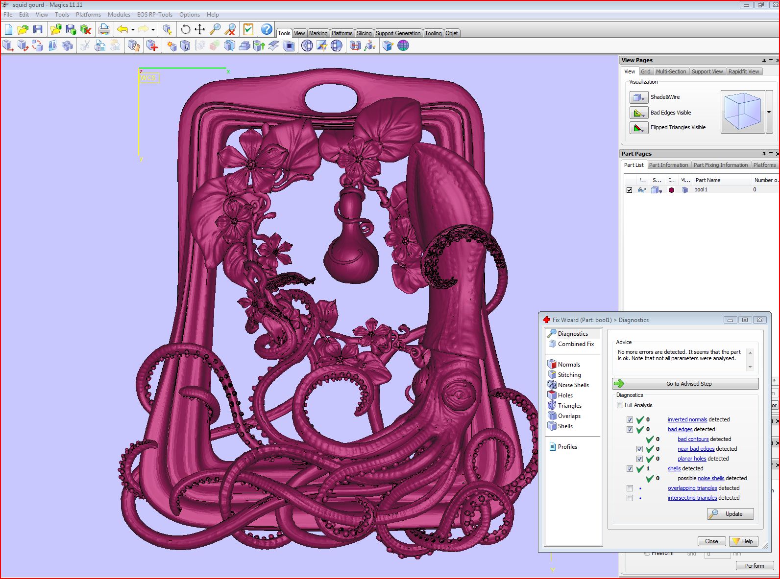

squid-
the base model was 9,000,000 +
the reduction was 500,000 +
and then the shell in magics.

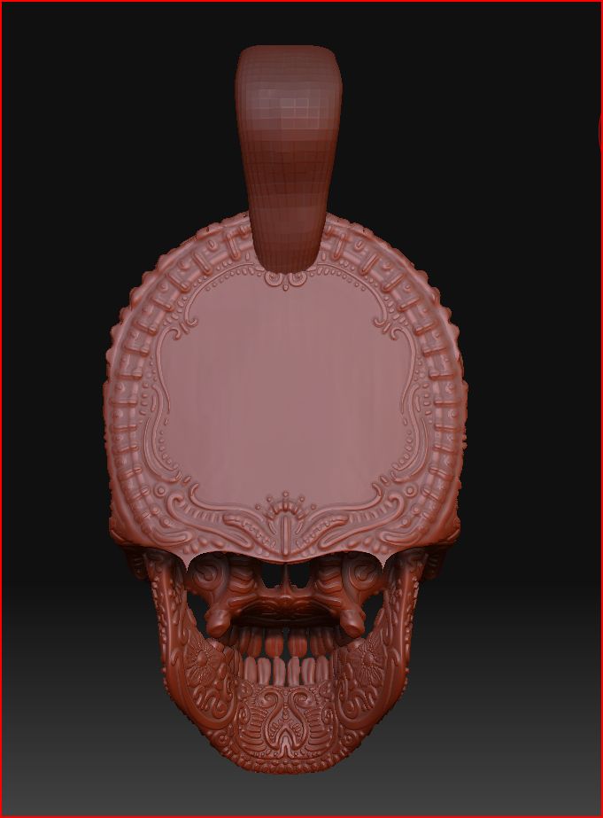

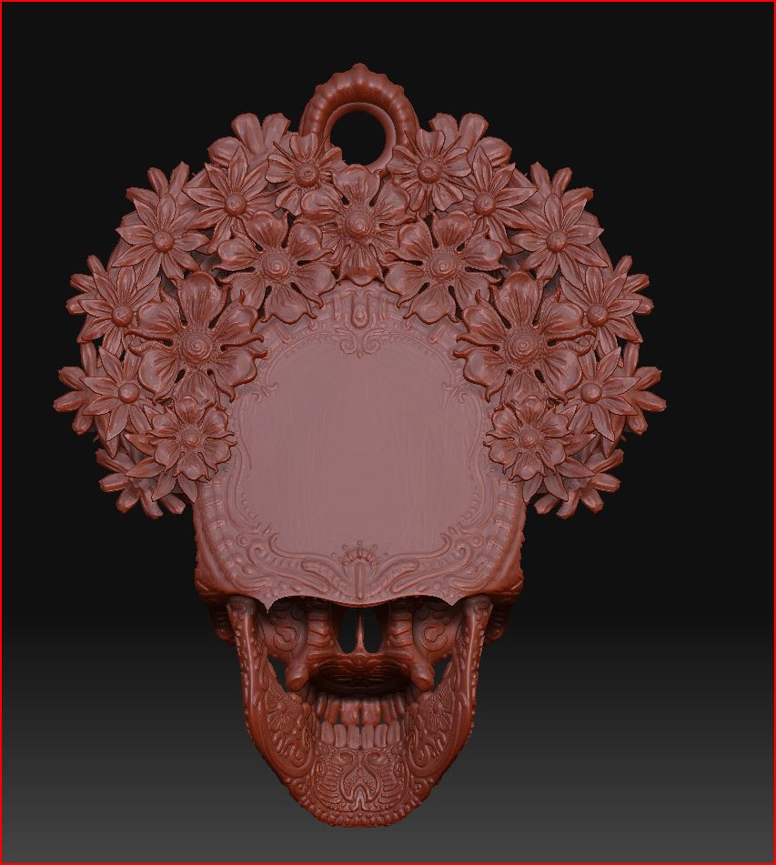

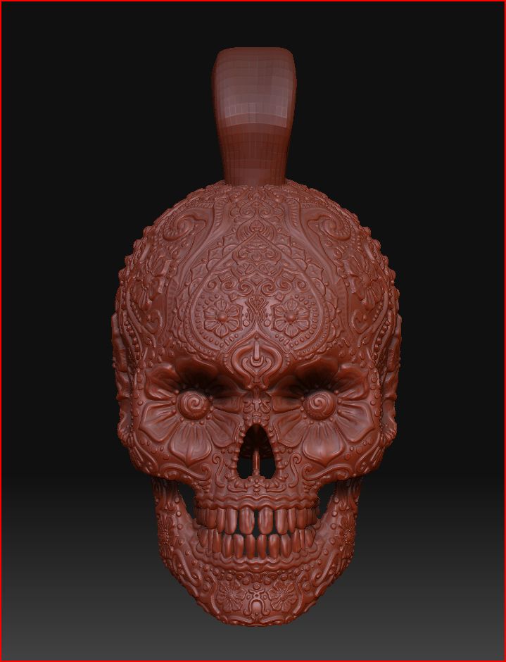

some other parts…

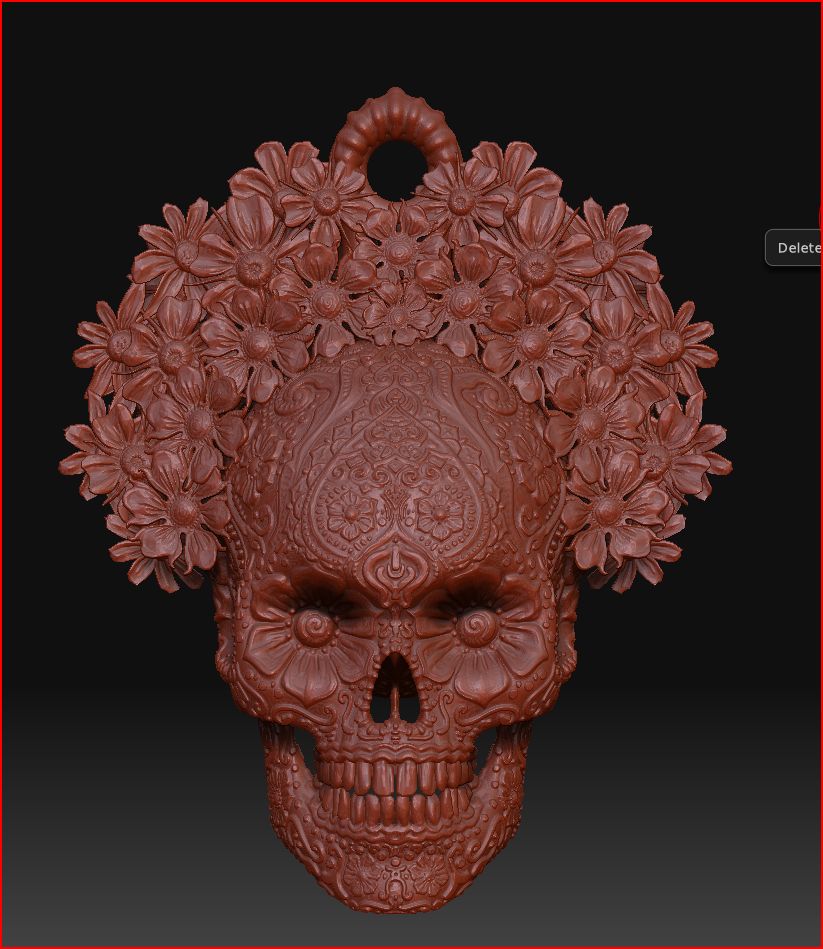

now you may think there is some redundancy but remember I’m designing a line of jewelry so I answer requests. so be kind lol the suger skull sells lmao.
I’ll post the pics of the pieces in silver as soon as i take pics of them.
