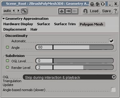

Thank’s for your critics and comment, I decide ton build a little tutorial to explain my technique for apply a displacement map from Zbrush inside XSI.
This tutorial is for person who want to apply displacement from Zbrush inside Sofimage XSI with Displacement 3.
Displacement Setting Zbrush – XSI
  • This is a really precise displacement technique for XSI.
  • Import the 16bits image you create from the zbrush extration inside XSI, in general, you have a better result if you put your image in .tiff.
  • Next, select the node inside the render Tree ( Scalar_Math_Basic ). To found this node, go inside the mathematical node.
  • Connect the Displacement image to the first Scalar_Math_Basic imput and connect the second Scalar_Math_Basic inside the imput of the second one Scalar_Math_Basic.
- Scalar_Math_Basic :
Change the value of the the imput 2 by 0.5 et Operation by subtract
- Scalar_Math_Basic1 :
Change the value of the the imput 2 by 5 et Operation by multiply
Open the Geometry Approximation pannel for this object.
  • Inside Polygon Mesh panel , put the Render Level at 2
Next, in the Displacement panel, put the Max Displ by 2, and the Lenght by 0.25, check the View Dependent and put the Sharpness (%) at 100.
That sit, all of the value maybe change if you don’t have the same scaling I have. For exemple, all of the value I have is made with a head look like the xsi charater head.
Thank’s all and I hope you like this tutorial.
Cheer’s Steve Jubinville

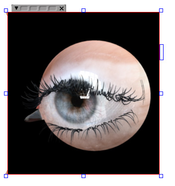

rayfusion: Really simple to create a good eye effect. Look my eye tutorial!
metric: I Clay!as you going my friend. Long time I don’t talk to you! Thank’s i’m happy you like my work! I star the creature for fun, I send that in other thead! Waht are you doing at Meteor? In Hybride, We just in a border to finish journey… 1 mount… heheh!! Ciao and reply me!!
henkten: Thank’s man and continue to see my work!
This is the Step:
This is the Eye Result
Before I start the shading, I create 2 spheres, One for the Cornea and other one for the Iris. In this image, you will see the Lashes and the little grid I use to create the water effect.
When my eye is create, I use the SSS shader to make a better result. The shader is for the Iris, different kind of maps is nessaisary for that. Diffuse, bump, overall, epidermal and spec map. I use the same way I use for the skin.
Inside the node:
Now, I shade the Cornea. Really simple. Simple Phong for the shading and all reflexion is create by the little reflexion plane I made in a right place and my environment sphere create other Hight Light, See my skin tutorial.
That sit, the most important thing is the light rig, without that is not possible to recreate realities.
I work on a 4k texture map now, I will send my result soon! Hope you like this tutorial!
Enjoys!
All of the essence of the face is inside the eye!
Steve Jubinville
