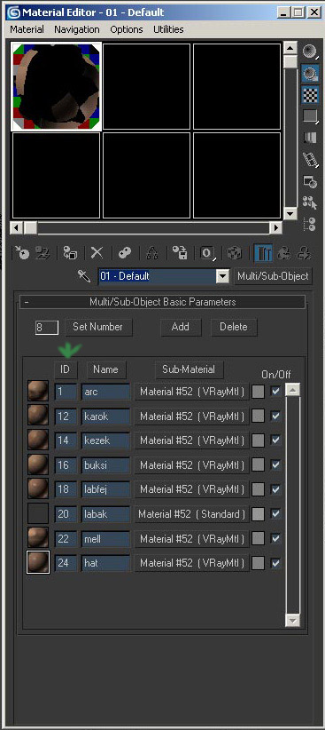

I assigned different IDs to the parts. For example: face has ID 1, arms have ID 2 etc…
Then I made a Multi/Sub-object material.

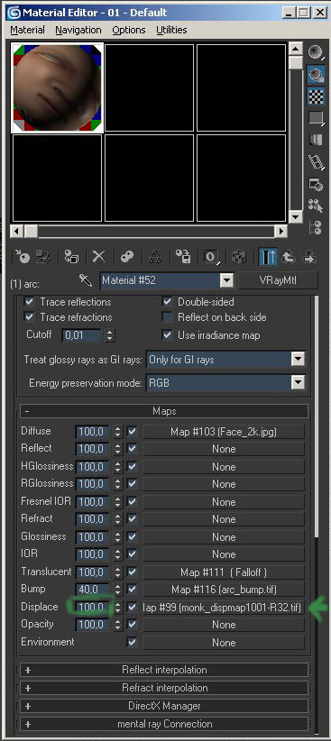

There the ID 1 is the face material (vray material, displacement slot has the face displacement map generated by Zbrush)
The other IDs are like that (the materials have the corresponding ID as the mesh parts have)

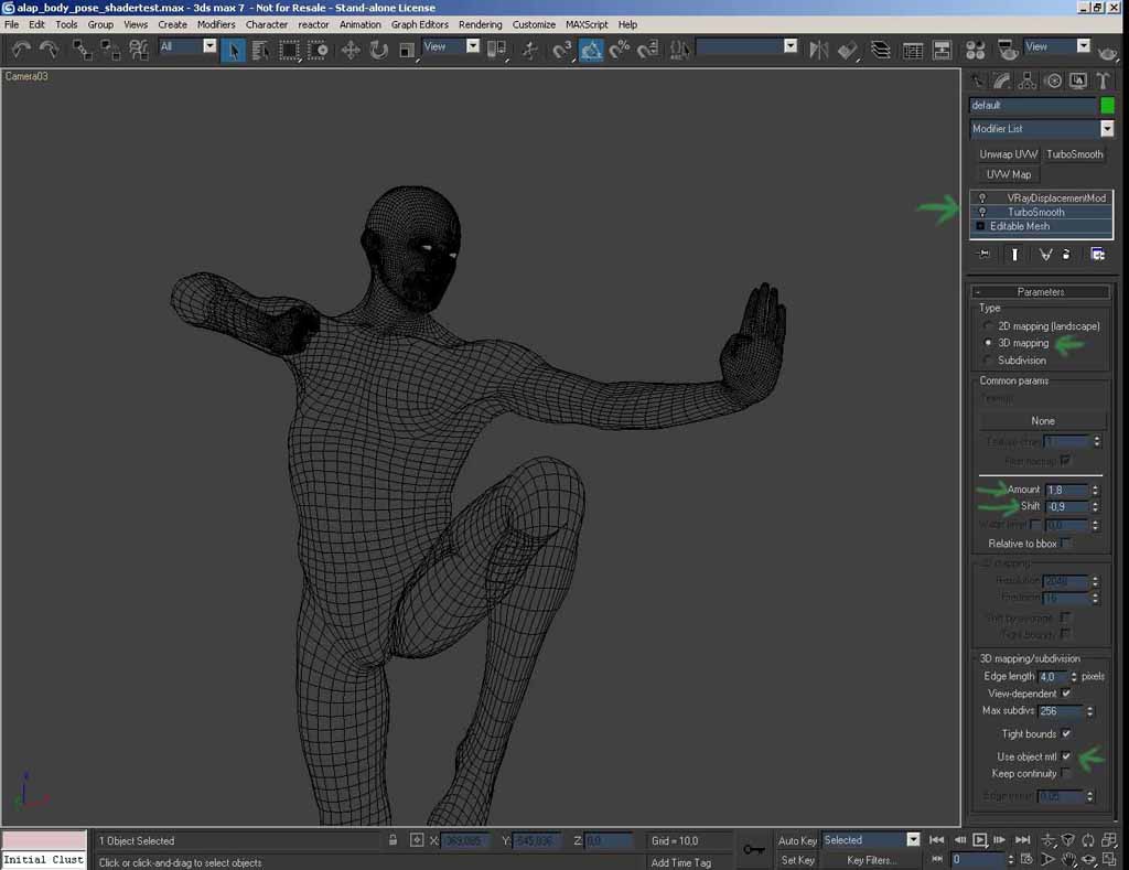

When the Multi/sub-object materials are done I added a turbosmooth mod with iteration 1 and the Vray displacement modifier to the imported mesh with 3d mapping. Played a bit with the amount and shift (mine is 1.8 and -0.9). And ‘use object mtl’ is on.
So it renders the mesh displaced by all the maps Zbrush generated for the parts.

Do not put multi/sub-object material into the vray disp mod! Just add the multi material to the mesh. And apply the vray mod. Then turn on ‘use object mtl’ in the vray disp mod.:slight_smile:

Sure, here are 3 screenshots.
[attach=29048]scrn_mated1.jpg[/attach]
[attach=29049]scrn_mated2.jpg[/attach]
[attach=29050]scrn_vraydisp.jpg[/attach]

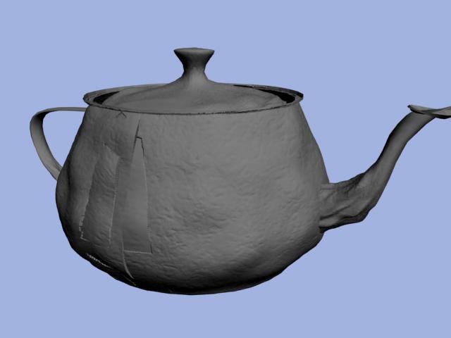

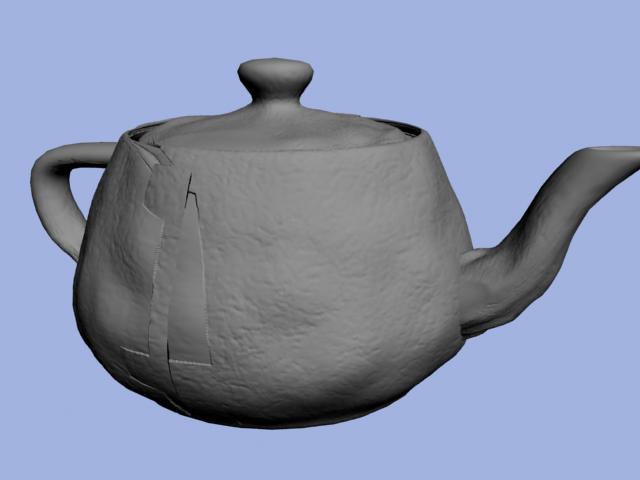

Hi all,
I really don’t know where I’m going off track, but I think i can narrow it down to 2 areas.
  1. When to export and what part of the mesh to export, from ZBrush to max.
  2. How to properly use the multidisplacement plugin or just the normal displacement map method…but at which point is it meant to be generated.
The images below show I’m kinda getting closer.
The major things I’m getting stuck on (probably cos theres too many cooks now) is when to split the mesh in zbrush, and then whether to delete hidden, or makepolymesh, and then once I’ve sculpted to around 2+ million poly’s, do i export the mesh that I’m working on?, or do I export the disp map now (at subd lvl1 of course) or do I use the multidisp2 plugin?
And then in max, I’ve tried using multi sub objects and also vray disp mod’s, one of these methods works, for most people, I just need to know which one it is.
Help anyone?
Sonder!!
[attach=29158]overlap+seams.jpg[/attach]
[attach=29159]oooh so close, yet so far.jpg[/attach]
Ok. Let’s say you want to detail a teapot in Zbrush.
You create a low poly teapot in Max. You Unwrap the Uv coordinates for it (prepared for multi displacement)
Then export the model as an .obj.
Import that into Zbrush. You divide and sculpt. (Let’s say you have 4 levels)
Then you go to level 1. Export that. You will use it in Max as the low-res mesh.
And then use multi displacement 2 to generate the displacement maps.
I already told you about the Vray multi disp render…so use it. :slight_smile:

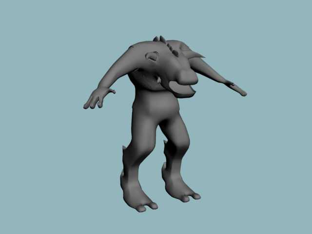

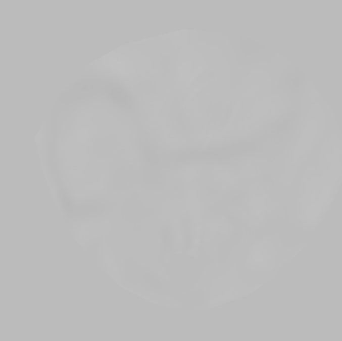

Hi
I have some good news and some bad news.
The good news is that, over the last week, since I last spoke to you, I’ve been working on the first of about 8 low-poly models with the new multi-displacement method, and the amount of detail I’m getting in zbrush is absolutely amazing.
The bad news is that I can’t get it to render properly.
I’m certain that I’ve got the max UV coordinates and ID’s sorted, I export into zbrush and model away creating polymeshes and also allowing for buffer zones.
I think the problem lies in creating the displacement maps and my render settings.
The images below show what happening, and I’ve been using the same process as I did with the sphere and it worked perfectly then.
Also I sometimes get an error message in max when trying to access a 32bit image thats created in zbrush using the multi-disp plugin, and also the maps created in zbrush I can hardly make out the detail?
Please could you help once more, if you want me to send you the max file I will…I don’t want you to fix the actual max file but just give me the help you’ve been giving me so far, cos it’s a great learning curve for me…I’ve learnt more in the last 6 months working on this showreel, than in the last 4 years…he he
Sonder!!!

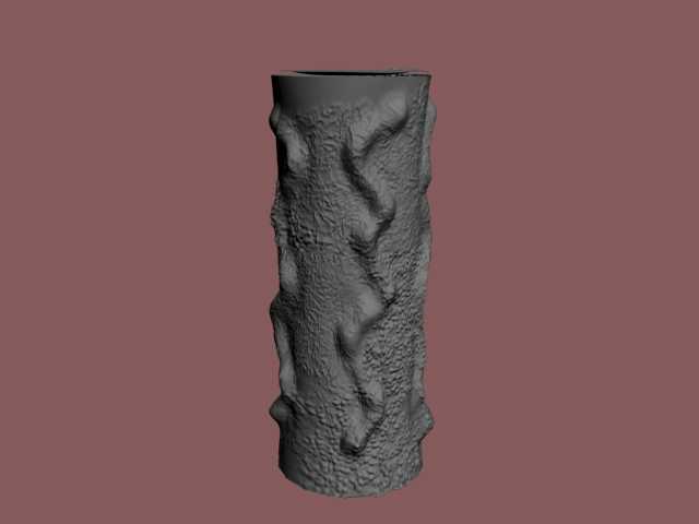

Just to let you know, I redid the exact same procedure on a cylinder and it worked (see below image), so it shows both of us that I know what I’m doing, but i just can’t figure out the abovw problem, in the mean time I will get on with another model.
Thx again
Sonder!
[attach=30036]test cylinder_all good.jpg[/attach]
