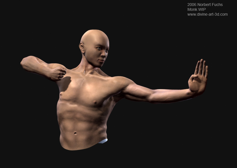

Shaolin Monk wip
I had several issues to solve…normal map seams, multi displacement and so on. So I changed render engine. The current render shows a multi displaced model, rendered in Vray. (no normal maps)
There are still texture seams but the maps aren’t the final ones (color tweaking, plus details needed).

A bigger one. This is a raw render. The only post is the copyright info.:lol:

And a little update. Some of the texture seams are fixed, began to model the clothes. Raw render.
[body_texturing005_big_f.jpg]
