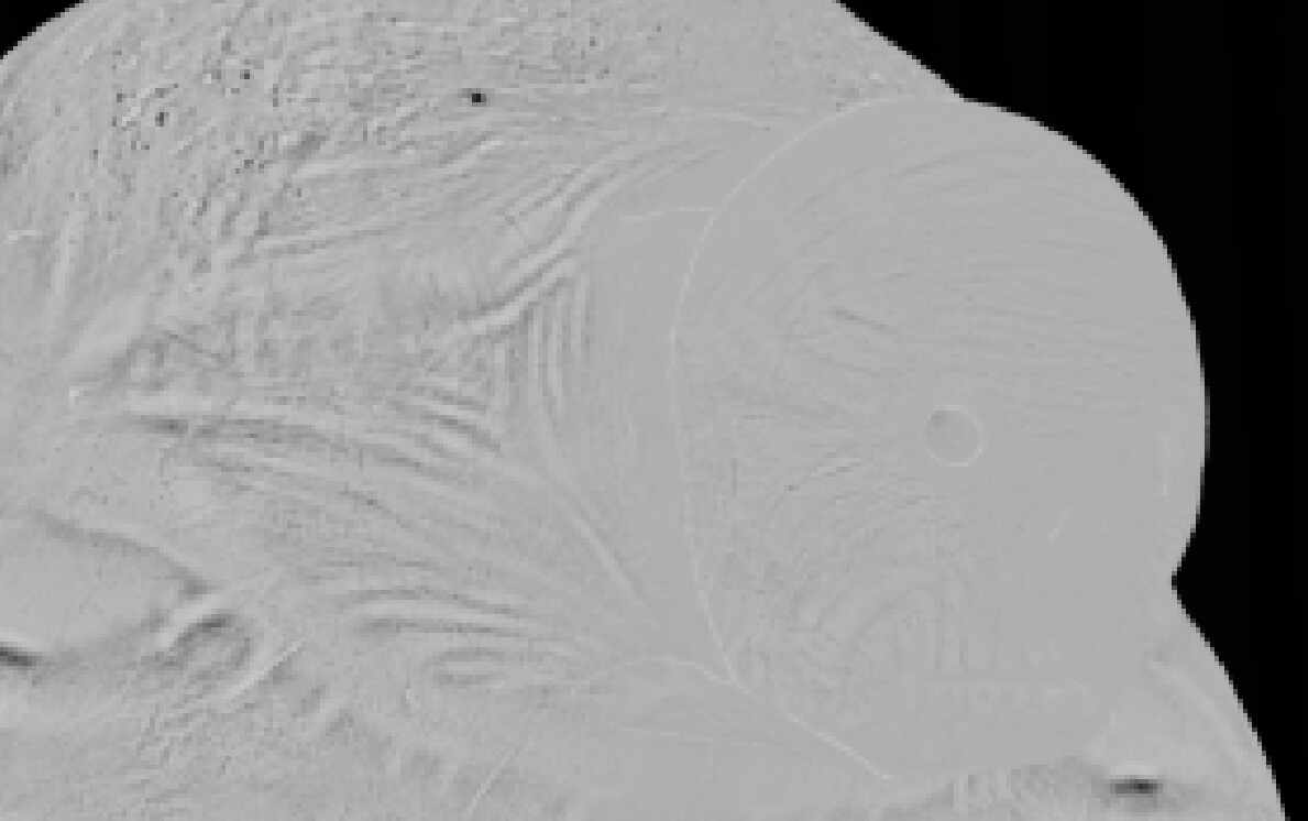

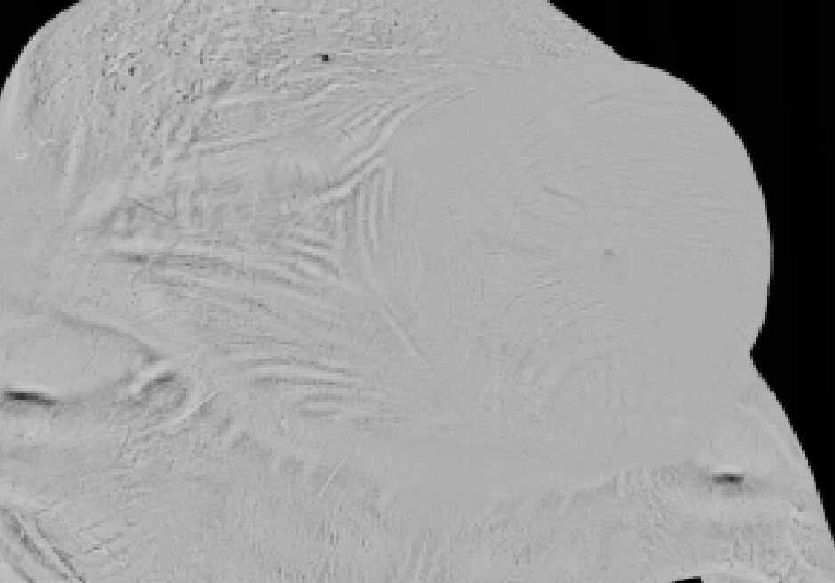

found the solution … the problem is the subdivision aproximation of maya.
if i bake the bump map on the base mesh = no seams
if i smoth the mesh with the polygons>smooth = no seams after aplying bump
BUT if i use the subdivision aproximation in aprox´editor i get seams no mater
what subdivision type i set even if i use parametric with value of 0 there will be seems.
so basically the broblem occurs when i try to use dicplace + bump for details
as for dicplace map i need that subdivision aproximation…
the point of disp + bump is that i never get the detail i want just using dipsp map. I didnt noticed the seam prob before as i was using hand worked uvs from maya and i only noticed the seams when zooming real close at an uv border.

Hey Busil,
Try setting the Filter Type to “OFF” in the texture’s File Attributes section.
I had the exact same problem as you and this fixed it. Now when I render with displacement and bump I get no visible UV edges.
Hope that helps.
