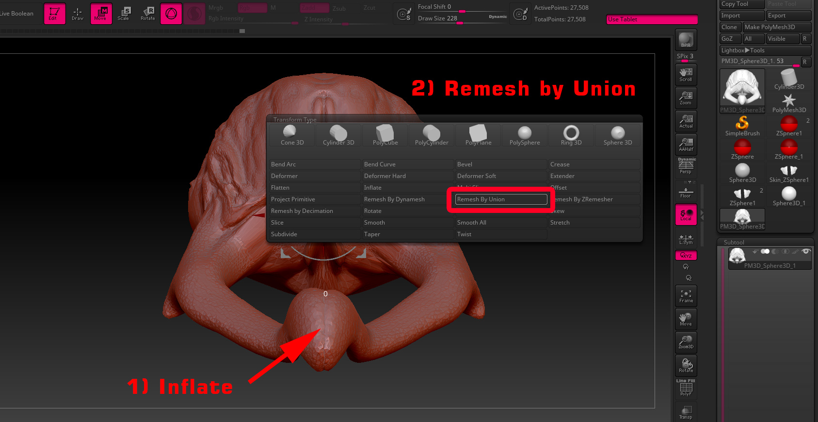

I’m loving these videos by the way. In the crab video when you smoothed the mesh to break off a piece of the model to create the limbs, it looks like you pieced portions of the limbs back together. Well, while I was testing out the Sculptris pro feature, I couldn’t get portions of separate objects to come back together to create one object. Is there something I’m missing or does Sculptris Pro allow you to bring 2 or more objects together to create 1 object piece that’s connected to each other? I hope my question makes sense…

@selahpoetic - I believe there is no way to combine back two pieces of geometry with Sculptris pro. With the crab, I separated the pieces for the legs and create polygroups (with autogroup) to be able to select and mask them quickly. However, if you need to combine a separated mesh into one, you can always use Dynamesh. I hope that helps.

Not sure about Sculptris Pro but In ZB2018 “Remesh by Union” blends two shapes together.
  1. Snakehook2 the mesh close to each other,
  2. then inflate untill they overlap
  3. enter gizmo> Customize (gear icon)
Thanks a lot!!
I 've tried end it is a fast, simple and… amazing technique!!!:+1:

sadicusNot sure about Sculptris Pro but In ZB2018 “Remesh by Union” blends two shapes together.
  4. “Remesh by Union”
I forgot that was mentioned in one of the streams I saw. Thanks for the reminder. I will have to try that as well.
