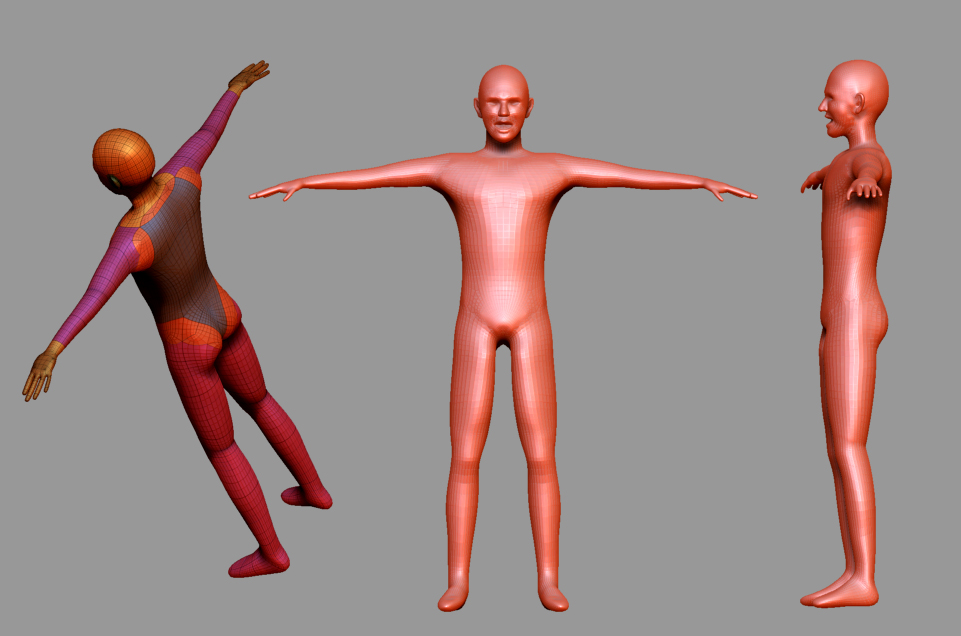

Hey, I’m interested in knowing how this was done.
yeah! retopology is the key to lots of stuff in zbrush.
i never did hands before… so ill have to try myself for the first time... but one things for sure: i`ll use retopo!! great tool!!
chem!
Good job!
Keep going buddy!
EDIT:
I AM VERY INTERESTED IN KNOWING HOW YOU DID THIS!!!
How did you avoid the holes in mesh, wich often happen while retoplogizing
thin objects like fingers?
Hi Slosh, I have been trying to work with Zspheres to make hands with five fingers but haven’t had much success with it. In fact ,there is a lot of discussion within ZBC over Zspheres and making hands using them. I haven’t been able to pull out five fingers( Zspheres ) out of one Zsphere ( palm ). the ZSphere which is a cube needs to have more quads on its side in order to add fingers to it without the mesh becoming jumbled up. There is a plugin designed specifically to adjust the polygon distribution on a ZSphere such that it allows branching into more Zspheres. How you have done this amazes me, unless you used some kind of plugin. I would be grateful if you could elaborate on your technique or post a zscript for a better understanding of the same. thanks and waiting.
Hi to everyone who responded to the hand business. To be honest, I’ve tried and tried to do hands in the past, with the same frustrating results as the rest of you. This was originally intended to be a unified skin that I was going to then retopologize. But the resulting number of polys and their distribution was daunting to me in the retopo (it’s hard to get between the fingers, etc.) So, just for the heck of it, I hit “adaptive skin” and made a few adjustments in the membrane and I-res settings, plus turned on MC (minimal skin to child). The result was a surprise and a happy accident.
Anyway, I will recreate this entire process with zscript recording. If it works out properly, I will post the script later today.
I’ve done this only a couple of times before, also happy accidents, on full body models (my Cruella Deville, for one), but couldn’t remember how. Anyway, I’ll give it a try. No plug-ins were used (although I know which one maverick is referring to). As for the fingertip holes in retopo, you will see in the script that I used the existing mesh in retopo and simply deleted and moved only a few key points. So the finger mesh was already present. Also, setting the “Max Strip Length” to 16 helps fill in the gaps.

OK, I decided that, since my original mesh was created 3 weeks ago, and I didn’t document steps, that I would make a new mesh. This one is not highly detailed because the body will be covered in clothing in each case. When I do Frankie, I will of course add more details because he will be scantily clad.
I modeled it with the mouth open because all the monsters will have their mouths open. Each one will get much further head modeling as needed for each monster. So, this is quite, quite basic right now. I’ve saved the zsphere model and the original adaptive skin, to be posted later.

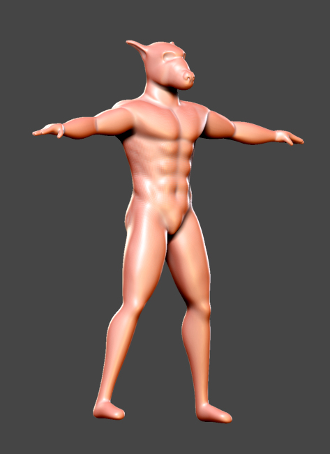

OK, I still am not sure if I will go with my original idea, or one of the other two. But I did start the wolfman today. Here is the main sculpt, more details to follow, but my arm is tired from mousing…
This was made from the same zsphere rig as my previous full model (not the one in the first image), except that I added some spheres in the arms and took out the nose, moving the chin upward for a snout. Anyway, this wolf might look good in the little girl tea-party/dress-up image. I might go for that one, I think. The rules didn’t say it has to occur at Halloween, just that a monster should be in a funny situation.
Please give me some feedback…should I change my entry to the tea party? I think 3 monsters and costumes might be too ambitious for me, especially since I have trouble recreating things once I’ve done them…most of the time I am operating on pure luck.
Also, any suggestions on this wolf would be appreciated. Thanks!!!
the wolf seems pretty ok but i cant really see it in this perspective. i also think u should give him some big lumps of muscles. theres a reason why the clothes burst apart in the transformation. waiting for more!
