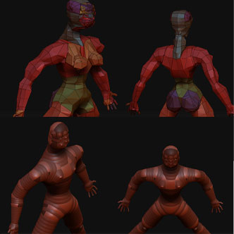

Well i definately dont like makeing you people doubt me so i put extra work into it.Rock-1_sheet-1.jpg
I may sometimes post alot and get ahead of myself with it but i can pull off stuff
fast as well,Even though its best to take time.
your reference is completely wrong. You should use real life reference.

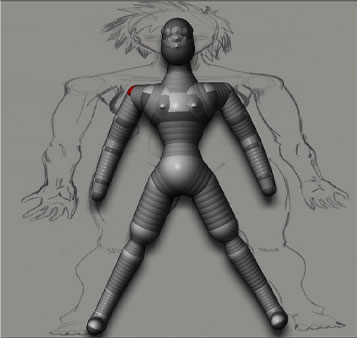

i think i’m beginning to see where the proportion issues are coming from in terms of width…

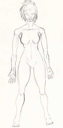

your initial sketch looks okay (but also needs alot of work) but when you put it as the background in zbrush its stretching it to a square and you’re matching it…
this also highlights another issue…if you’re unable to recognise that its doing this and you continue to work on it thinking its correct, i worry that you don’t have enough ability to carry on with a career in 3d…
not trying to be harsh…but really…you should be able to pick up on something as simple as that…

I did recognize the problem with the with on that image,i was just showing some of what was asked of me i dont exactly know how to put the image in any other way at the time i tried a few ways only one worked.I would like to know how do you place it on a plane.When i put the 2d image in i imported it so it just remaind in the backgound.
Something came to mind i look at my model and it may be off but it comes close,if the erors are their its nothing that cant be fixed.I will work on it some
more,maybe it wont take as long as some may think.

what you need to do to get the image in the background in the right proportions is this:
1-to go up to the texture menu and import your texture (your ref image in this case)
2- select the flat color material
3- go back to the texture menu and at the bottom of that palette there should be a button that says “cropandfill”…thats the one you want to click…
what it will do is resize the document to be the right size for your picture and put it as the background
if the document is too small go into the document menu and click the ‘double’ button until it’s big enough…
now you should have your ref image the way it should look and you can go from there…

if you still can’t tell how bad your works are compare to the other people, then you should seriously think about your place in the 3d industry because you don’t seem to have the ability to tell what is bad and good…
your works are the same since you post your first model, and you had been igoring other’s critics from the begining… judging from what you have post, you don’t even seem to have the ability to tell what is a square from a sphere… Look at the heads you post, you can’t even nail down the most basic shape of a human head, which is just a simple sphere…
then look at how you build your base mesh from your reference, you don’t even seem to be bother by the fact that your reference was stretched badly in zbrush, and continue to build your mesh from it… Yes, you may not know how to resize your reference to the correct size, but that isn’t a good excuse for you to build your model base on that error…
