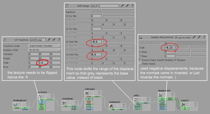

Hello,Kostas Mavrommatis student from greece,new to z-brush.Trouble rendering with softimage|xsi,just cant get the detail from z-brush when rendering displacement in xsi,any tips please?
Hello!My name is Kostas Mavromatis,student from greece,new to z-brush,terrific thread rray,would you have an xsi rendertree detailed example?i just seem to do something wrong!!!thanx in advance

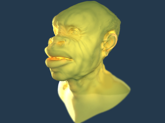

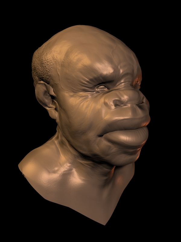

Hi Everyone. This was a quickish test done with the new Rio version of Brazil RS for Max 6. Having problems with the hair and high frequency detail in the flesh although I canât tell so far if people are using bumps for that. Sorry the pic isnât a bit bigger but those are the limitations of the demo.
If anyone is still reading this thread and wants to see an extreme close up then reply and Iâll upload one with all the stats etc.

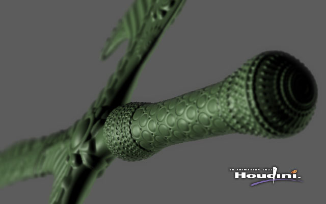

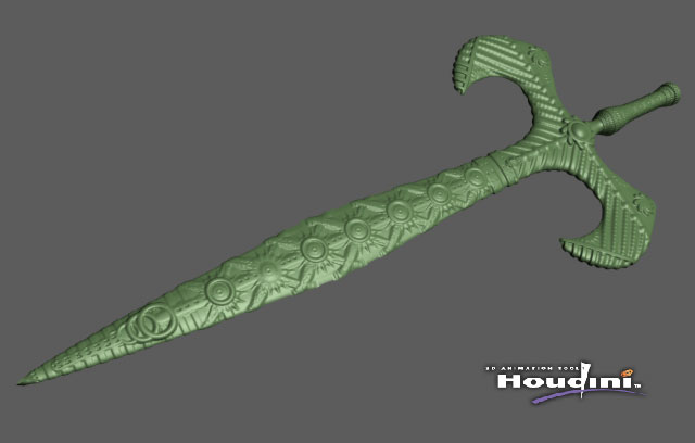

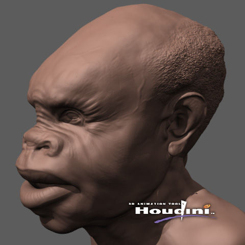

Houdini Apprentice 6
Import obj file. As one previous Houdini user pointed out, the file extension must be in lower case so rename it from OBJ to obj.
Scale the model down to about 1/100th of itâs original size to avoid shadow bias problems.
Apply the shader and set the model to âRender As Subdivison Surfacesâ in the object render parameters. You can also set the displace boound and turn up the shading quality if desired.

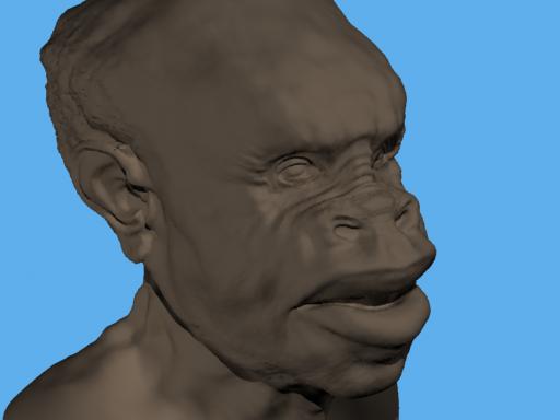

Photoshop
I opend the texture file in Photoshop - under image i used Auto contrast to bring the value to black and white
change the mode to RGB and save as to a new texture file
now you have the option to flip it or do it in maya , I just done it in maya
Maya
import the Obj
Rotate it 90 on the X
in the hyper shader apply a new texture and use the displacment mamp that you just created (the RGB one MR will give an error if you use the orginal one)
in the color balance of the texture file I used the following
Alpha gain 1.670
Alpha offset -0.865
As for the object
get the Att Editor and under displacment map
turn of feature displacment
and under tesselation make it 4
i took it a littel bet further and used SSS shader and htats what i got

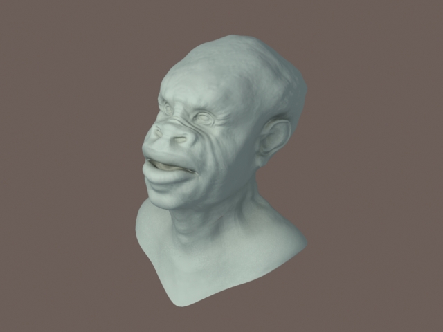

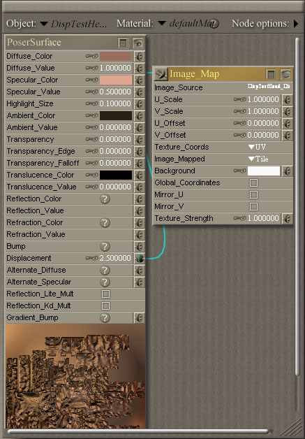

Hi guys, I just learnt about the wonders of Displacement and Normal mapping from the Unreal Engine 3 demos. So Iâm thrilled to learn ZBrush might be able to give me these effects shoould I ever start an Unreal 3 Mod. I also have Poser 5 and I want to eventually sell poser stuff online, so I thought Iâd strat there.
Hereâs my Poser 5 renderâŚ
Here are the settings I used in PoserâŚ
Now I tweaked the map in Photoshop - inverted its colour, flipped it vertically and upped the contrast to about 75%. Hope this gives a good starting point for other Poser artists trying to make this work.
I donât like the guyâs ears in my render⌠And thereâs just a smidge of banding creeping in on his shoulder. Canât wait to see how this looks with a texture as well as displacement.

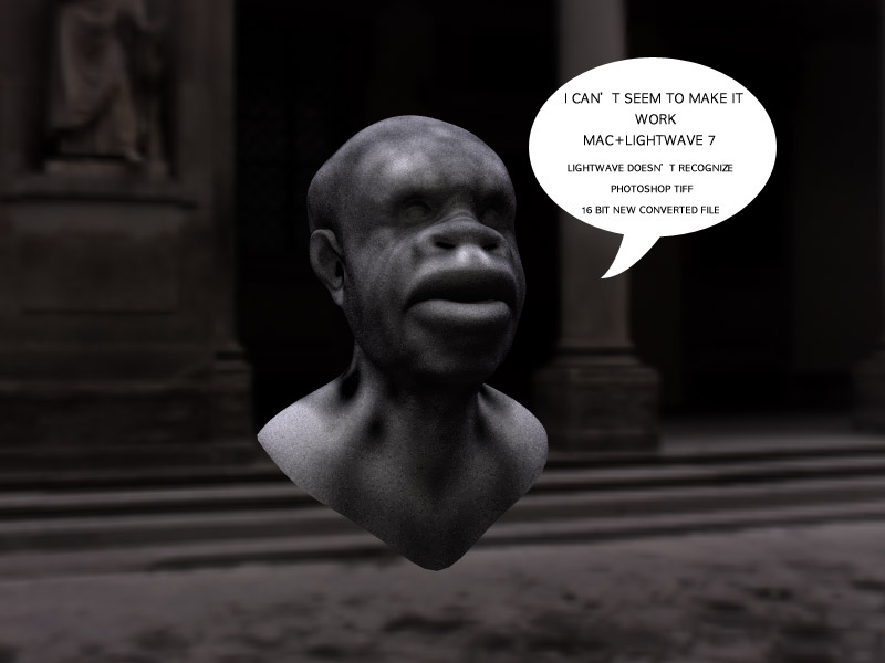

Now the question , I flipped verticaly the image in photoshop and saved it as a 16 bit grayscale tif , but lightwave canât open the new file from photoshop , any suggestions? I also convert it to rgb and had no results, I used it as a bmp but the displacement only makes the image bigger or smallerâŚ
Ruy

This image is the frustrating result. Had to smooth it in lightwave modeler and apply the shadows as a texture. Lightwaveâs manual on displacement textures only covers half a page from a total of a thousand pages all over the book , and even in that case it doesnât has a tutorial on how to use it accurately . Iâve revied the lightwave posts and tried them all.
Sorry , maybe I need an upgrade or something .
