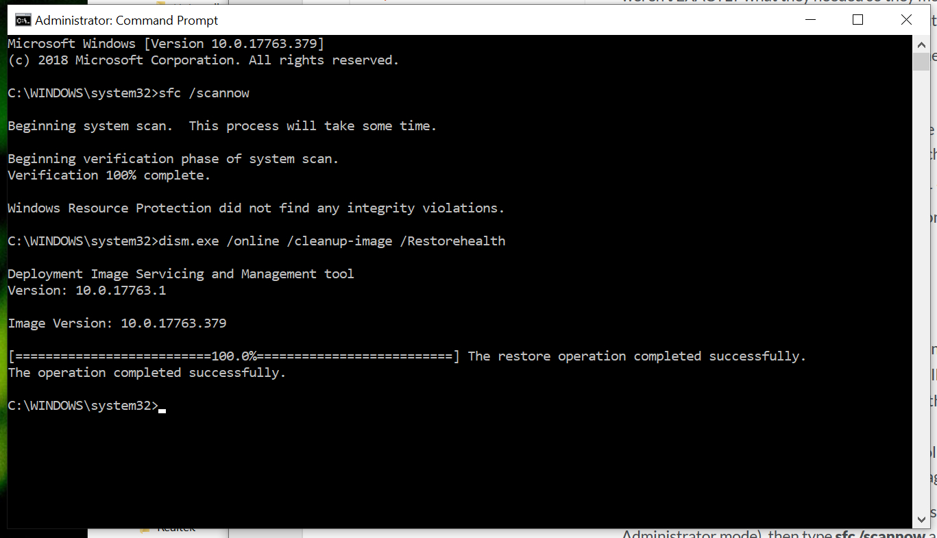

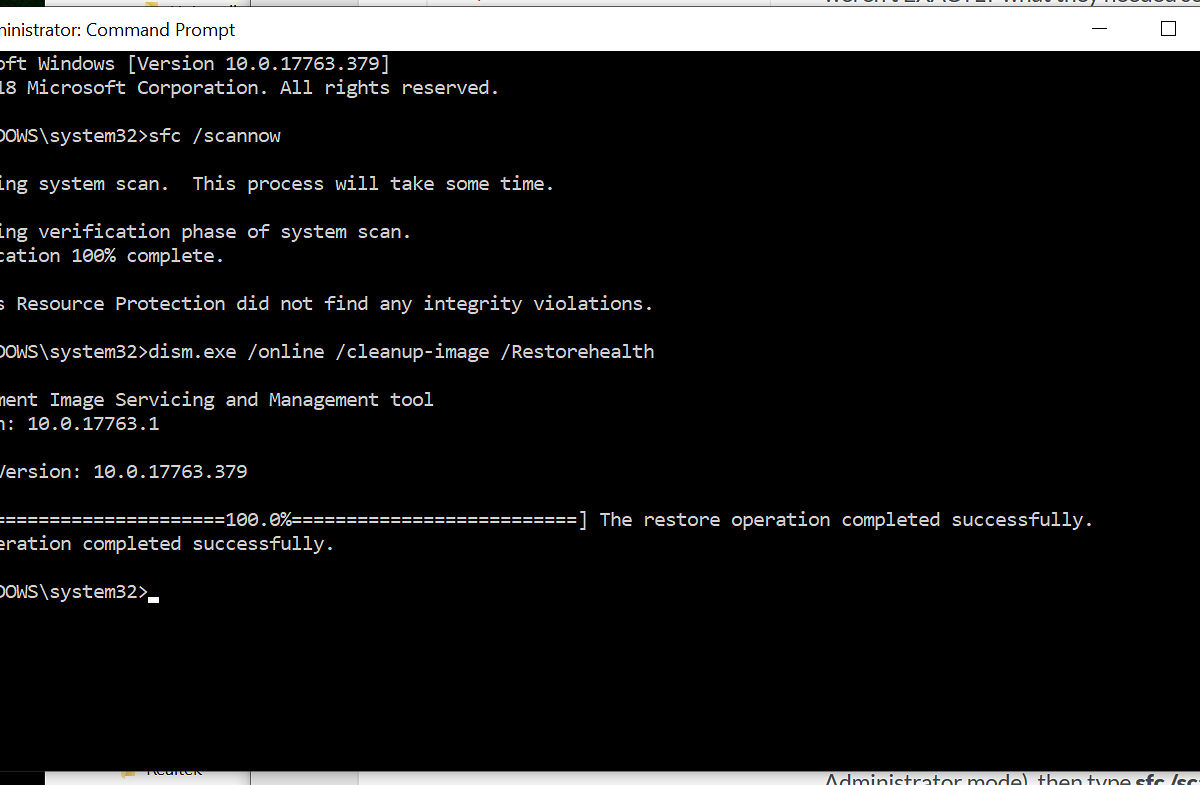

[FONT=Verdana,Arial,Tahoma,Calibri,Geneva,sans-serif]Getting hit with the
[COLOR=#ff0000][FONT=Verdana,Arial,Tahoma,Calibri,Geneva,sans-serif]Application has failed to start because its side-by-side configuration [FONT=Verdana,Arial,Tahoma,Calibri,Geneva,sans-serif]error on a Surface Pro 4 with vigilantly updated Win 10. Pretty much bought & use this thing for ZBrush so there's no contorted Pandora's nest of malware or third party virus checkers. [FONT=Verdana,Arial,Tahoma,Calibri,Geneva,sans-serif]As an obedient user, I followed Pixologic's upgrade instructions of running the Pixologic Deactivation Manager in my 2018 folder to immediately get hit with the warning [FONT=Verdana,Arial,Tahoma,Calibri,Geneva,sans-serif]![PixDeactManager.jpg|858x310](upload://bd0NPRx5kYOOMwk4SlOQ3NZEfBL.jpeg)
This brings us to the Pixo Knowledge Base to troubleshoot the issue. Repair all my VisualC++ libraries? OK. Reboot. Same error. Wipe and reinstall those libraries? Um, OK. Reboot. Same error. Moving down the list, I’m instructed to run scans from the command prompt.
Reboot. Error about not being able to login to Win 10 with Windows Hello. Fantastic. Run Deactivation Manager. No dice. No difference if I tried to run this as administrator.
[FONT=Verdana,Arial,Tahoma,Calibri,Geneva,sans-serif]All these hoops I've jumped through and now the Knowlege Base suggests I now wipe my entire drive as last measure??? [FONT=Verdana,Arial,Tahoma,Calibri,Geneva,sans-serif]I've read through 9 pages in this support thread and have yet to see if I'm just allowed to wipe out ZB2018, deactivate the license from the Pixo Store, install ZB2019 and enter the license. Moving forward for future ZBrush releases, can we do it THIS way in lieu of messing around with a problematic (for some of us) Deactivation Manager?

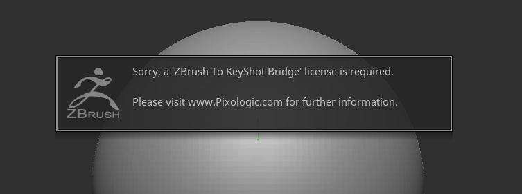

I installed Zbrush 2019 and activated it with the offline activation because I’ve the login loop issue. I can’t activate my Zbrush to keyshot bridge for the same problem (login loop). When I try the offline activation procedure the system say: Sorry, Zbrush to keyshot bridge license is required. But I’ve it.
For the login loop:
  1. Make sure that your antivirus software isn’t blocking cookies.
  2. Make sure that you’re using Microsoft Edge or Google Chrome on Windows, or Safari on Mac.
  3. Try clearing your browser cache.
  4. Also make sure that your Pixologic ID only has one email address on it. That email address must be the one that your license is under. You can edit your Pixologic ID by logging in at https://support.pixologic.com and then clicking the Pixologic ID button.
If you still have trouble, please submit a Support ticket.
Problem solved, thanks. I managed to install with the offline activation. My login loop remains even after all the operations you suggest.Cattura.JPG
