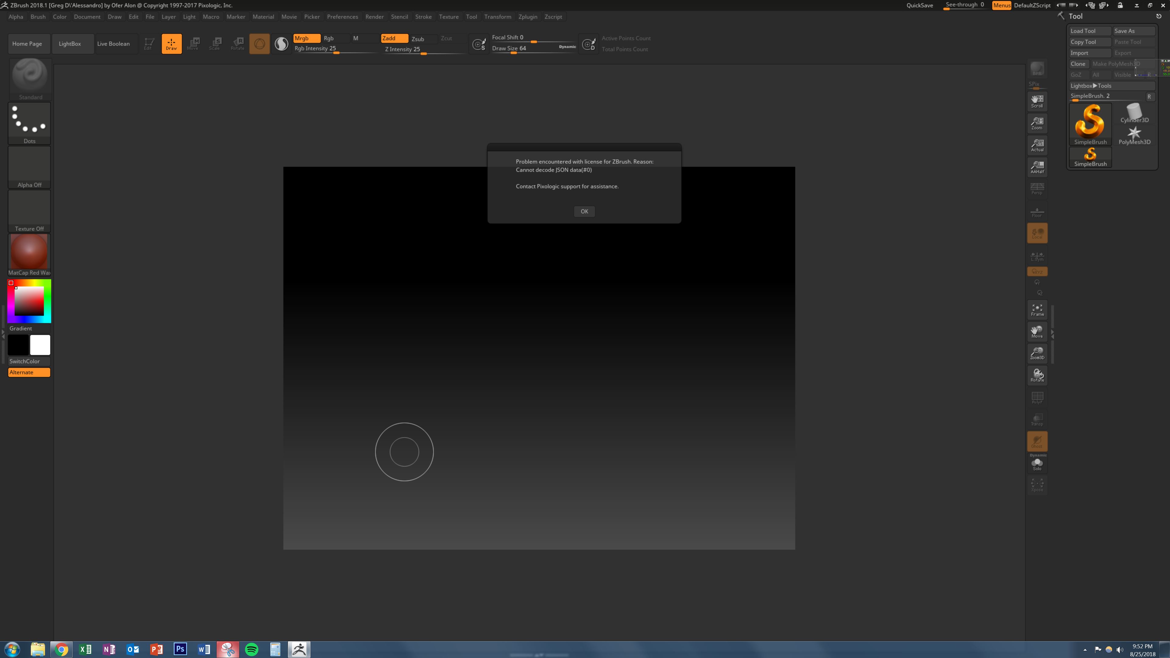

I updated to Zbrush 2018, and then had to update my wacom tablet driver (which required a restart).
After the restart, when I open Zbrush 2018 from my desktop I immediately receive this error message and then crash to desktop:
Problem encountered with license for ZBrush. Reason:
Cannot decode JSON data(#0)
Contact Pixologic support for assistance.
Is there anything I can do to fix this? Thank you.
Just do a clean uninstall.
Delete all the folders that are left.
C:\Users\Public\Pixologic
C:\Users\Public\Documents\ZBrushData
C:\Users\Public\Documents\ZBrushData2018
Then install and upgrade to 2018.1
Then make the changes I shared with you above
I just uninstalled everything, deleted all folders, and then reinstalled, but I still am getting that message immediately.
I was hoping the clean install could help but have to contact support to see whatās causing the licensing error.

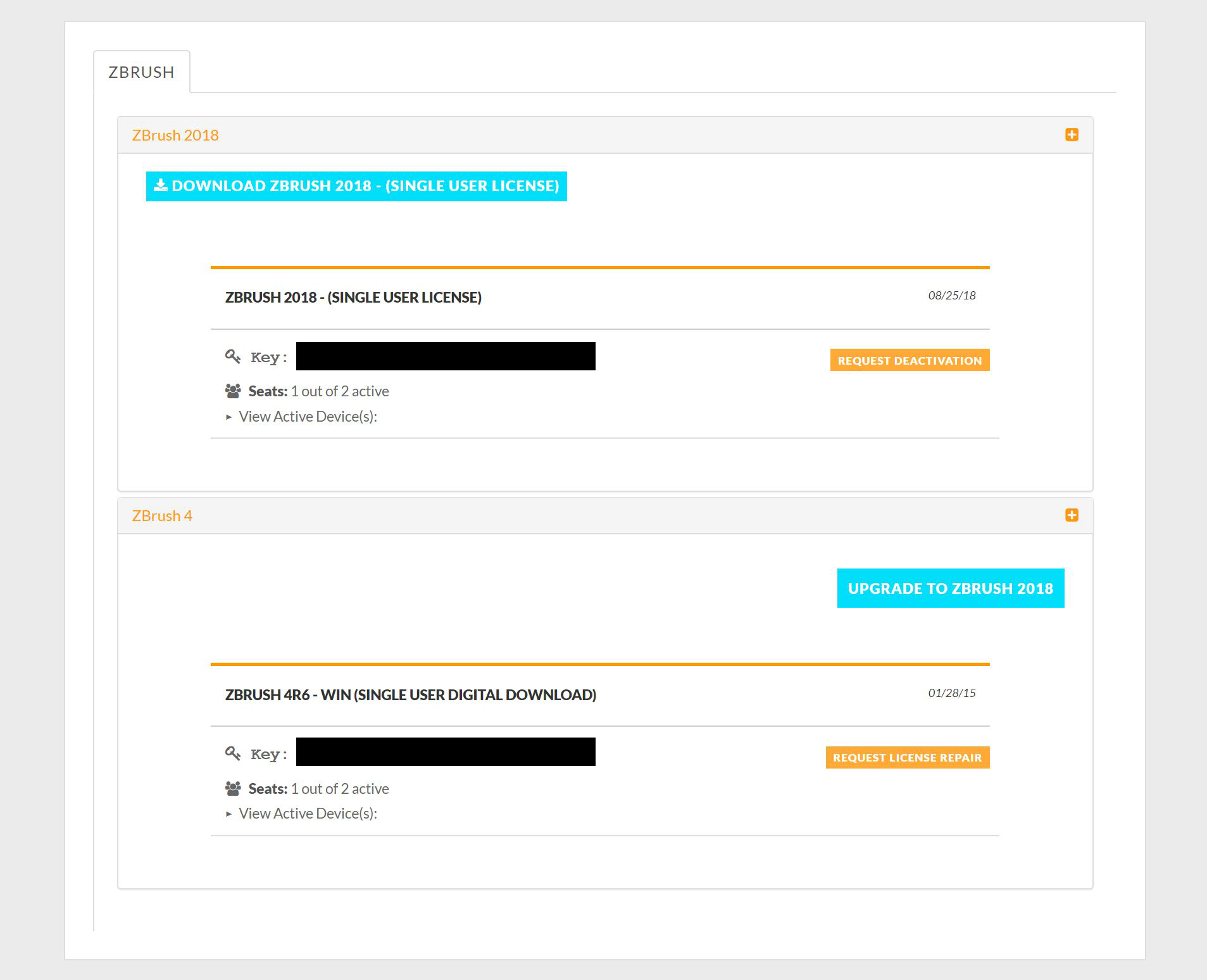

You can see if youāve exceeded the amount of licensing connections here:
https://pixologic.com/my-licenses/login.php
You can contact support and create a ticket here:
https://support.pixologic.com/Tickets/Submit
If you select āURGENTā they are usually pretty prompt with helping

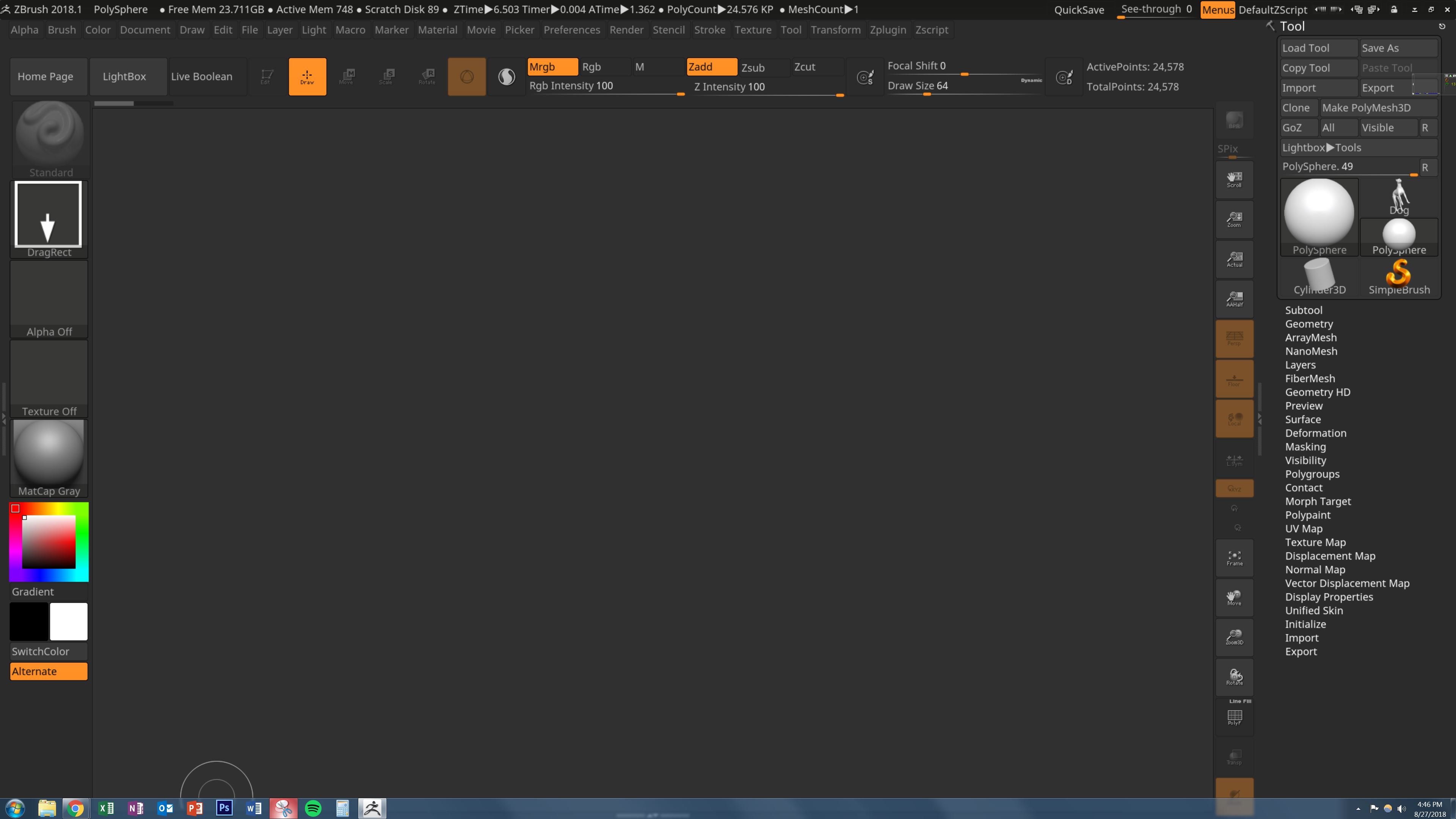

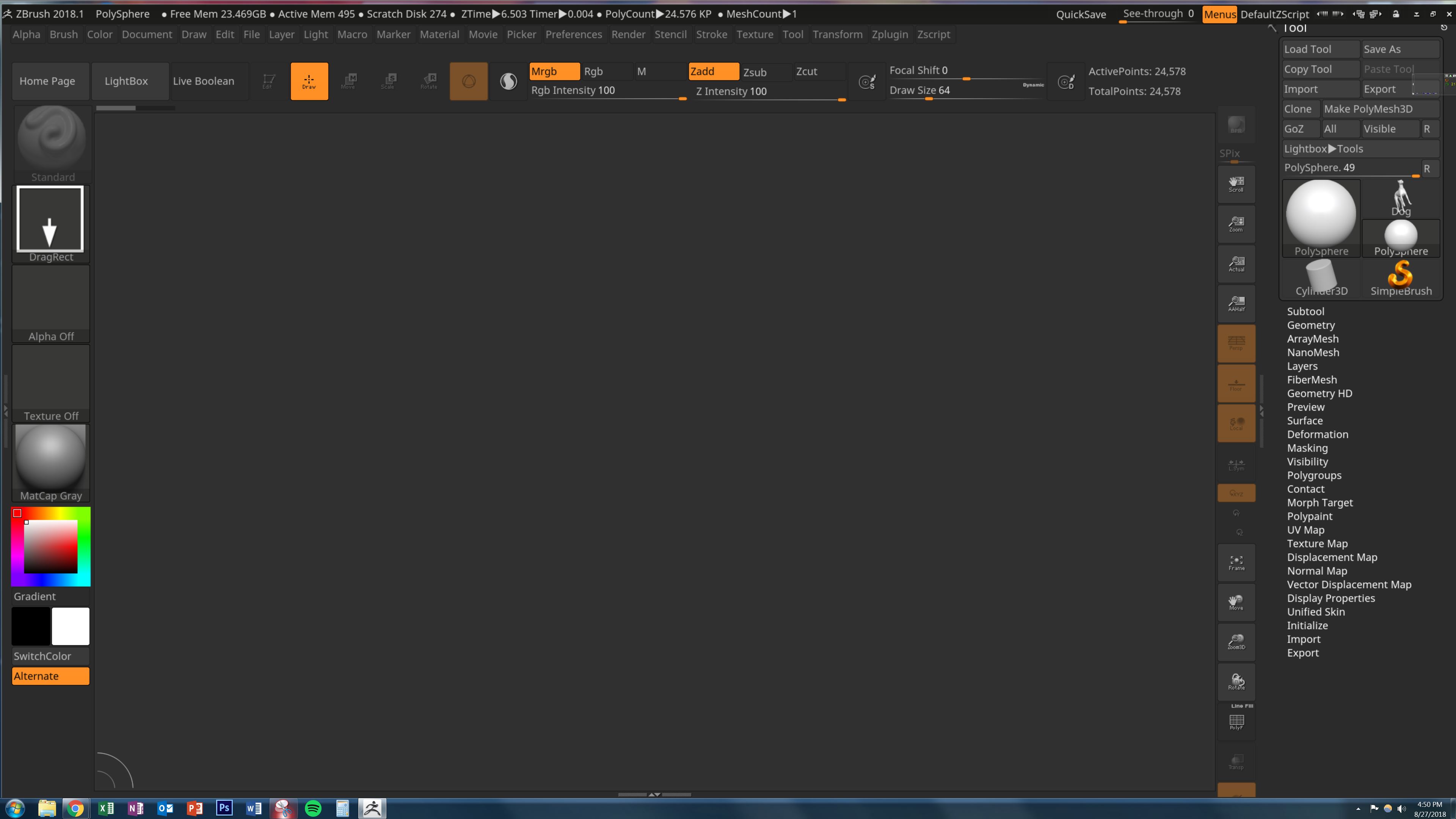

Is it possible to be in full screen mode and have the window stop right above the taskbar? (currently the taskbar overlays in front of ZBrush. I also donāt want to hide the taskbar/have it dynamically appear/hide. Thank you.
Even in Windowed mode the menus on the right hand side are cut off. Is it possible to not have them do that?
Only way, so far, that Iāve found to do that is to use the Maximize button to put the UI into resizable mode and then just drag the corners out but the program doesnāt remember that upon being restarted. Yea itās been an annoyance for me too all these years! You KIND OF get used to it but not really! LOL
Hi Yourname942,
You can resize the ZBrush window by setting the Document>Width and Document>Height sliders to the size you want and then pressing Document>Resize while holding the ALT key.
Attached is a macro that makes the process easy and you can assign a hotkey to the button if you want. ***You may need to adjust the values in the macro so the Document height and width are set to what you want (open the file in Notepad)***.
Save the file to the ZBrush 2018\ZStartup\Macros\Misc folder and press Macro>Reload All Macros. The button will then appear in the Macro>Macros>Misc sub-palette.
Show_Taskbar.TXT (288 Bytes)
HTH,Show_Taskbar.TXT (288 Bytes)

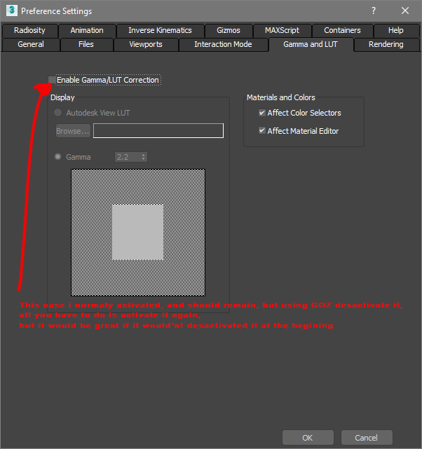

Hello guys,
I noticed a new probleme using GOZ, iām using 3dsmax and Zbrush, with GOZ to switch from one to the other, i have been using it since day one of GOZ, so itās been a long time.
Iām using zbrush 2018.1 and 3dsmax 2017 P3.
My problem is that when i use GOZ from 3dsmax to Zbrush, or Zbrush to 3DSMax, it seems to disable the gamma correction inside 3dsmax. Itās a new thing, that i have never experienced before, so i donāt know if itās because of 3dsmax 2017P3 or Zbrush 2018.1, but i was wondering if anybody noticed it, and if you at pixologic are aware about this.
A nice thing that i noticed, is that GOZ doesnāt switch 3dsmax to scanline anymore, iām a Vray user, and itās been years since i have been waiting for this change, so thank you !
