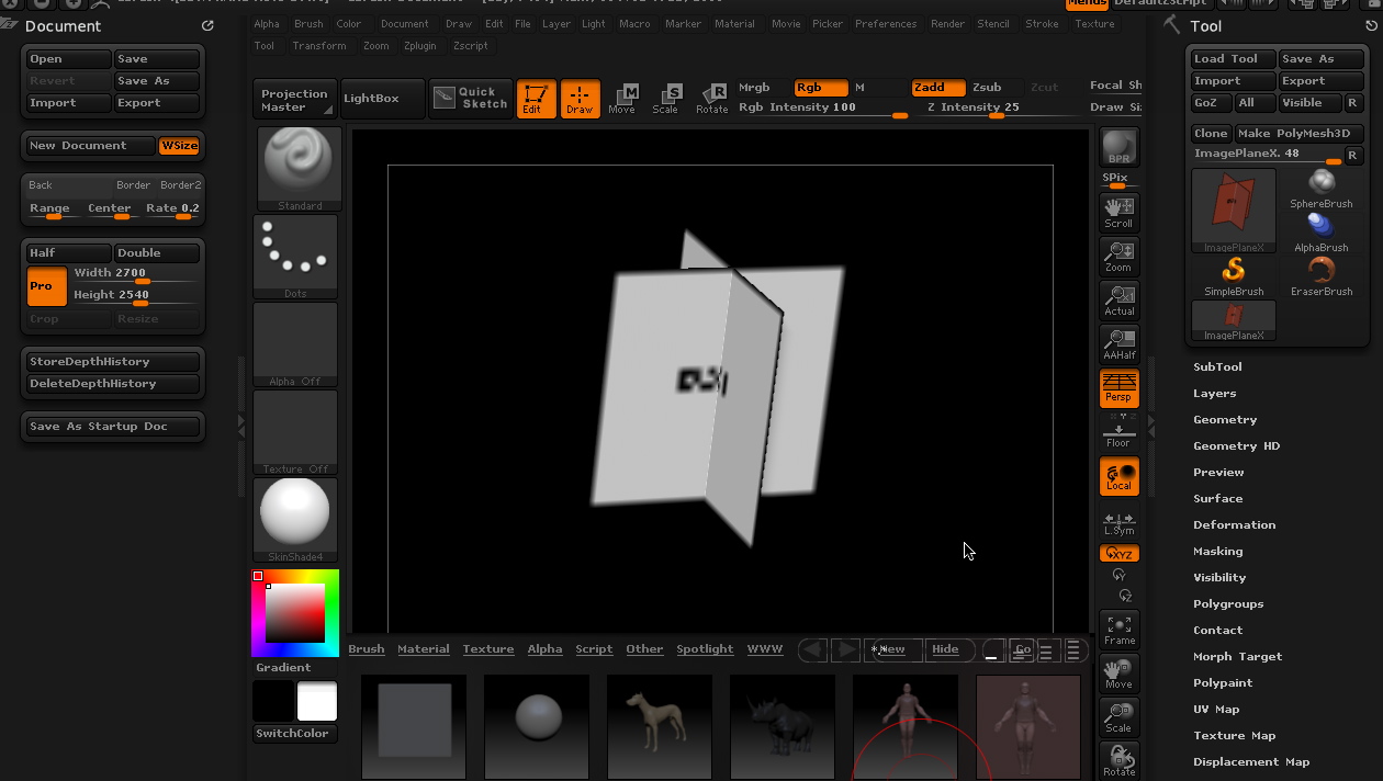

Im having a problem texturing my imageplane tool with the front/side imageplane texture. This is what im doing
in Edit mode with the imageplane tool on the canvas Im changing the material to skinshade 4. Then i change the texture to the imageplane (front/side) texture but nothing happens. So i go to the color menu and hit fill layer and get the result below, very soft pixelated text. Any help for this newbie would be appreciated.
The Image Plane you are using is different than the ImagePlane4 Plugin.
Similar name, but different Tools.
Apologies Sadicus - thanks for pointing that out - ill repost in another thread.

Please correct me if I’m wrong Marcus but when using Image Plane X (like StephenMurphy is) you need to divide the Image Plane X a few times (several times?) so that the geometry of the Image Plane is dense enough to display the image accurately. If you don’t you get that soft and pixelated image like he has displayed in the above picture. Divide the ImagePlane to about a million polys, then add your reference picture. Does that sound right?
Thanks
