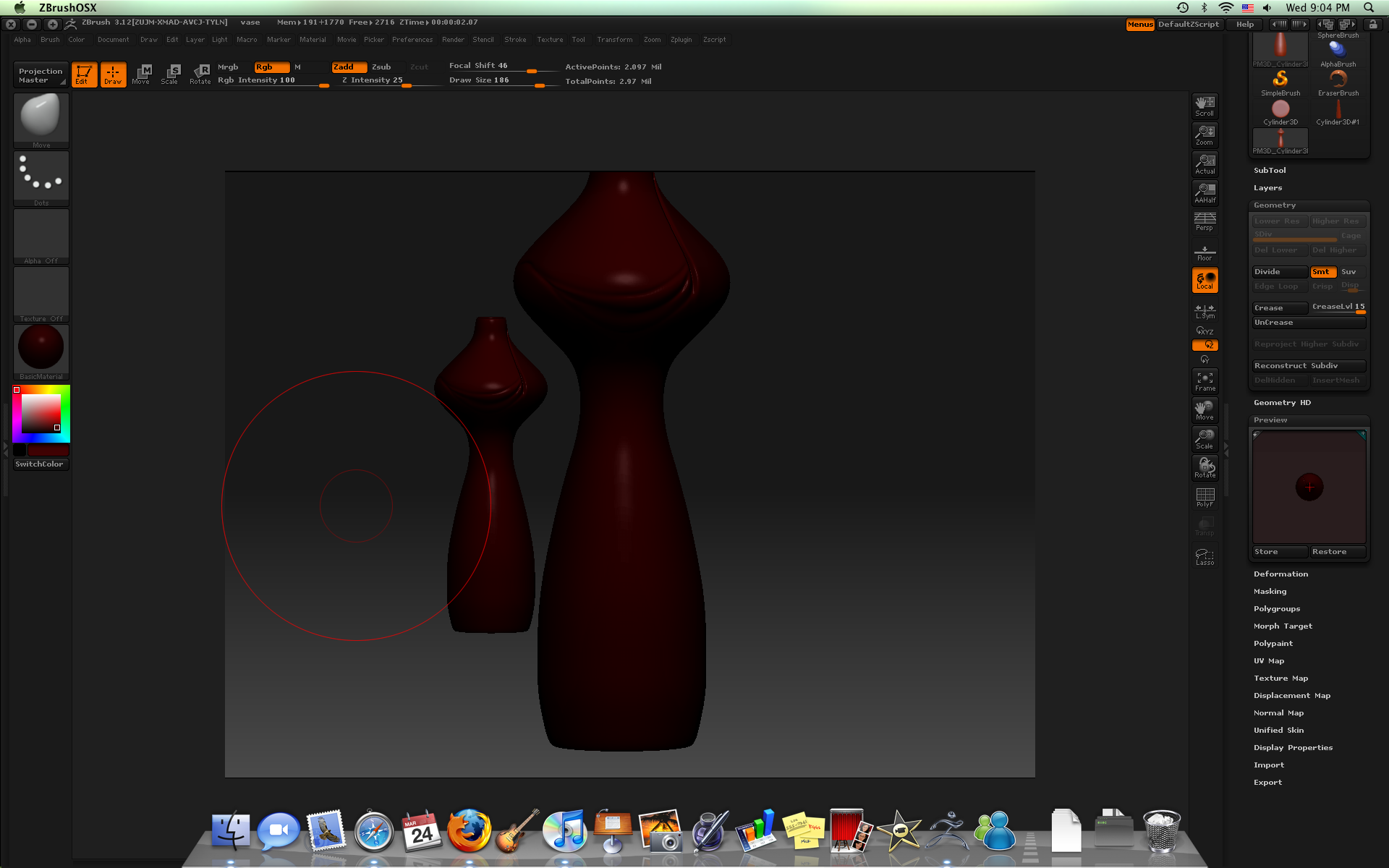

I was in Zbrush 3.12 for OSX, sculpting a vase when I randomly decided to save both tool and document in case of a crash (I had one just recently). Then, I continued sculpting. After a couple minutes, I realized that a duplicate image had been made when I saved. The vase I was sculpting was in Edit Mode but the one underneath it (but still on the same layer) was just there. I could not move it, sculpt it, or anything. It was like a ghost image of the vase right before I saved it. Any ideas on how to fix this?
I tried undoing a couple times but that just led to both vases disappearing and Zbrush crashing and relaunching. What is going on? I just lost a whole day’s worth of work. <img src=“http://www.zbrushcentral.com/pixo/atn.gif”><img src=“http://www.zbrushcentral.com/pixo/atn.gif”>

Could it be that you have a “snapshot” of your vase visible in the back? I can’t see any image in your post, so I don’t know what it looks like… If you press “Shift + S” then you will create a snapshot that is frozen in the back of your editable tool and to get rid of it press “Cmd + N” on mac (try Ctrl+N on PC). Not sure if this is the problem, but just a thought.
// tennet
It sounds like you created a snapshot. You can do this intentionally by holding ‘shift s’, then to clear the canvas of the snapshot ‘control n’. Why are you using 3.12? Download the updated 3.2. It is much better, less bugs, less crashes.

Thanks for all the advice. I can’t push control+n because that’ll clear the vase I’m sculpting as well as the ghost image. I have no idea what backface masking is. o__o
I deleted all lower subdivisions when I upped the resolution and I’m at above 2mil pixels right now. It just happened to me again. I saved the document and this is what happened. The smaller vase is sculpt-able and movable and all that. The larger one is just dead center, unmovable, can’t touch it.

Clear your canvas with Ctrl+N and then just draw your vase back on the canvas and press Edit. Your tool will be exactly how it was when you cleared the document.
Richard

  1. Download 3.2. There is no reason to use zbrush 3.12.
  2. Are you using the 2.5 tools? Or are you simply creating a vase? If you are not using the 2.5 tools (and making 2d artwork of some kind), you do no need to save the document at all, you only need save the ztool.
  3. When you are in edit mode (working the ztool of a vase) hitting control/command + n will not clear the ztool. It only clears the document behind the ztool.
And lastly, I keep telling you to upgrade (free) to 3.2 because 3.12 has various bugs that have been fixed in 3.2. Some of the bugs are directly related to the document.

Thanks for the advice. I command+n’d the canvas and cleared it. Then I drew in the tool again. Yay~!
