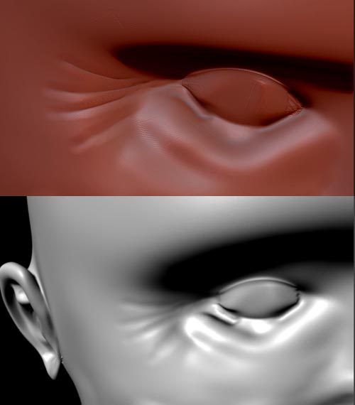

How does everyone get the sharp grooves and wrinkles in their Maya renders. Here I’m using texture, displacement, and normal maps for these test wrinkles with the Pinch brush. They’re ok in the ZB obj, but rounded out and lacking definition in the Maya render. I’m up to 6 levels of resolution in ZB. If I go much deeper with the Pinch brush, I start getting tearing around the wrinkles which also show up in the Maya render.

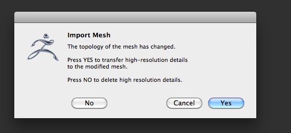

I’ve been getting this a lot when I import .objs. Any reason why and should I be concerned?
This will not happen if you currently have a ztool open that has ONE subdivion level (just as your .obj does), and then you click ‘import’.
This will happen everytime you currently have a ztool open and it has a few subdivision levels. The mesh you are trying to import has one subdivision level. Zbrush wants to know if you are trying to give your old ztool a new topology, defined by the import. Meaning it will divide the .OBJ three times (or however many subdivision levels your previous ztool has) and then project the details of your previous ztool onto the newly divided .OBJ import.
Just say no. Or say yes and see what happens.
thanks bLawless…it’s weird though, because it happens even with the most basic of OBJ files. I just tested it by making a simple cube in Silo and bringing the OBJ into ZB and it asked the same question. in fact, it happens with OBJs no matter what is going on. The model doesn’t really seem to change either way, so it’s not a huge issue. I was just curious to see if something is going on “under the hood” that I should be aware of, that would cause troubles.

You might have to resculpt some of the detail…Use less pinching and smooth a lot… When I have this it also shows in your lowest res level…there you can see that polys have been pinched too much… You can see these errors really well with the Fast Shader and polyframe on…

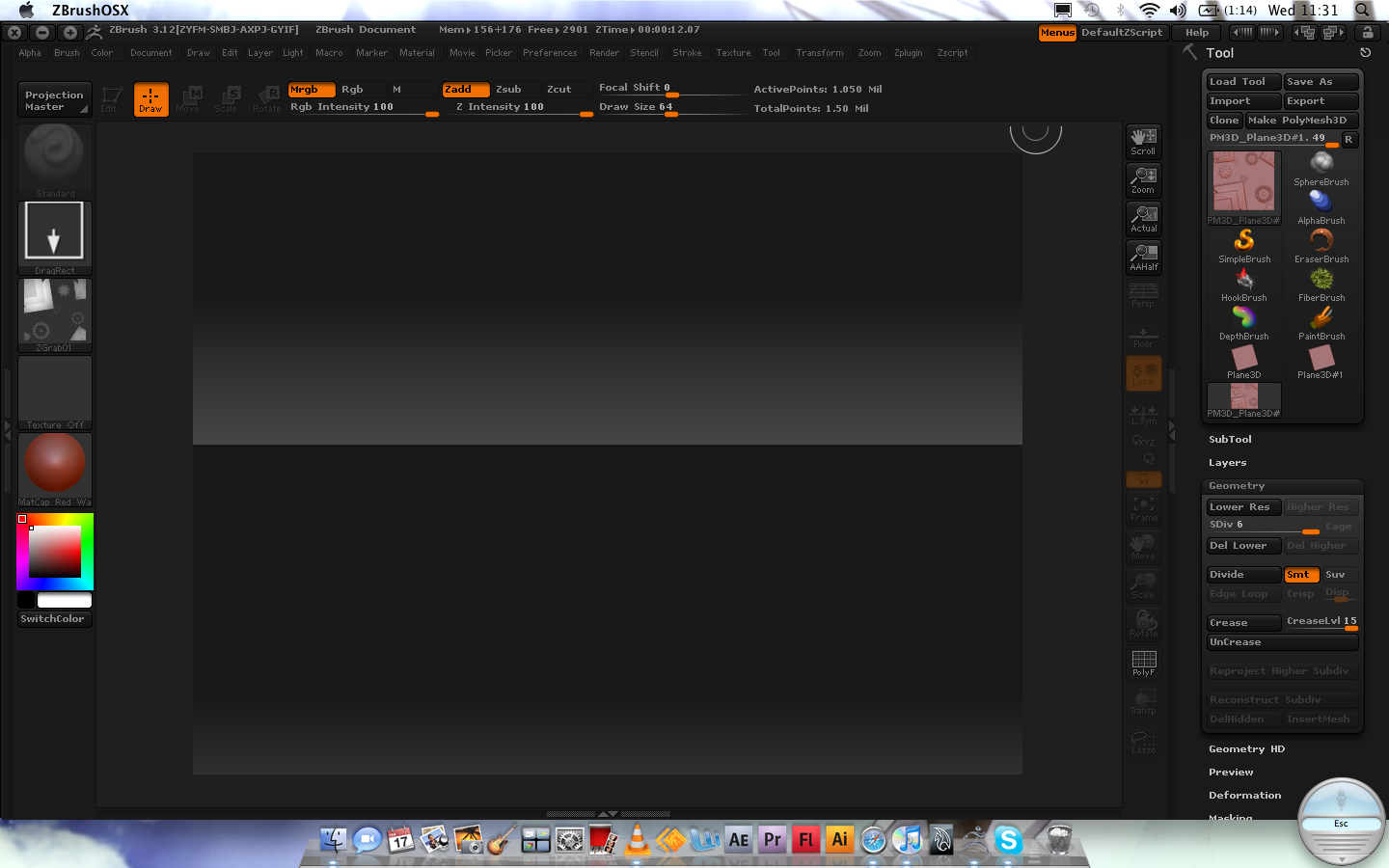

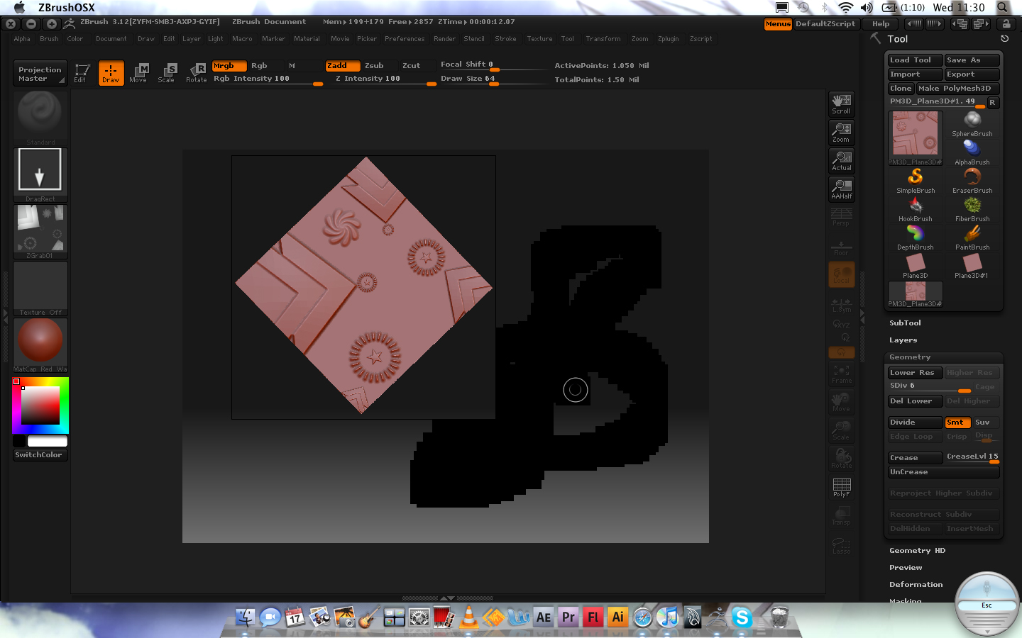

When I Chose Document Then Pro To Enter In my Proportions Of 2048 x 2048 and I Select Resize and The New Document Comes Up… How Can i Say This… When i Drag out a Primitive Onto It, It Goes All Distorted like.(ill upload pictures)
Its Hard To Explain What Happens But The Document Goes All Funny… Help ?
