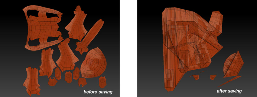

Happening here, too. Very nerve-wracking, can’t trust saving anymore…

Argh, I think that explains what just happened here as well (UVs corrupted upon saving), but will test to verify. I really hope someone from Pixologic can provide some kind of workaround for this, as right now it seems like a pretty severe issue.

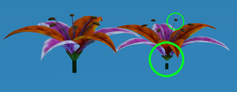

I’m running into a few issues on importing objects into zb4R3.
First, the objects are being stripped of materials, and everything becomes “default mat”. Is there a way to import and retain material groups? (The surfaces were done in lightwave, and poser pro sees them fine.)
Second, (and more troubling) the imported obj file is being mangled by zbrush. is there an alternate way to import objects without this occurring?
Here’s an example: A simple lilly modelled to use micromesh on. On the right is how it was modelled, and how it looks in lightwave and poser. On the right, is what happened when I imported it into zbrush, and then just exported it back out.
(Note the detachment of the flower parts, and the shorter stem, as well as lower petal issues.)
I created a separate post hoping someone has a fix for these issues, but am echoing it here so the developers see it.
With these issues, using ZB with other apps becomes problematic. I need the material groups to be retained, and the meshs not to be mangled on import.
(The mesh does not have closed holes in the stem… its open ended, and the petals are just flat planes, not 3d modelled with thickness.)
I found a workaround for the mesh deformation… zbrush needs to have closed meshes on 3d modelled objects. As long as you don’t subdivide the mesh, it’ll leave em undeformed.
Still no idea how to retain surface groups. There was an old poser import zplugin that I think retained them, but I don’t think it works on the latest version.
I’m surprised that surface groups aren’t just imported and converted to polygroups, or that there is at least an option for this.
The only workaround I can think of is break a mesh apart into seperate surfaced objs, and import each seperately, and assign each its own polygroup, and then merge the result.
For a mesh with a number of material groups though, that’ll be a chore.

The first problem you mentioned I have seen too, things look ok till you subdivide them, but I think this is a mater of how the object was created, I found that things made with procedural things that simply add polygons almost like separate objects and this includes a lot of plant and tree generators do this constantly.
I have no idea how to fix it
Remeshing, dynamesh and mesh extract didn’t do the trick and in fact made things worse (and sometimes very cool).
Using Close Holes and Check and Fix Mesh didn’t help either. I even tried using decimation Master but no luck.
