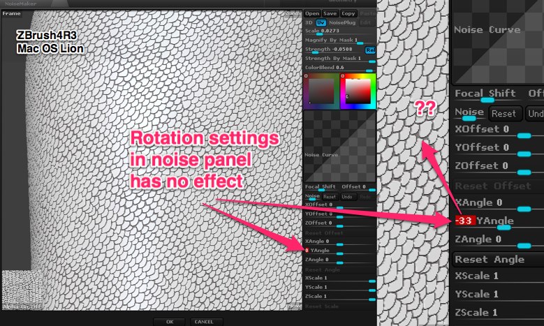

Forgive if this question has been asked before ***8212; the thread is quite long, and a basic forum search hasn’t yielded any helpful results.
When using noise with an alpha & UV, none of the rotation sliders produce any effect.
They work within Noiseplug, but I have my own alpha I want to use…
I saw in the first post that they were having some problems with noise plug and some tablets. I use a small bamboo, but this is basic functionality that just doesn’t work? Is there something I’m missing?
Mac OS Lion. 4R3.

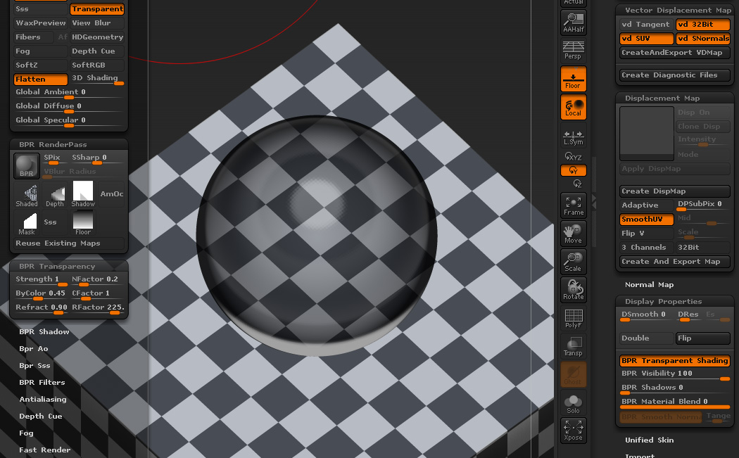

Hi, I’m having problems with refraction. Transparency in object Display Properties and in Render Properties and BPR settings are as below. The shot shows that transparency is rendering correctly but no distortion from refraction is occuring. What’s going on?
