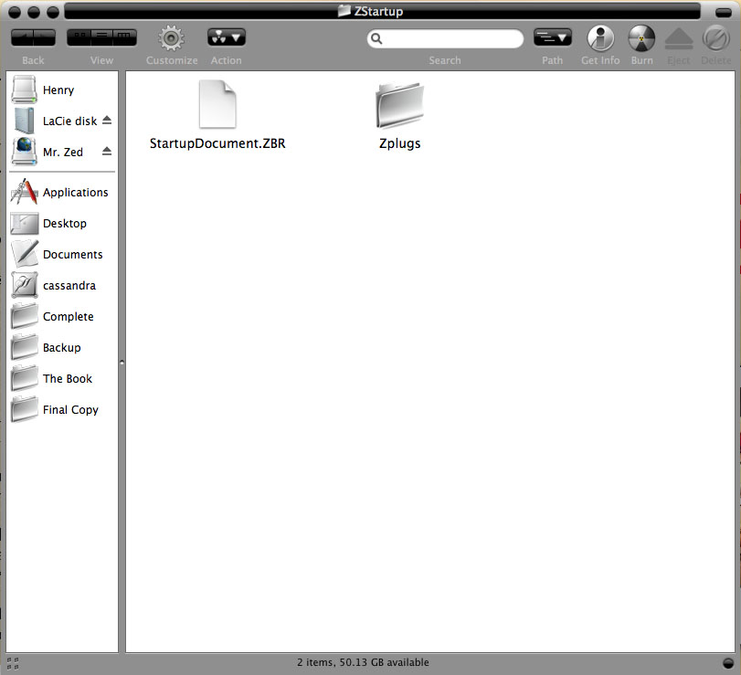

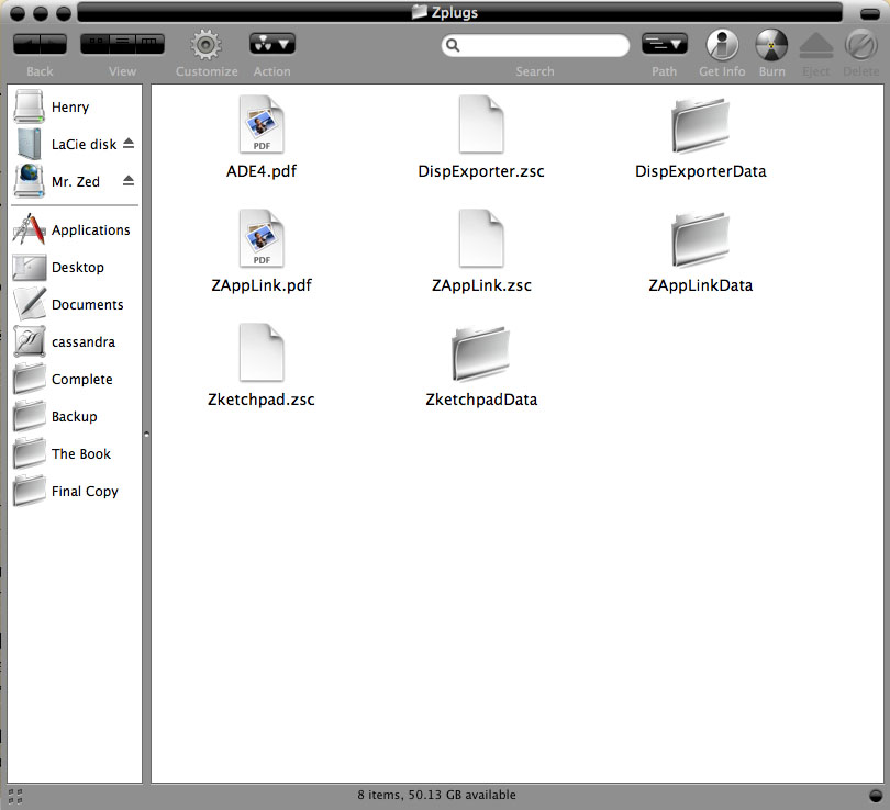

Here is my set up

I have Zbrush on my desktop and on a laptop. The laptop has more than one account since my children use it for homework (and for window shopping on ebay). I copied my zplugs folder onto my laptop zstartup folder and zapp worked fine. I made a sphere went into projection master and activated zapp. I specified photoshop cs and it opened it let me edit and acepted the changes.
My main computer is a g5 dual and my laptop is a g4 with two user accounts. No trouble. On both computers I was signed in as the administrator. I know nothing about programming, but could your files be corrupted? Have you tried downloading them again? I expect you have, I’m just feeling guilty becuase I am not having your trouble here.
