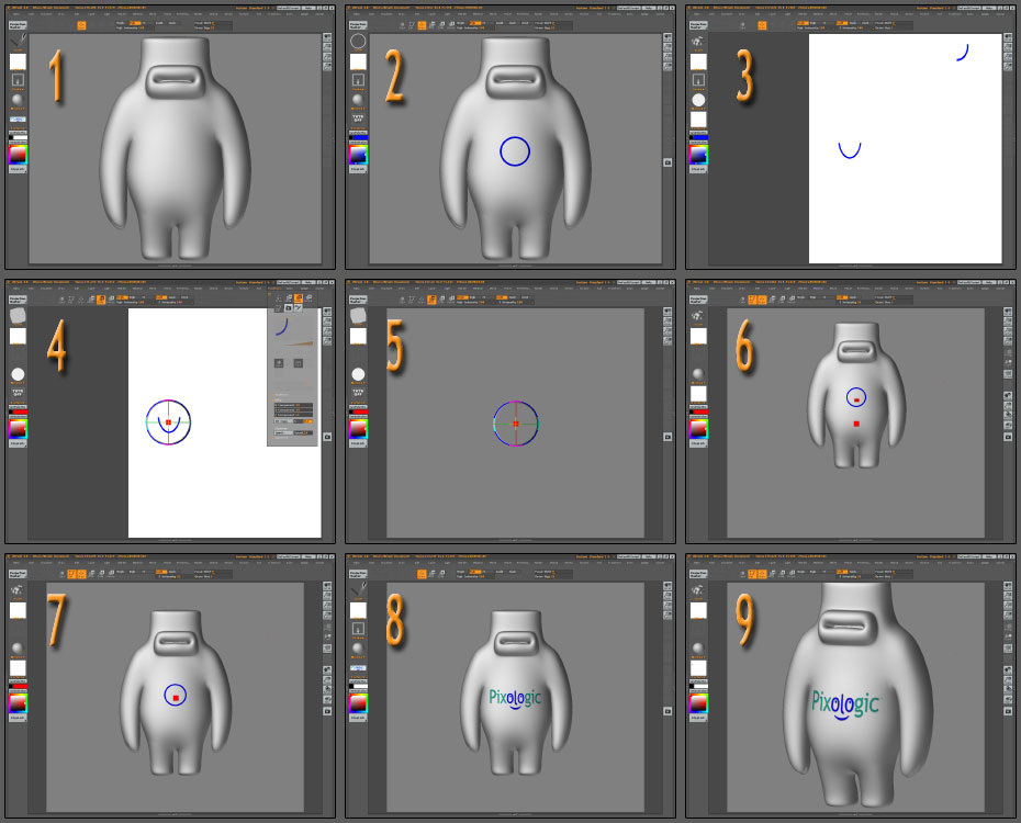

ZBrush’s projection “focus” is based upon canvas pixols vs. texture pixels. If you have too many of one relative to the other, the result will be an out of focus, poor quality projection. To illustrate, I’m going to use Hiroshi’s fun little model from this thread, onto which we’ll be projecting the Pixologic logo.

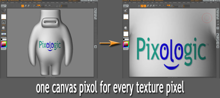

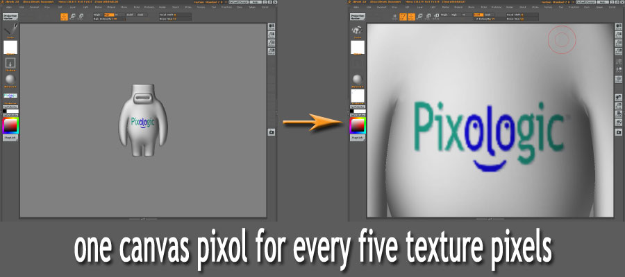

For each use of Proejection Master, the only difference is the scale at which the model is being dropped to the canvas. Each of these gives us a different ratio of pixols-to-pixels, which gives different results when the model is picked up again. (Note: The ratios mentioned in the text beneath each illustration are approximate.)
In this first example, we’ve zoomed way in on the chest (left view). As a result, the logo takes up a LOT of canvas pixols – about 800 pixols across. On the other hand, the texture that the logo will be projected onto is only 2048x2048 in size. Relatively few of those are assigned to the chest. The result is that we have a large number of pixols being projected onto a relatively small number of texture pixels. Since there’s no such thing as a 1/2 pixel (much less 1/5 pixel), ZBrush has to discard a lot of information from the canvas in order to make it all fit onto the texture. The results, as shown on the right, aren’t great. Without the artist’s eye to know what details are important and what aren’t, the discarding gets applied uniformly across the canvas and the results are a lot of pixelation.
