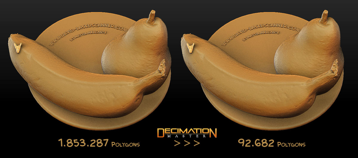

I’ve done a quick test with the great tool ā€œDecimation Masterā€, using three scanned object with a Laser Scanner.
I’m very satisfied of this new Plug-in of ZBrush: it works perfectly, without problem and/or crash. And it is very fast to calculate the new poly density.
Here below you can see a decimation of three meshes with high density of polygons (obtained from 3D scans).
Now my ā€œStill life with Flyā€ :wink: is ready to be converted as a 3D .pdf file (please, look at this Wiki Gallery http://www.david-laserscanner.com/wiki/david_laserscanner_multimedia_gallery, Hal’s Gallery).
Thanks to all,
Cheers,
Mattia
