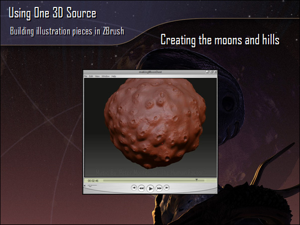

The first thing that I did was create some moons for my background.
[attach=90494]makingMoonDust.jpg[/attach]
Here is a video that shows this process.
[veoh]v1561714wgRanwJh[/veoh]
Once I had my final moon built I looked around on the surface to find a good start to some valleys and hills that I could use for the main piece of my background. Once I found a section that I was happy with I exported that small section out to Maya and put it into my 3D layout that I choose. From here I had a new model that I resurfaced to get some clean geometry, I then used the project all button in the sub tool palette to project the old geometry onto the new geometry. I then sculpted out the hills and valleys to a higher level of fidelity.

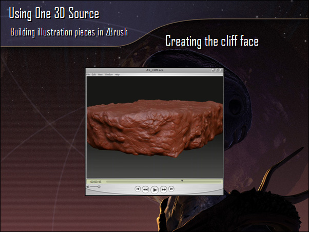

Once my mid ground and background were complete I worked on creating a cliff face that my character would stand on.
[attach=90495]makingCliffFace.jpg[/attach]
Here is the video that shows how I built this piece.
[veoh]v1561718rGYQmR63[/veoh]

could you please explain this? " I then used the project all button in the sub tool palette to project the old geometry onto the new geometry "
In the video looks so easy but I cannot fully understand how you do that.

Anibalin - look back a page in this post. I made a whole video on this subject.

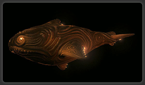

Here is a craft that I made for my illustration. I still need to render all my craft in the final lay out and then comp them in the final illustration. Then I shall show the world!
[attach=90496]AS_craft_render_01.jpg[/attach]

Beautiful colors and design. Brings the best of Moby Dick, and Steam Punk adventures together in one interstellar whale. Awesome work.

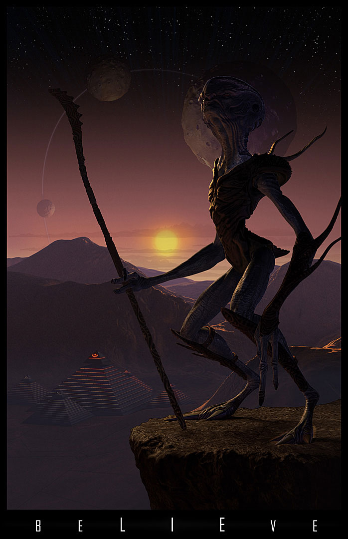

OK, I am calling this illustration done. I wish the flying craft that I built would have worked out but they just were not fitting with the final piece. Oh well I had fun making them.
I hope everyone enjoys the render.
[attach=90497]AS_planet_final_1920X1080.jpg[/attach]

Wonderful illustration
I think you have enough going on in the background. I really like the way the focus is obvious and the pose and expression are perfect. Thank you for the thread as it was very informative.
Exceptional finale.
You could always use the whale as a talisman to hang on his staff or around his neck, and use it as an excuse to make a soft, biolumenscent blue fill light in his darkest shadows.
The dramatic pose and lighting, here, though, is plenty.
Thank you for the epic walkthrough and completing the illustration. All-time classic.

Your render has given him a rather ‘God-like’ quality
Should we be reading a message in the beLIEve title? Nice piece of work.

This looks fantastic. Well done Nick. The best part is that it can actually move :D. I like the pose. Its strong and proud. The lay out of the image is good too. Your eye flows around the image. Congrats.
I wonder what it will look like with some sss. I know its over used nowadays. But hey. It looks cool. Haha.
