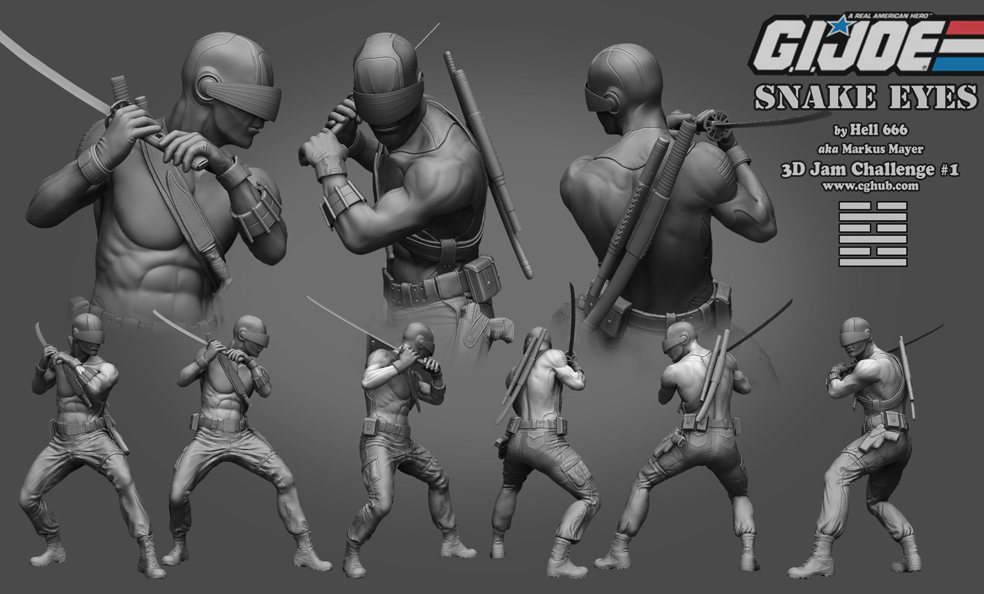

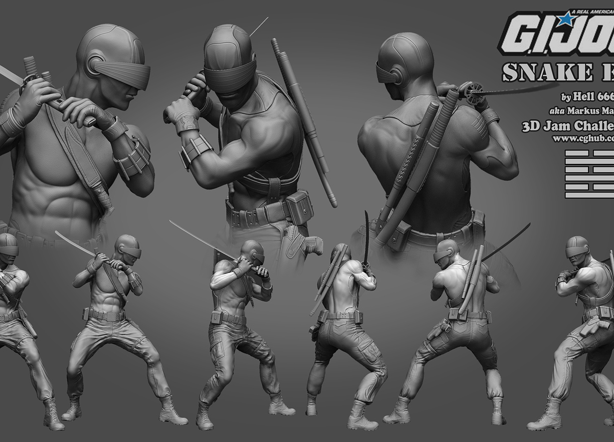

Well, here is my finished artwork for the challenge on cghub.com. Hope you like it.
well, it is just so…perfect! Great job.
Good luck for the challenge.
pretty appealing stuff … the guy is luking nice …pose is gud … but i think the pose is loosing strength bcoz of that loose hand grip … may be he can old the sword more tightly…
whoa! top row stuff, all of it! :+1: :+1: :+1: :+1: :+1:
Incredible work you done,top quality 5 star stuff…:slight_smile: Cal…
Thanks Hell666, 4 gb will be better. It seems any and all suggestions make a combined improvement to file performance.
GIJoe is very good I like the stance, maybe the right elbow can go higher even horizontal. Perhaps even the other elbow as well, following the line of the sword.
I first saw your work in your thread From Hell… I just wanted to subscribe to your sketch book since you are so talented. Top notch everything! :+1:
schöne arbeit !
