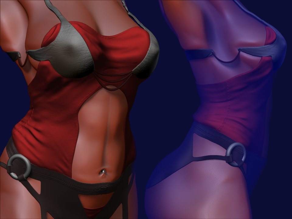

I sculpted a cylinder for the body with no regard for edge loops. I followed that up with the retopology tool - awesome. It’s such a freeing work flow. Used subtools and mesh extraction for the extras. Lazy mouse for wrinkles and stiching, tiling alphas for a little cloth texture and skin pores. Lots of fun!
nice one but the bra looks painful

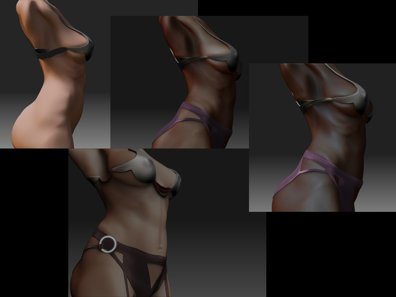

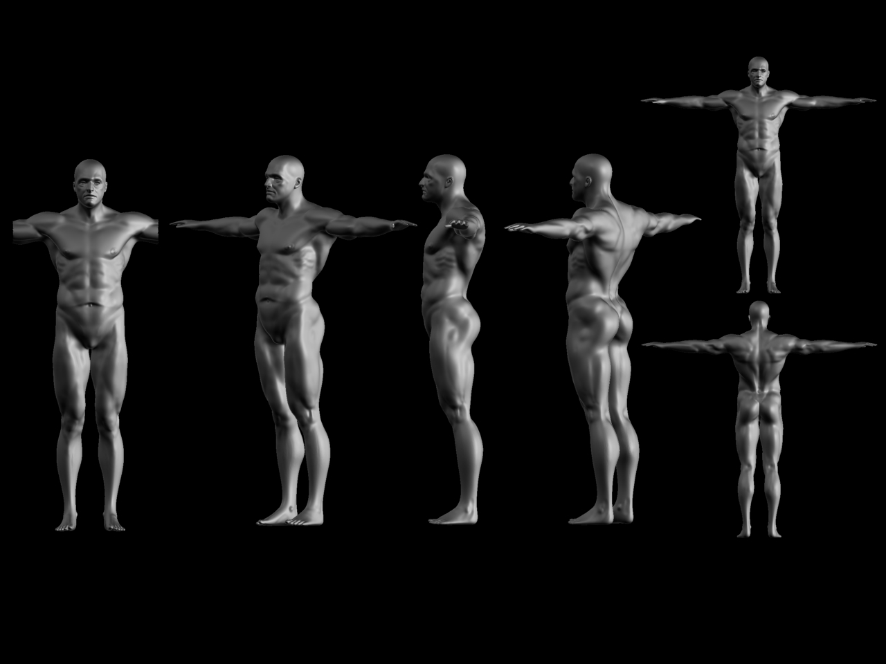

[attach=57486]anatomy_1.jpg[/attach]
Top Left - basic sculpt.
Top center and right - couple skin shaders and some extractions
Bottom - retopologize and soften

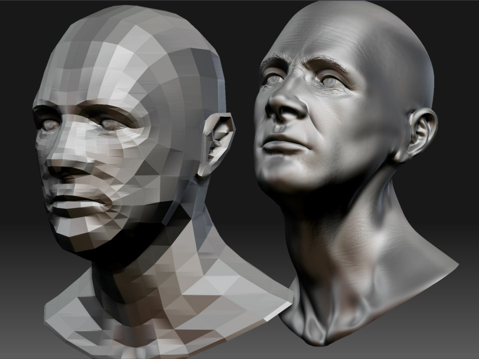

[attach=57487]torso_wip.jpg[/attach]
Subtools are so great.

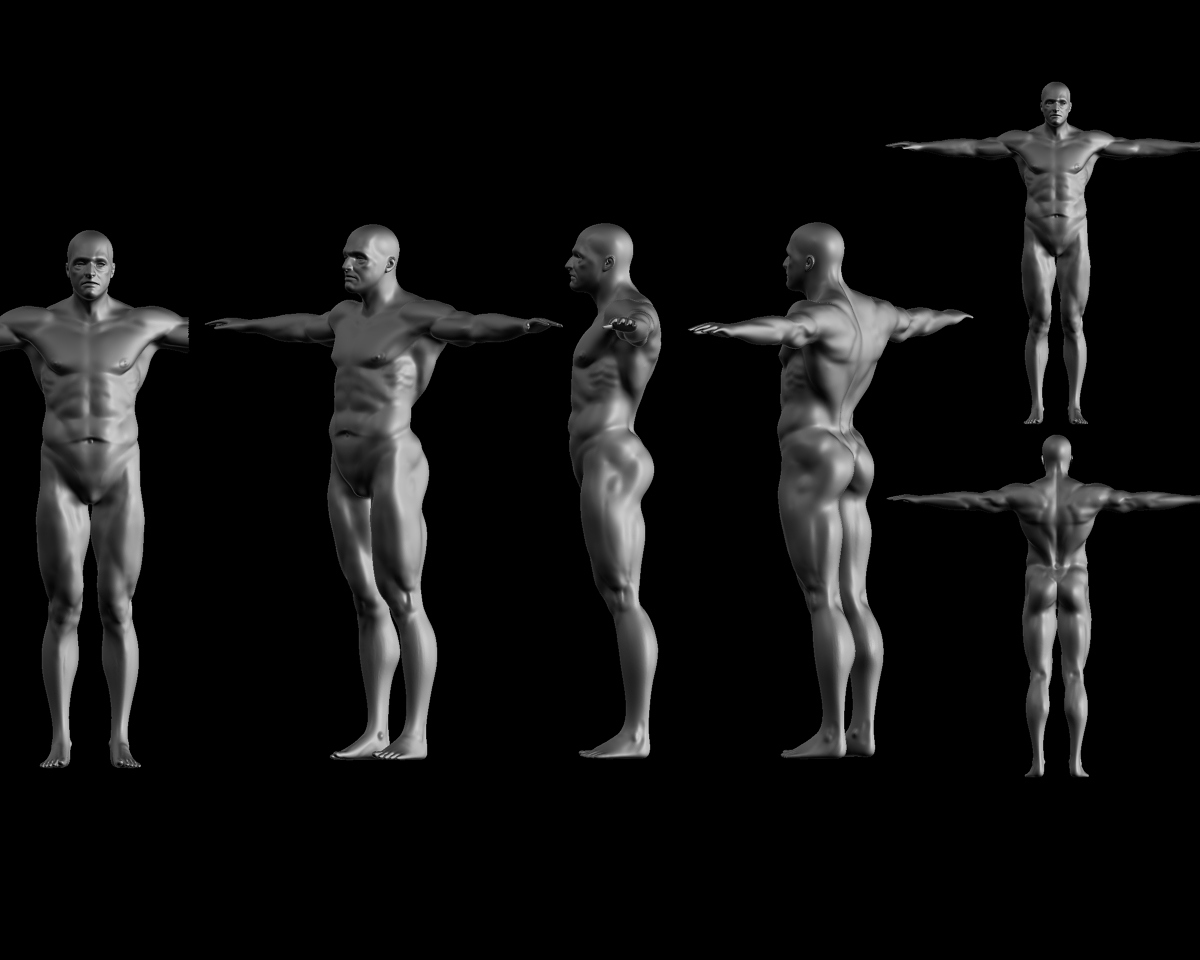

i like your male study some bigger pictures pls
Here you go! Didn’t work blow the elbows or the knees much. This was for an anatomy discussion/ modeling I had with a friend about a week ago.

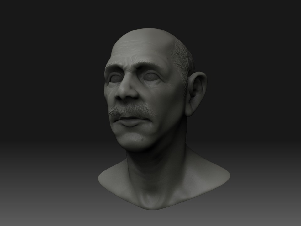

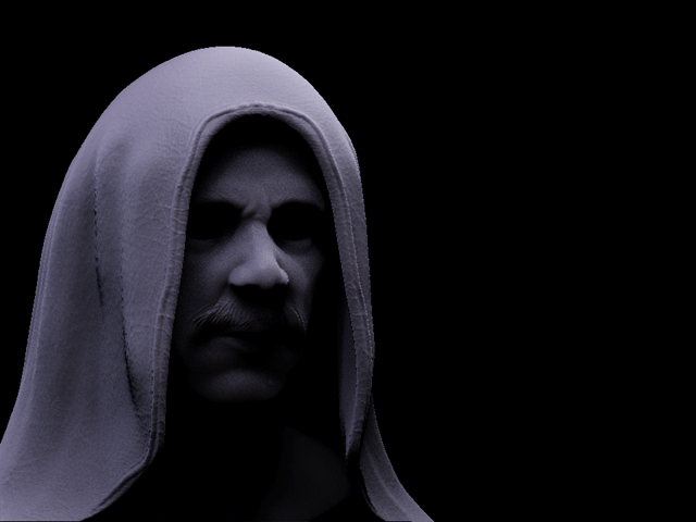

Character prototype[attach=57496]stacheBust.JPG[/attach]
Really like the last character. Very realistic. Keep’em coming.

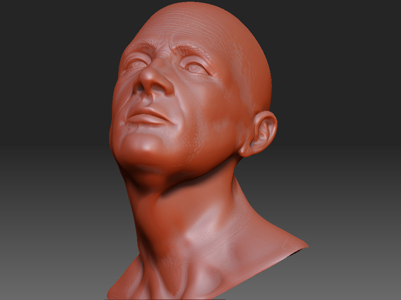

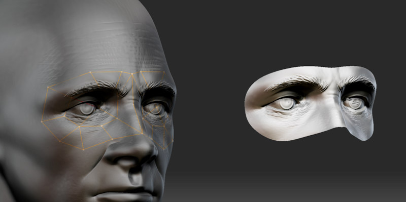

…which is why the neck is so smooth. For this test I deleted the subdivs so I could add the eyes back into the mesh to transpose together. Without spending too much time on the test I masked off the polys and reposed the head, I smoothed out some anomalies on the neck area. I won’t export this posed so I didn’t spend any time on the sculpt in this pose. I like what a little posing does for getting a feel for the character.
You do not have to delete subdiv, simply make sure that the eyes have the same number of subdiv then insert the mesh. If you do this, you will have a combined mesh with all the original subdiv levels intact and you can transpose the combined mesh in a lower subdiv level.
So, it is the mis-match beween subdiv levels which makes them incompatible for mesh insertion. Now that you say it, it makes so much sense! Thank you for the reply!
I reconstructed subdivs on the eyes and made them match the number of subdivs on the head (6 in this case). Then I cloned the eyes, deleted them as subtools, and inserted them as meshes. Then the eyes and head are all capable of moving up and down through the subdivs, like Aurick said, and it’s sweet! I went ahead and reposed it using the much softer gradient mask I can easily get from lower poly mesh, and posed it up. The neck details are maintained, and the sterno-cleido mastoid even seems to deform like a muscle. Zbrush rocks, no doubt.
