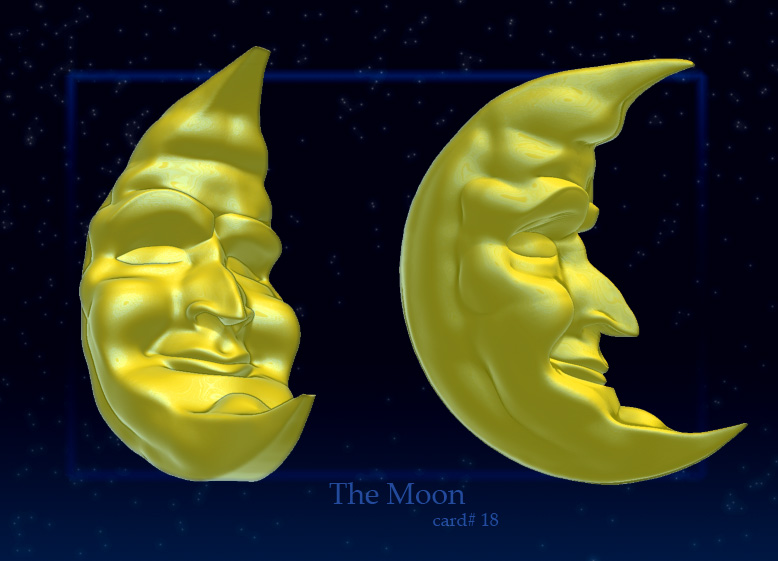

Since I am commited to do the whole image using ZBrush (except for compositing), I might as well experiment with various aproaches to modeling. Here is another process:
[](javascript:zb_insimg(‘29599’,‘MoonCard18B.jpg’,1,0))
And here is one more card. Much more to follow…
[](javascript:zb_insimg(‘29600’,‘MoonCard18.jpg’,1,0))

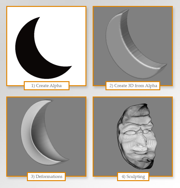

hi mytholon,
I see you made a great progress on your project.
Would you mind telling me the detail prosess to creat a 3d object from a alpha? it looks very interesting.
thanks in advance!!

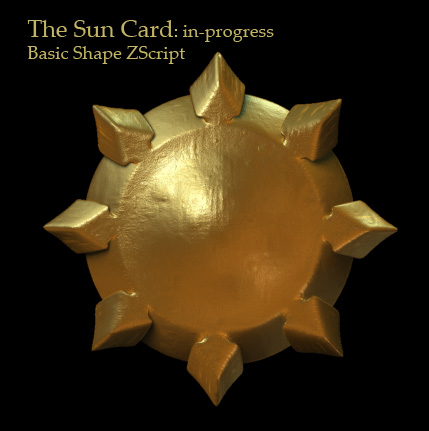

souwanaplay: Thanks! This specific post is especially created for you! The Zscripts bellow will show you how I make 3D from alpha.
Jason: Thank you for all your encouraging comments from the start.

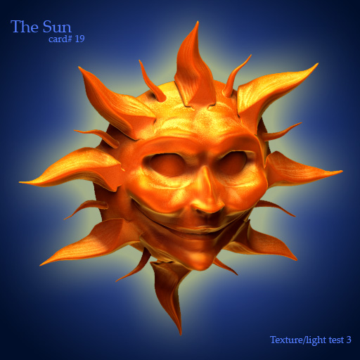

So I am working on my Sun Card today, and since it was requested I have included Zscripts showing the process of arriving at my basic shape for my character. Some things to keep in mind:
When I create Alphas, I do them 512 X 512. But in the case of this Zscript I didn’t, because I have noticed that when you change document size while recording, the change is not being recorded. If I had created the Alpha in square dimentions, I wouldn’t have to scale it afterwords.
When playing the Zscript, you probably have to turn on the Show Actions button under the Zscript menu, otherwise they may not play correctly (I don’t know why though…)
When the first Zscript is done, please save the Ztool that is generated, because the second Zscript will ask you to load it (this is how bad I am at recording Zscripts).
I hope those are helpful to your creative adventures with ZB!
SunBasicShape.zip (26.7 KB)
Wow, thanks a million Mytholon, you are very kind and I appreciate very much. I hope everybody is like you then the world will be a much better place!!
keep the good work and happy zbrushing!
p.s. I just had a look at the zscript. I have no idea you can make a 3d object from alpha by click make3d, that’s how crap I am at zbrush.:lol:
thanks again Mytholon, it will certainly help me speed my modeling process a lot!!

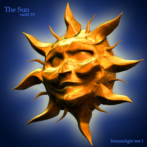

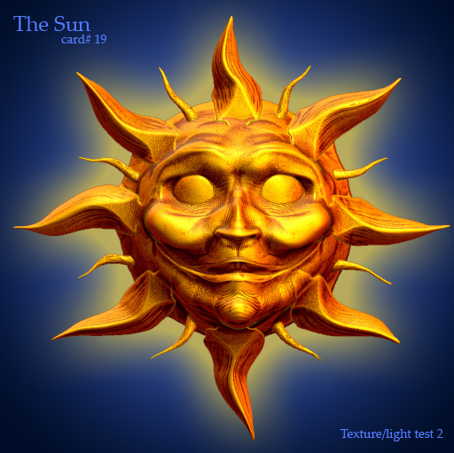

[](javascript:zb_insimg(‘29666’,‘SunCard3.jpg’,1,0))
very very cool, or hot, you get my drift, i love the face, and colors.
Man you should make that sun into a physical product. It would sell like hotcakes.

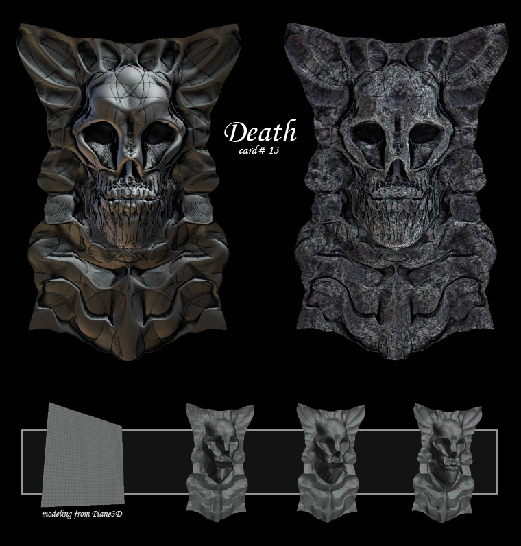

This is probably the darkest character - card in my image. I was in a delima making it, since I don’t think Death is to be percieved as an absolute negative thing, since it is not only an ending but also a beggining (or so i would like to think). But in the end, I decided to keep it more compatible with the classic illustrations of the Tarot deck (which shows an armored skeleton).
Always trying for a variety of modeling techniques, I decided to sculpt this from a Plane3D.

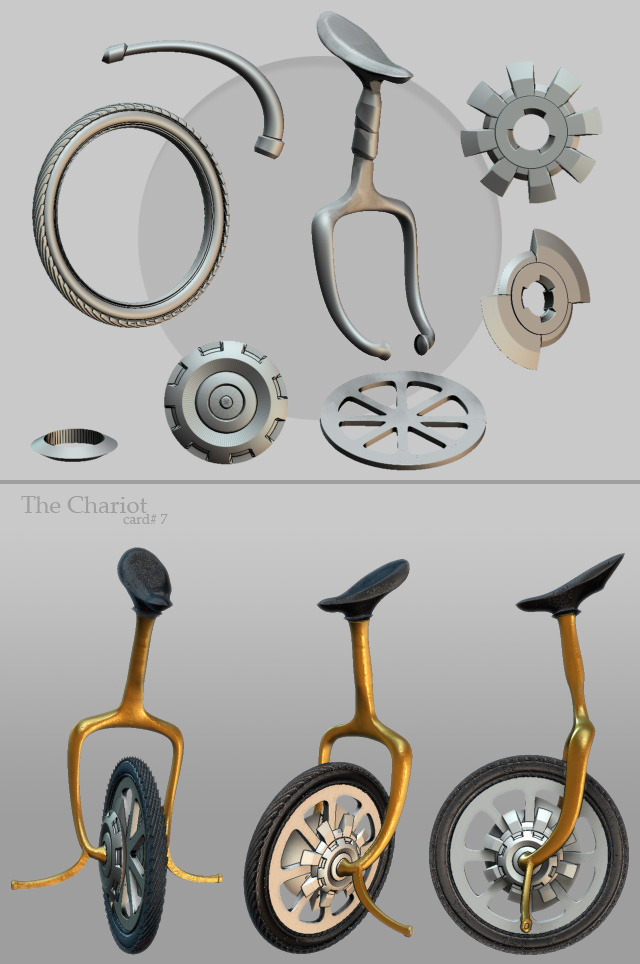

After a bit of time with no update (too much work), here is the model of one more card of the deck: the Chariot.
I took some liberties on the the representation of this card, because according to my sketch, the Fool will have to ride this “chariot”, balancing on a wire, suspended high above the landscape of the Tarot world.
For this model, I created several parts, and then combined them with Marker Master.
