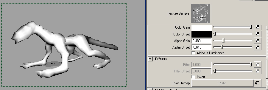

btw your setting will look like this
dont forget 32 bit maps have displacement quote “baked in” of course is that was true alpha gain and offset would not be so far offf!

Alot of times your map will be washed out especially 32bit. The more white your map gets the less alpha offset and alpha gain you need.
White is just a very hot map (lots of depth and height value.) they usually start at .50 -.50 offsets
