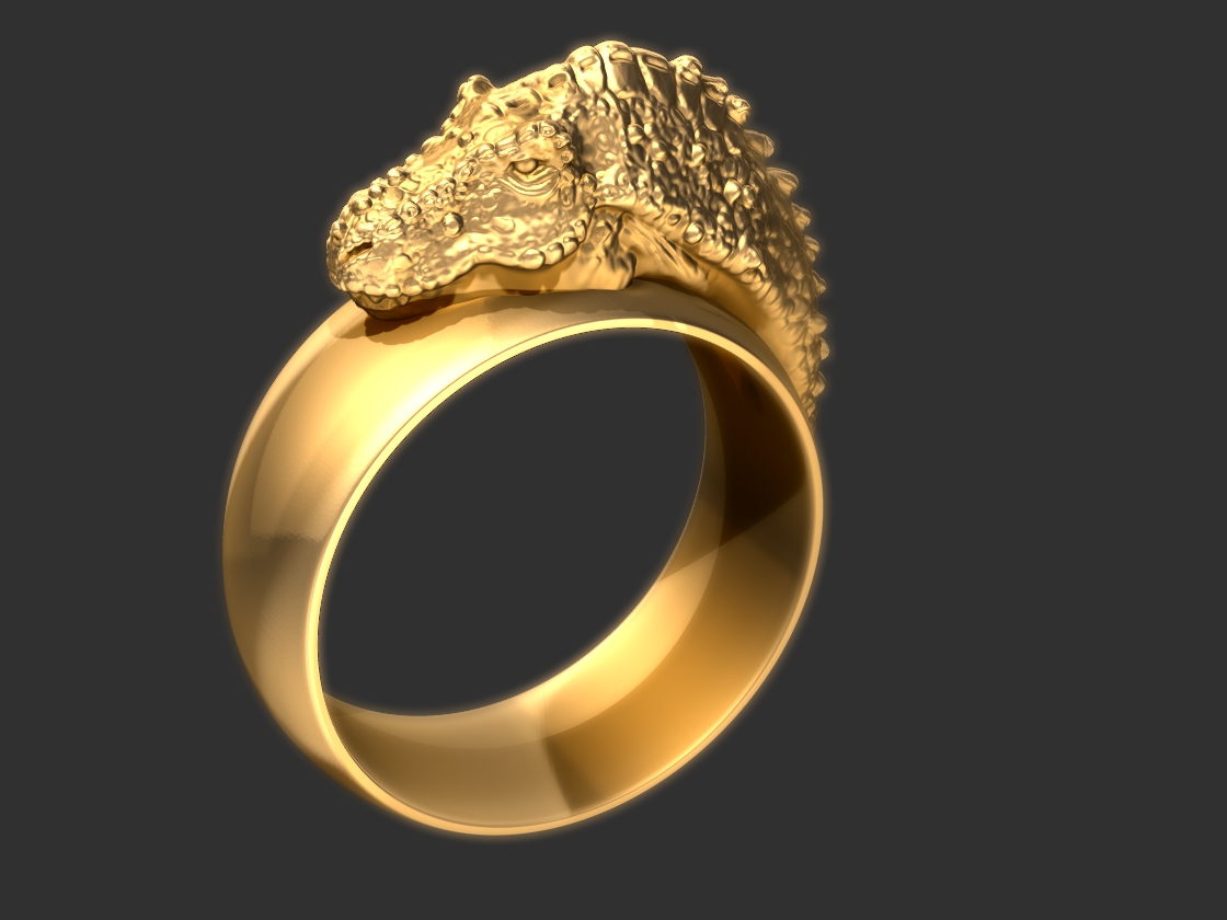

as for the rhino ring. it is a fairly tall piece but not too bulky as its hollowed inside which reduces the weight and prevents the metal retracting/collapsing as it cools after casting. if i remember that ring was only about 3mm at its thickest point.

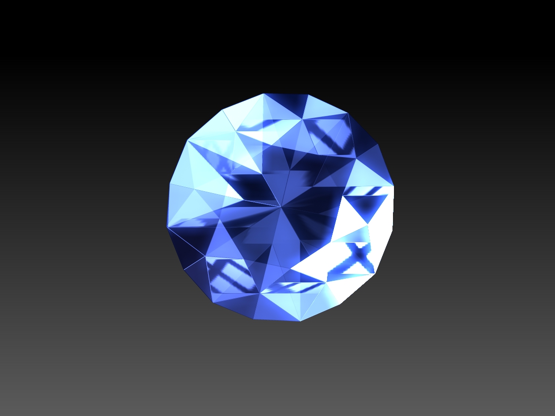

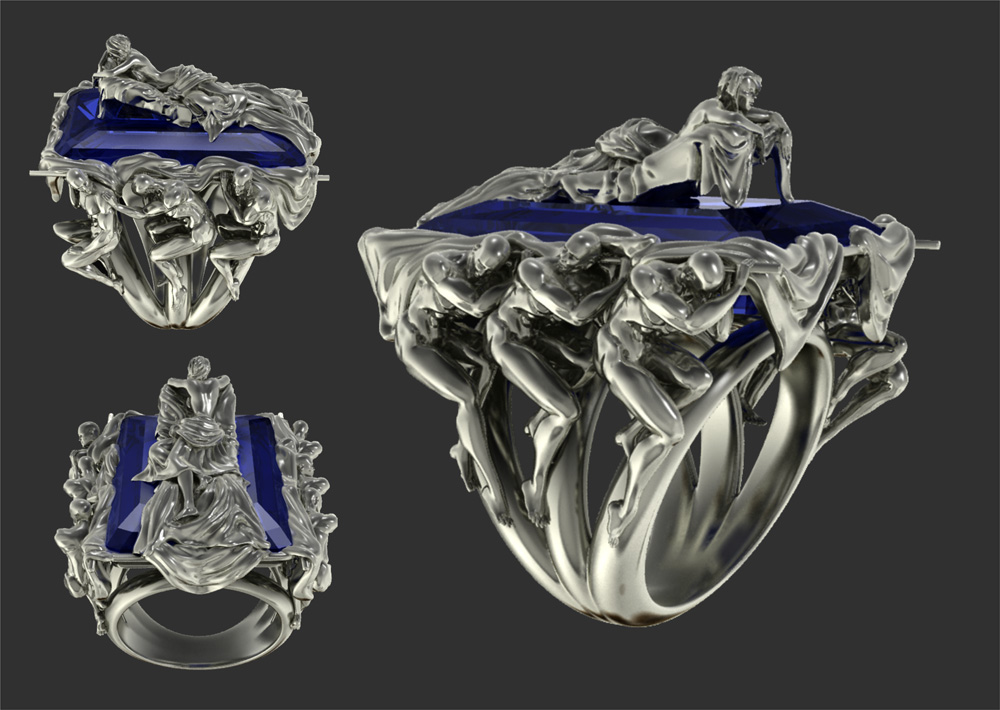

alas no i didnt. i used 3dmax and Brazil to do that. HOWEVER… have you tried mat capping a diamond?
M
I’d be interested in knowing the results myself. But I don’t think that ZBrush’s renderer can handle it. Think making clear stones look like clear stones* requires raytracing that has special code that allows it to break into spectrum light. The best thing I could think of to make it look less like glass in ZBrush would maybe be to foilback it with the silver foil material some how. Would look like a rhinestone, but that would probably look better than looking like clear glass. But I think if you’re really trying to go for hyper realism for this kind of stuff, you probably have to stick to an external renderer.

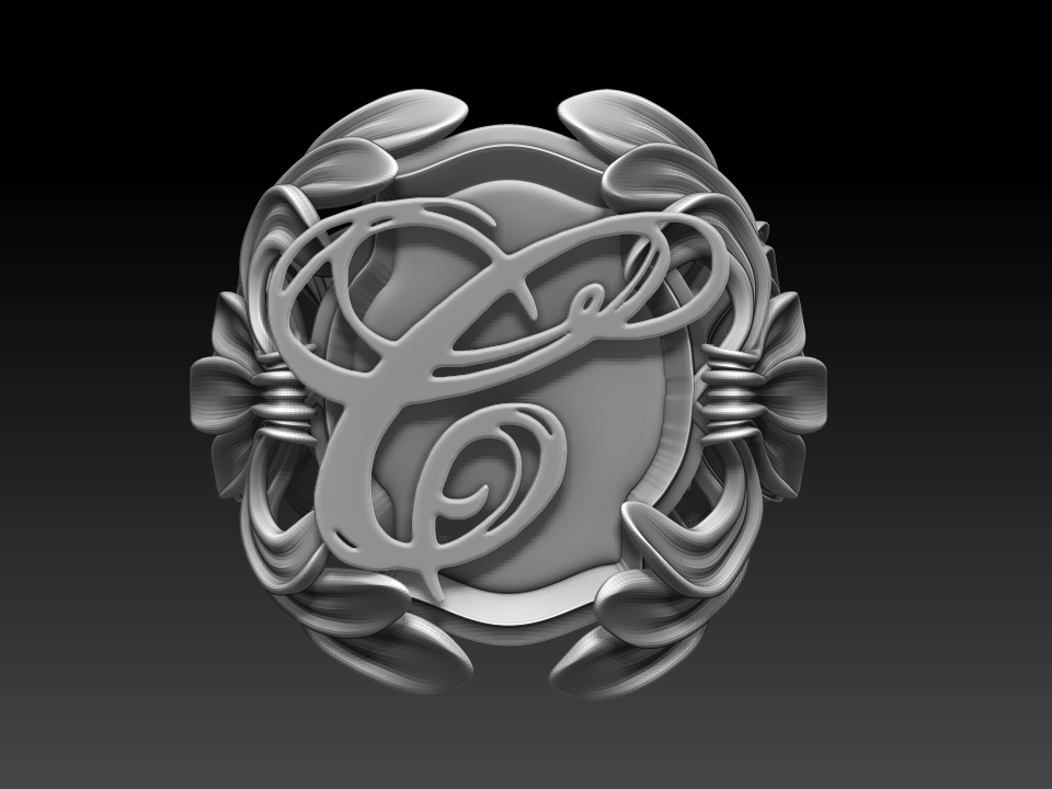

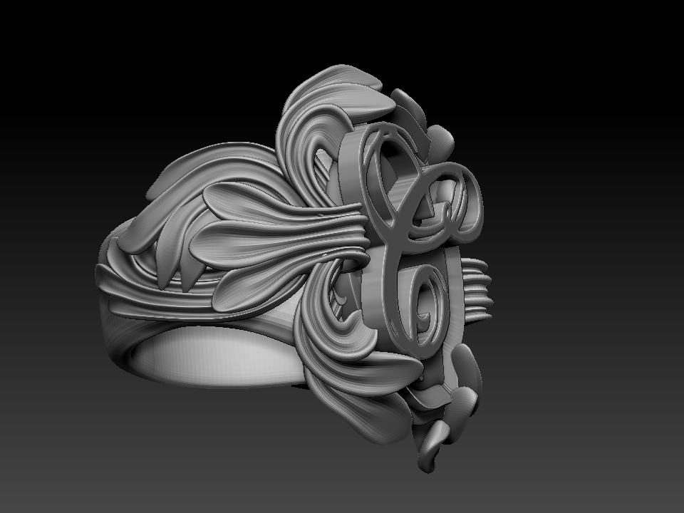

heres a little ditty i started today … although its not finished it does look promising… still need to work where im going to put the stones and if im going to enamal the C…
hoep you all like them

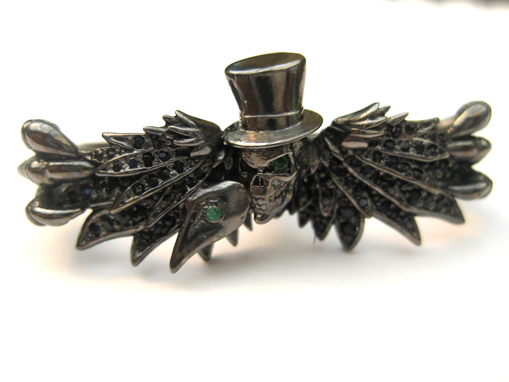

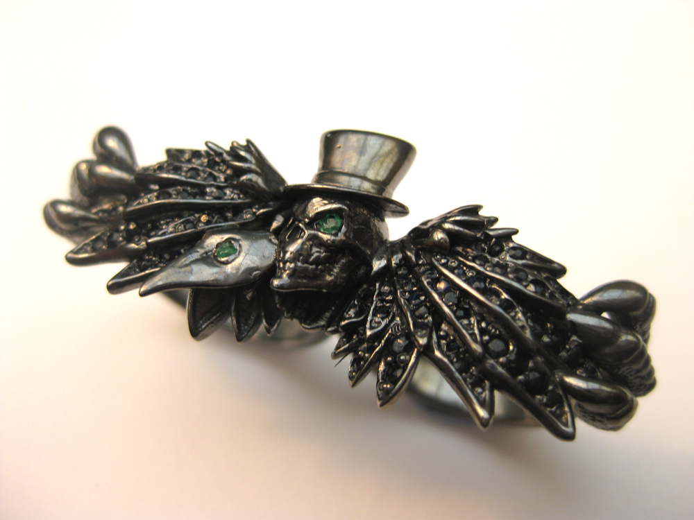

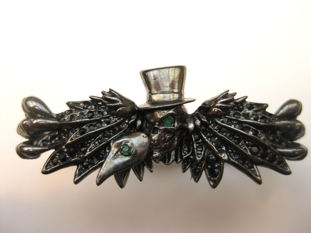

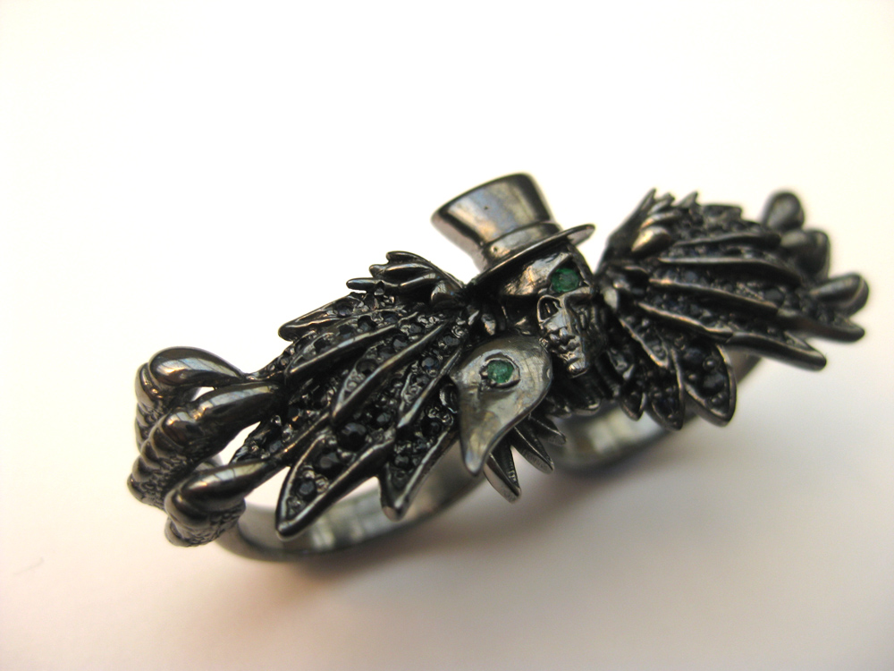

Tadar the most complex piece ive done so far finished. all done in zbursh including the settings. made and manufactured into reality. it is black rhodium plated with around 40+ black emeralds and 2 saphires on a double ring.
hope you like it

with all the moving and getting used to my new job i havnt had much time to post or keep up togther with all the happenings. however in my evenings i have produced this design which ive submitted for a jewellery comp. let me know what you guys think:D
best of all ive been able to talk to one of my jewellery producers who will be printing the model for me so more images to come
Hi
Congratulations on your new job. And what an amazing looking ring, would like to see it finished. What competition are you participating in ?
