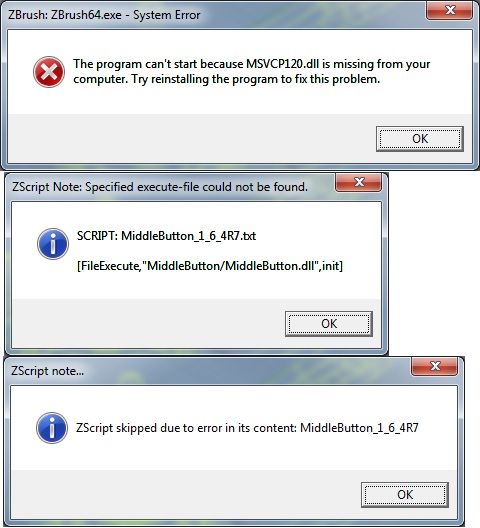

So, I extracted the .zip in the folder C:\Program Files (x86)\Pixologic\ZBrush 4R7\ZStartup. It looked like it fed the plug in stuff to the right folders, no problem. When I start up 4R7 (32 bit) it seems to be fine, but when I try to start up ZBrush 4R7 (64bit), I get this string of 3 errors.
And when it does start up, the MiddleButton plugin is not there. I’m on Windows 7 (64 bit). Has anyone else had this problem? Any advice?
Install Visual C++ Redistributable Packages for Visual Studio 2013 (vcredist_x64.exe). You can find it here: http://www.microsoft.com/en-US/download/details.aspx?id=40784.
This worked like a charm, thanks!
Thank you so much, You are a hero. :smiley:

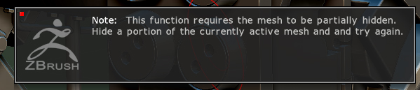

Haven’t seen this mentioned anywhere:
MM Wheel Zoom IN works perfectly fine for me, however whenever I try to zoom out I get
This only happens when a Polymesh3D is active – doesn’t happen on primitives.
I am on Windows, ZB x64, all default settings for MM Plugin.
I deactivated the plugin and did a middle mouse zoom out to see if by mistake any other function was attached to this but when the wheel is deactivated in the plugin nothing happens.
Anyone else has this ?
MM Wheel emulates key press of Num ā€œ+ā€ & Num ā€œ-ā€.
Perfect ! Thanks, that explains that and fixed.
