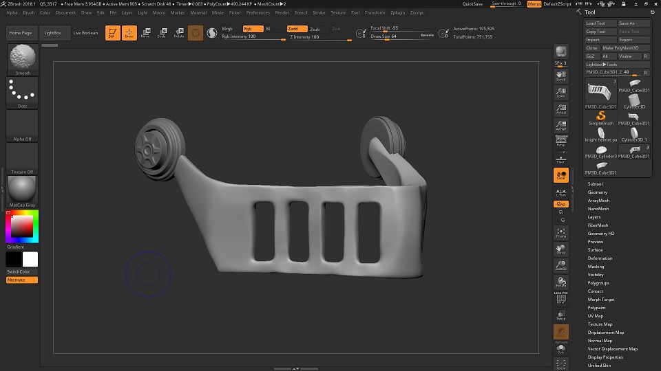

I am currently trying to sculpt the visor of a medieval knight helmet ( the part that covers the mouth)
the problem is i am struggling to get a nice flat and even surface and shape.
any tips or advice would be greatly appreciated. thank you for reading and i have posted this in the wrong thread i am sorry this my first post. sorry if the images didn’t load correctly
the first image is a reference and the other 3 are my attempts at making the mouth piece.Helmet.jpgattempt 01.jpgattempt 02.jpgattempt 03.jpg

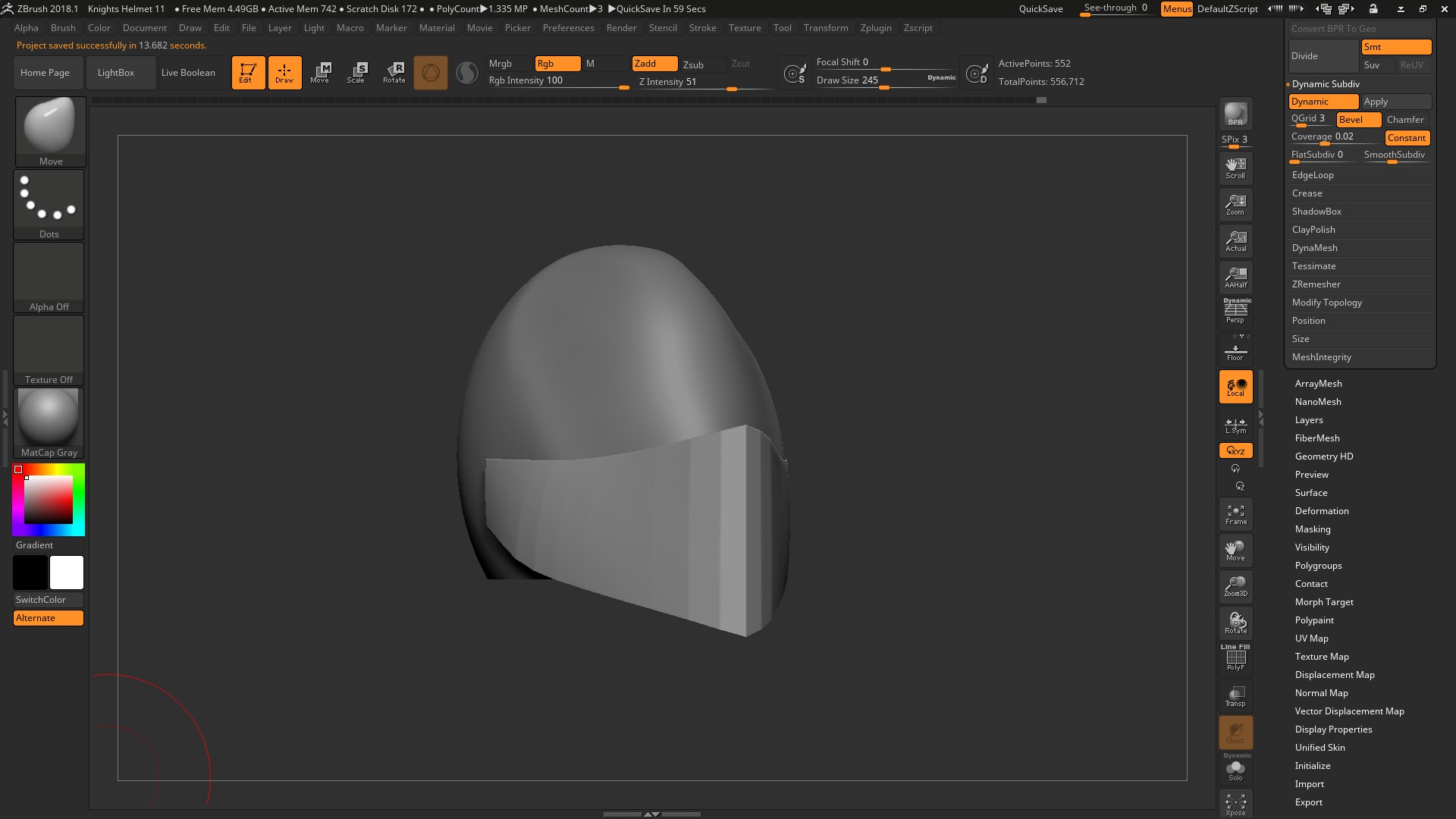

I find that when doing hard surfaces shapes like this, one of the best ways to get nice clean curved surfaces is to keep your basemesh as low poly as possible to let the subdivision smoothing create the curves for you.
I’d just do the visor’s main shape first, and only as a single plane (no thickness, no holes). Just worry about getting the overall outline and curves defined so that it looks nice and clean when using Dynamic Subdivision with 3-4 levels.
From there you’d have two different approaches:1. Use ZModeler to extract the polygroup, which will give thickness to the plate. Then use Live Booleans to subtract the square holes.
  1. Subdivide the mesh once or twice, then delete the lower levels. This will give you a base level with more geometry while retaining the nice curves that the subdivision formula had created from the original. With this extra geometry you can use ZModeler to delete the square holes, then use it to add the thickness. Creasing or bevels can be used to help maintain the sharpness of these squares when you subdivide further.

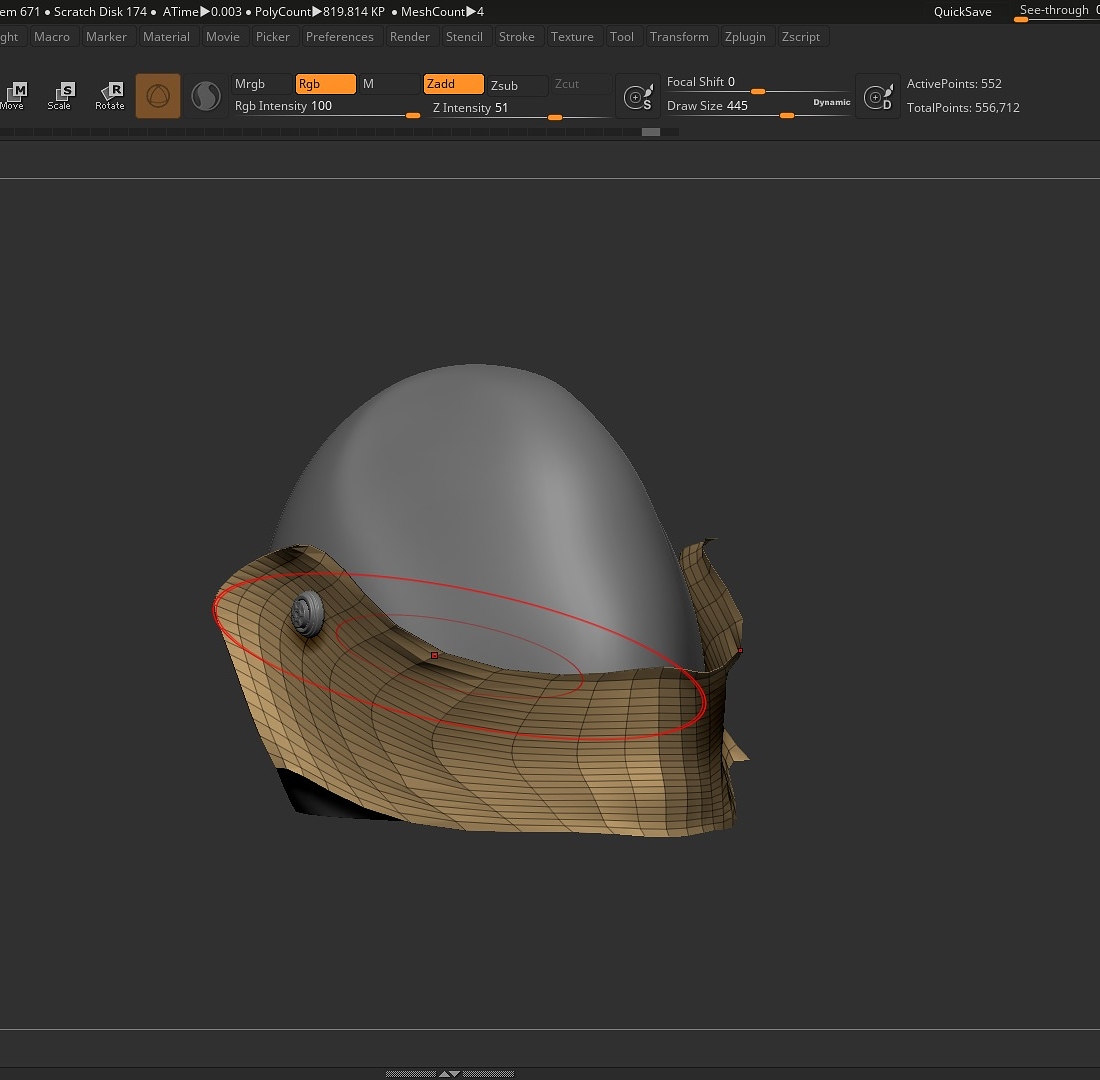

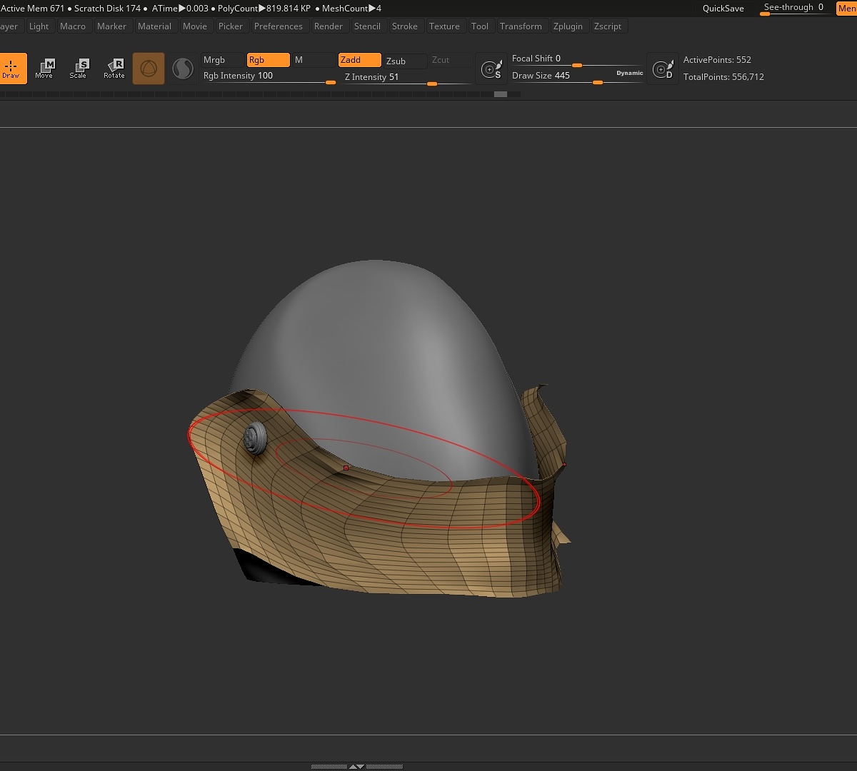

I am currently trying to get the 3d plane into a good shape whats the best way for moving and shaping the plane and what would be the best polycount for doing that?
this is my current attempt at getting the 3D plane into the shape of the mouth piece any suggestions for how to sculpt it into the overall shape such as what brush or method to use?
never mind using the bend deformer seems to be working for me
I’m starting to get a good shape with the mouth piece. I still want to get the front of it mouth sharp and pointyattempt 05.jpg

I’d go even lower. As low as possible so that subdivision handles the bulk of the work for you.
I started with a cube and subdivided it once to give it some instant roundness. I deleted half of it (the top, bottom, and back), keeping only the front and sides. I inserted another edgeloop or two into the sides so that I could define the borders a bit better, but otherwise stuck with this basic 20 polygon shape which made it very easy to work with.
From there there’s hundreds of ways you can approach it. Inset, creases, bevels, etc. Standard Subdivision techniques.
Here I’ve extruded some thickness into the visor, creased the polygroup that made up this thickness, and then added control edges closer to the middle so that it will maintain its sharpness while subdividing.
A bevel can later replace the creased thickness, but for now I’d stick with crease tags as they will let you work with fewer polygons in case you still need to make changes to the shape of the visor.

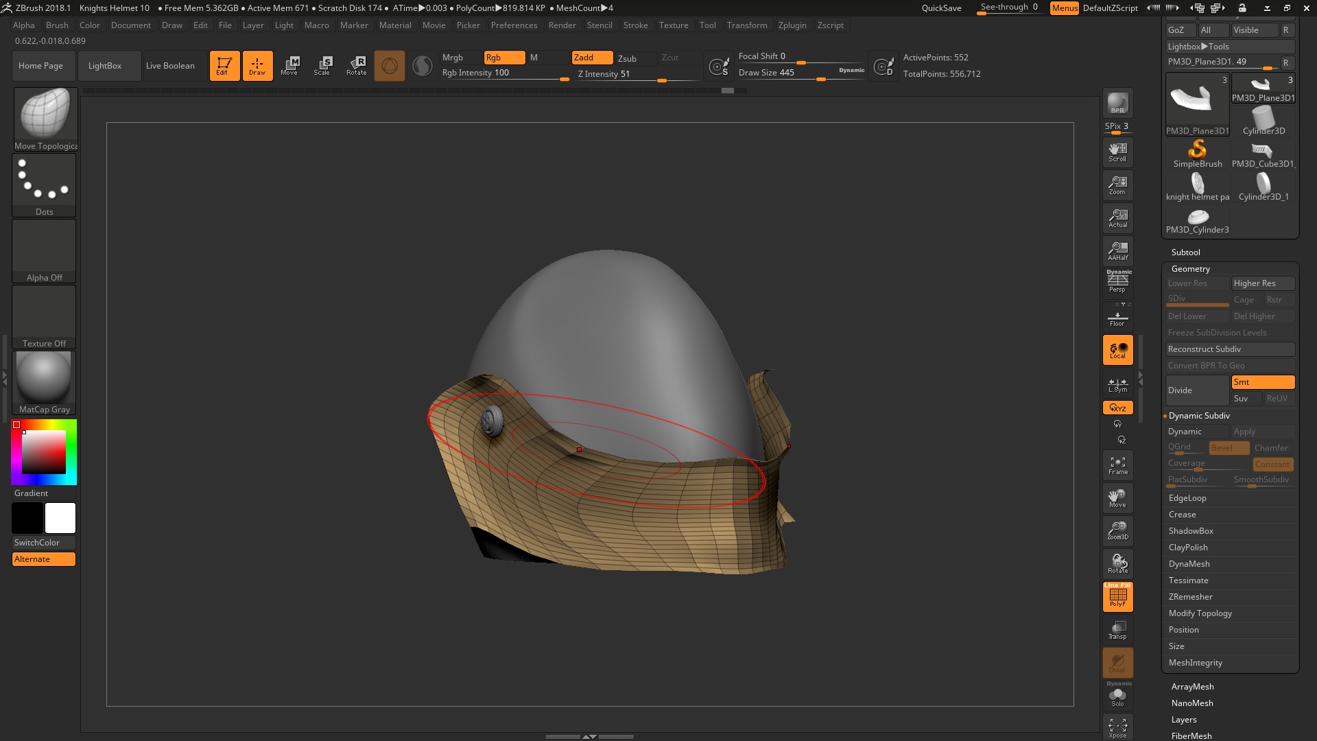

Here is my model i made following your advice. it starting to look good the only problem i have at times is moving a whole edge-loop and that z modeller and symmetry don’t want to work together some time and it would say operation cancelled non symmetrical .attempt 06.jpgattempt 07.jpg

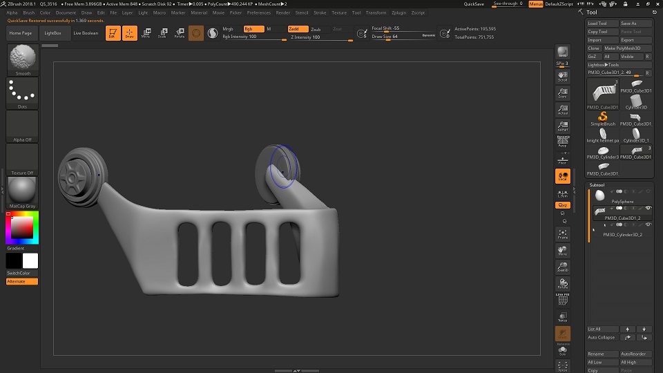

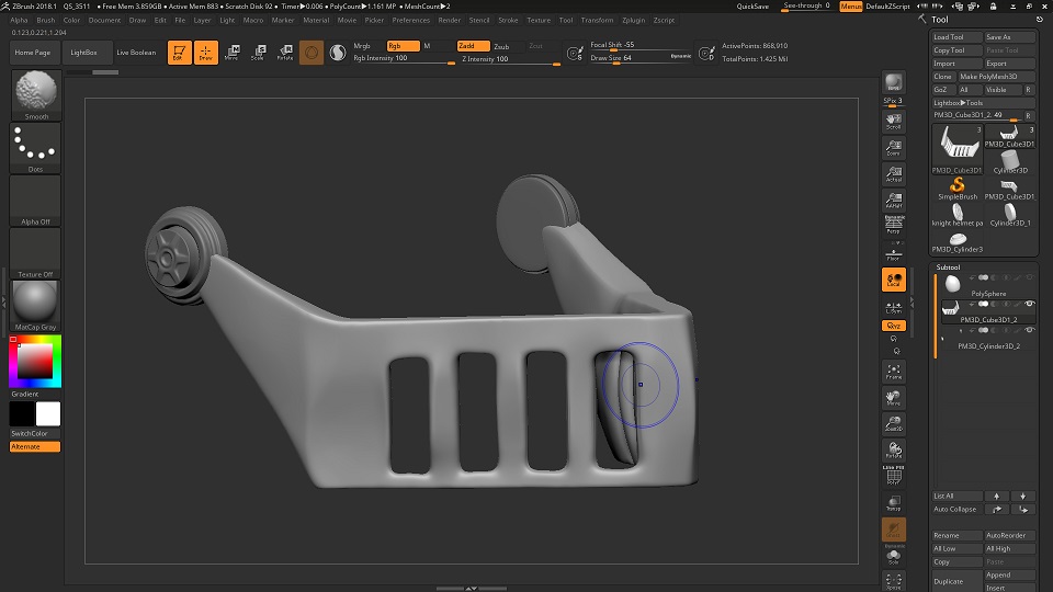

Hi i am having trouble making square holes using z remesher any adviceattempt 08.jpg
update: i used bridge to fill in the gaps i made when i created the holes i just to make the holes more squareattempt 09.jpg

the problem with creasing is that i creates this weird look its a bit hard for me to describeattempt 10.jpg
last update i promise i fixed the problems all i need to do now is making some of the edges look smoother.attempt 11.jpg
It’s looking a lot better. The pinching is likely the result of a tight edge loop running across the entire surface. This is good for the holes to help control the sharpness, but not the rest of the mesh where you don’t want the sharpness to exist. And this is where classic subdivision modeling techniques really come into play.
If this were a traditional modeling program then I would suggest a different approach so you can take advantage of the program’s modeling stack, but since zbrush doesn’t have that kind of functionality (and because you might want topology that also favors sculpting / painting) I would stick to a more ‘brute force’ method that either mostly ignores topology (Live Booleans) or relies on using a lot more polygons to eventually hold the shape.
Here is an example of what I had meant earlier. You create the base shape with as few polygons as possible so that subdivision handles the heavy work of creating the real shape you want. Then you actually subdivide the model a few times and delete the lower levels so that the subdivided mesh becomes your new starting shape. You then cut your holes into this denser mesh so that the edges automatically will be tighter / sharper without destroying the smooth curve of the surface.
