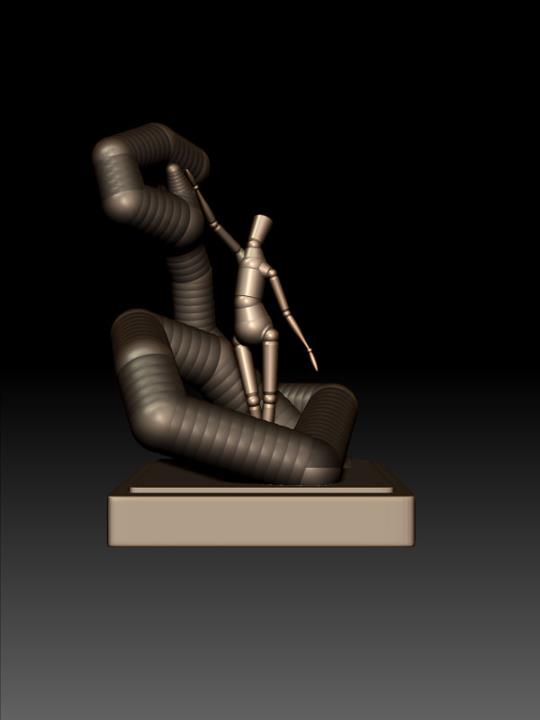

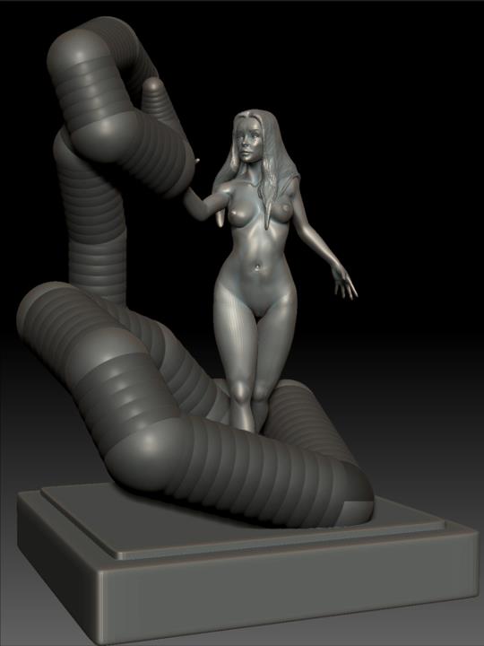

Conceptualize with Mannequin

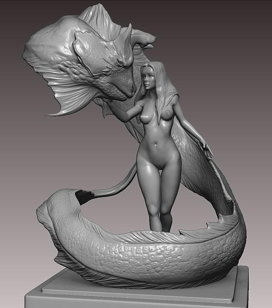

The very first steps we, My girlfriend and I, did was roughing out the form of which we want the final pose in order to gain a proper space/composition of the piece. The best way I found out was to use the well thought out feature, Mannequin --which is highly under-rated. I in fact did several form sketches and finally settled with this pose. The human figure’s the one in ZBrush pre-installed asset. The Water Dragon’s made crudely with ZSphere just to fulfill its need as a design sketch.

For the lady of Naga, I utilized DynaMesh feature to convert the form and sculpted non-symmetrically. The nature of DynaMesh allows me the freedom to sculpt. Small parts could be added in easily without restriction.
The Naga:
The Model of Naga followed the same method used for sculpting the Lady. As the piece will be printed out at a fairly large size (24" in height) I started to plan where to cut the models apart. With DynaMesh and Slice Tool, this can be accomplished easily.

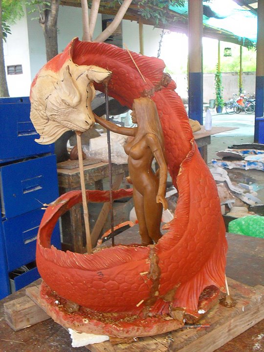

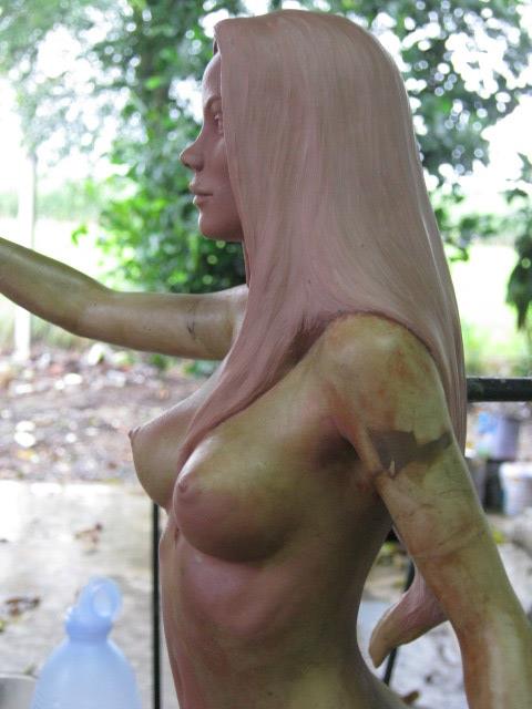

The model’s printed out and surface refined further with wax.
@magbhitu
Thank you very much. I think one of the most rewarding part about Bronze is its ability to hold such wide range of Patina so we could express just the tone we want. Really glad you like it.

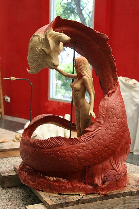

Wax work prior to Bronze casting:
The Process we employed was Lost wax, for that we had to create silicone mould for the parts, and then the finalized wax version’s produced. Then it’s the task to do the final fine tuning work on the wax to progress further for Bronze casting.

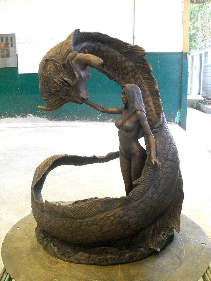

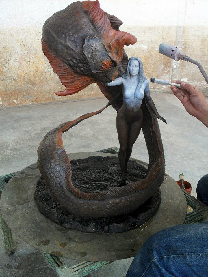

Once it’s cast in Silicon Bronze, the pieces were conjoined together once again and some Bronze refinement process begins.
Patina work’s laid down with the basic tone / Generic Bronze prior to finalizing the patina to my liking.

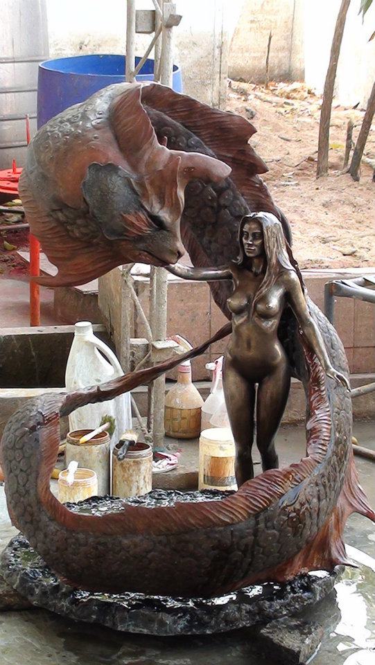

Patina #2:
More Patina continues

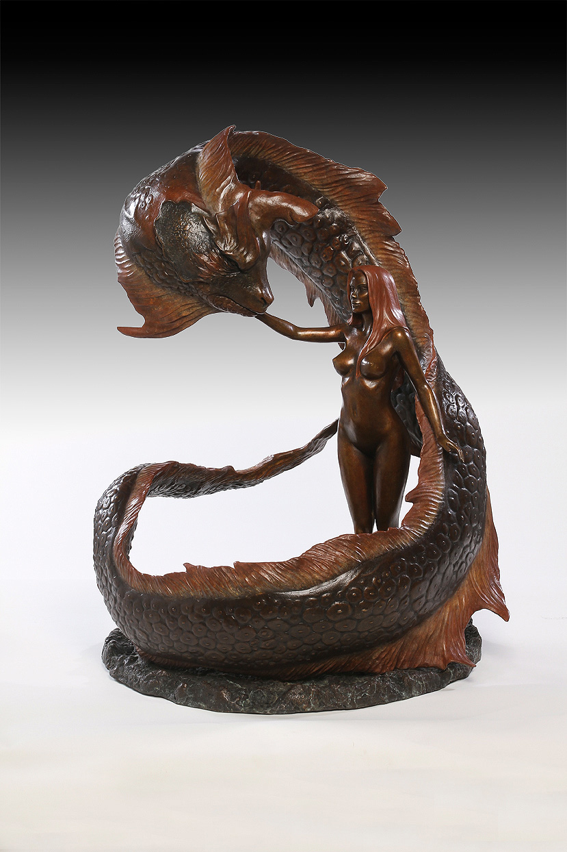

The Final Patina:
Meanwhile, my Girlfriend took the Naga ZBrush model and continued to create another Art Print for the event. The painting’s then Giclée onto Hahnemuehle Fine Art Canvas at 36" x 55"
Both pieces will be on Exhibition this February in Bangkok Art Exhibition, Thailand. I’d like to thank Pixologic for creating such a wonderful software with the ability to decimate the work to be output in physical world. Extra thanks to my Girlfriend and my Mother for supporting us during the course of creating these. Finally the Bronze foundry for the great service even during the time of Mega-Flooding in Bangkok.
