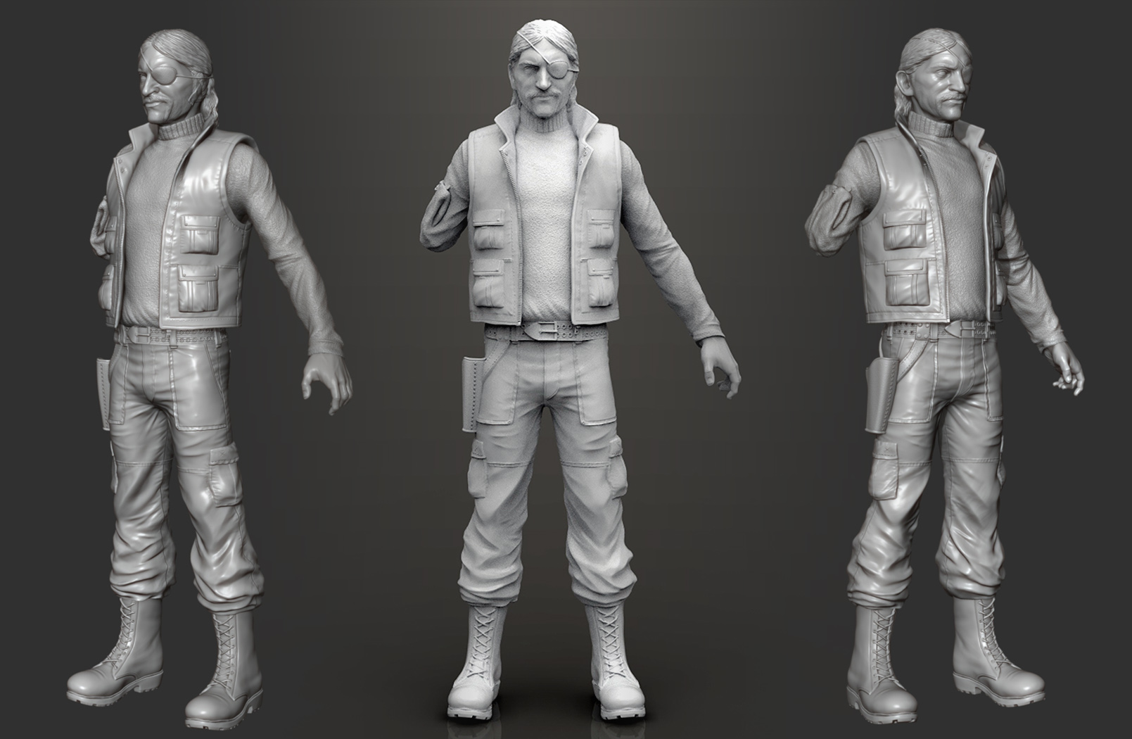

The Governor I digitally sculpted for McFarlane’s Walking Dead Comic Book series.

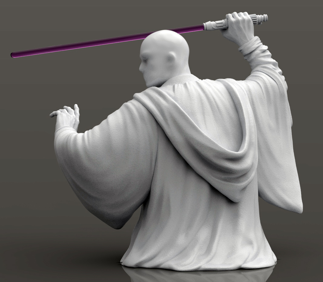

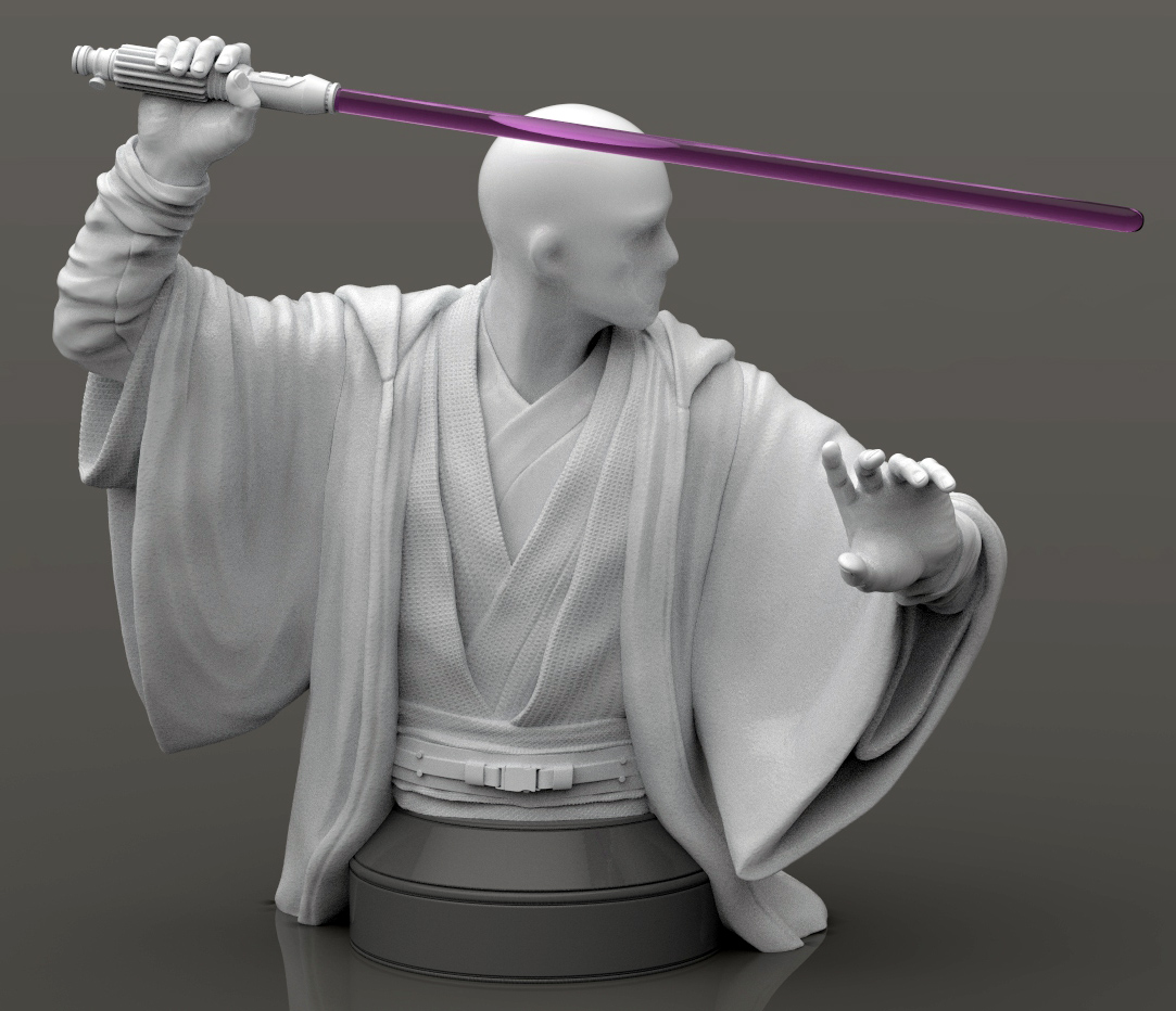

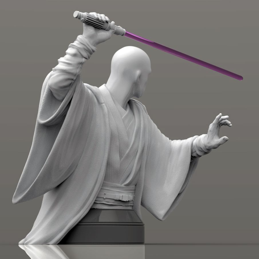

Mace Windu for Gentle Giant LTD. I digitally sculpted what is shown here and Mr. Will Harbottle put the final touches on it for production in house. Character and images copyright by their respective owners and used for portfolio purposes only.
