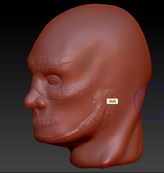

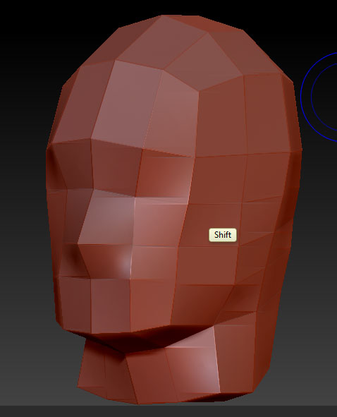

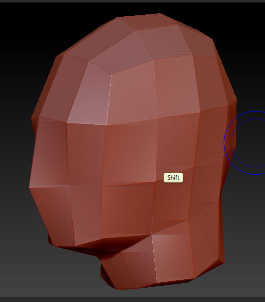

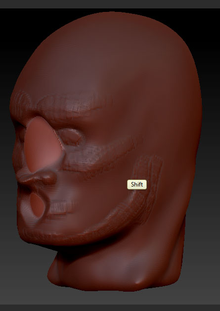

OK, perhaps I’m missing something.
I start with a base mesh…
What am I missing?
Hello Gordon
Just add a subtool to your head so that you will have Project All active. Don’t worry about what you add because you will delete it when done. :slight_smile: When you import the new mesh and yes the result will be the same. All you have to do is undo once and then change your PA Dist slider and import again.
Keep playing until you get the right setting.
Let me know.
Paul
