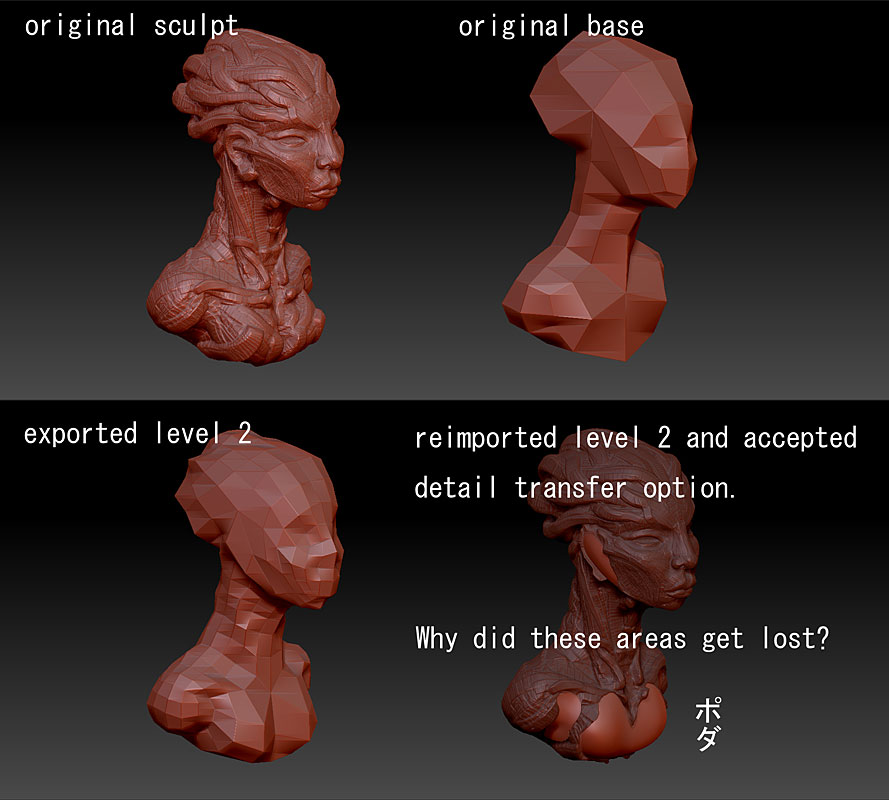

I tried this and ran into problems. Any idea why?
Simple.
You chose to export you’re mesh at level 2, when you are supposed to export it from level 1.
If you want to do an export at level 2. De-Subdivide down to level 2, and press the “Delete lower subdivision” button. Then export/import.:wink:
Also take note that if you are doing a GoZ like operation of export and import from ZBrush>3ds Max>Zbrush. The only problem that stands in all ways is that it does not preserve you’re polygroups upon re-import into Zbrush.
