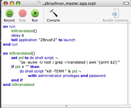

This does the ‘kill translated for you’, and then a delay, then it tries to open Zbrush. You can mess with it all you want. NOTE: You must type your system password (root) each time. I didn’t think it fair for me to provide something that might control your system. I’m also giving the script, you must save it, name it and care for it. Make sure you save it as Application Bundle!! Or it will not be Uinversal. I’ve modded this from results of several scripts for about 6 applications trying to run under Intel, it still needs work, but…

on run
killtranslated()
delay 6
tell application “ZBrush2” to launch
end run
on killtranslated()
set pid to do shell script ¬
“ps -auxw -U root | grep -i translated | awk ‘{print $2}’”
if pid ? “” then
do shell script "kill -TERM " & pid ¬
with administrator privileges and password
end if
end killtranslated
I got this on my first try.
Sntax Error.
Expected “then”, etc. but found unknown token.
just pasted it into the script editor and hit run.

Try this…

A note: some people have had a few character change issues, so I’ve tried to make it clear…
I’ve also attached a Script Editor file…
