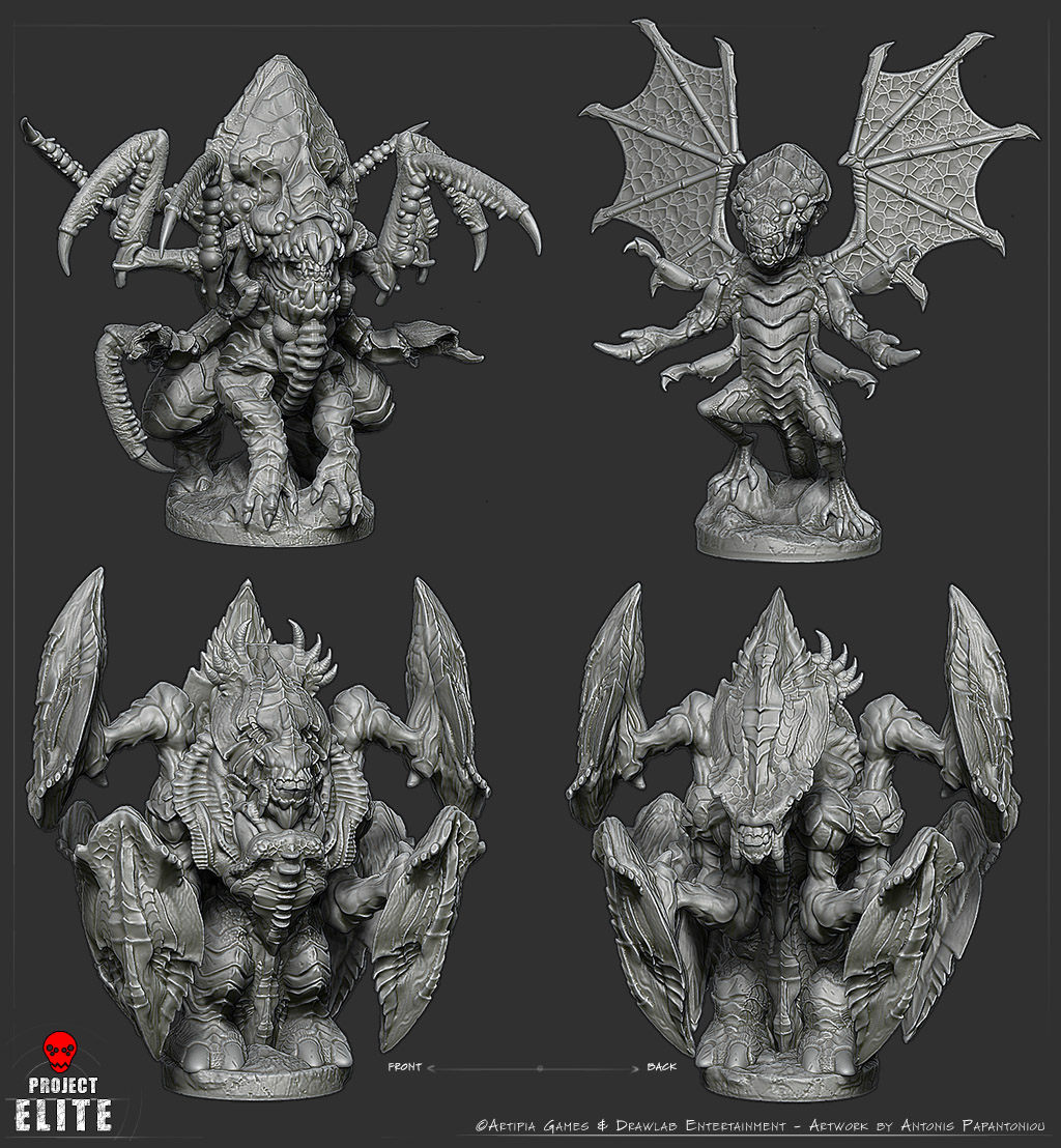

050 MegaBoss
Minis of alien megabosses for the realtime, miniatures boardgame Project: ELITE by Artipia Games and Drawlab Entertainment.
Modelng, sculpting, bashing, in Zbrush. Created for mass, plastic injection moulding production.
These are to be produced as multi-part miniatures of perhaps 4-6 parts (limbs, wings, claws etc).

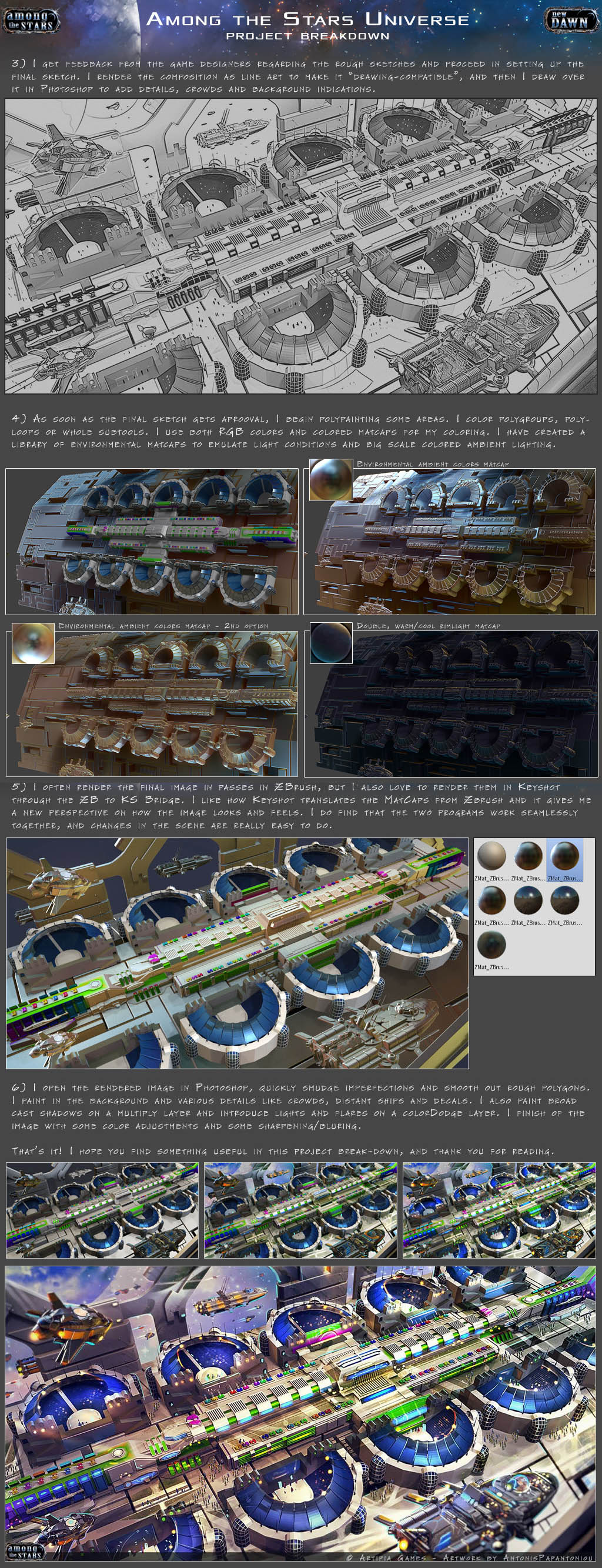

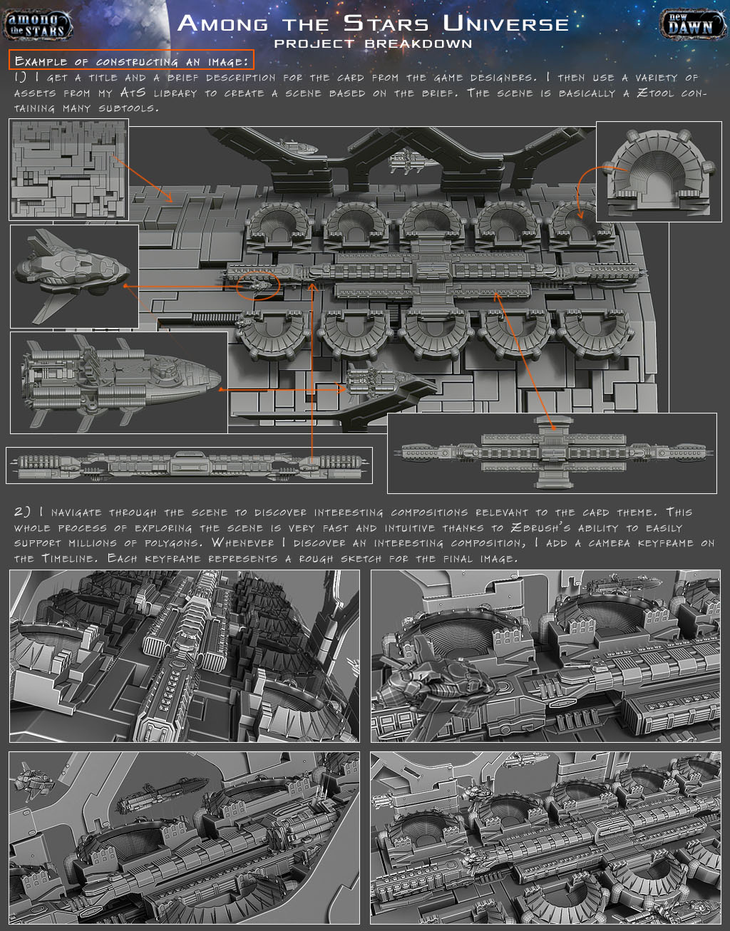

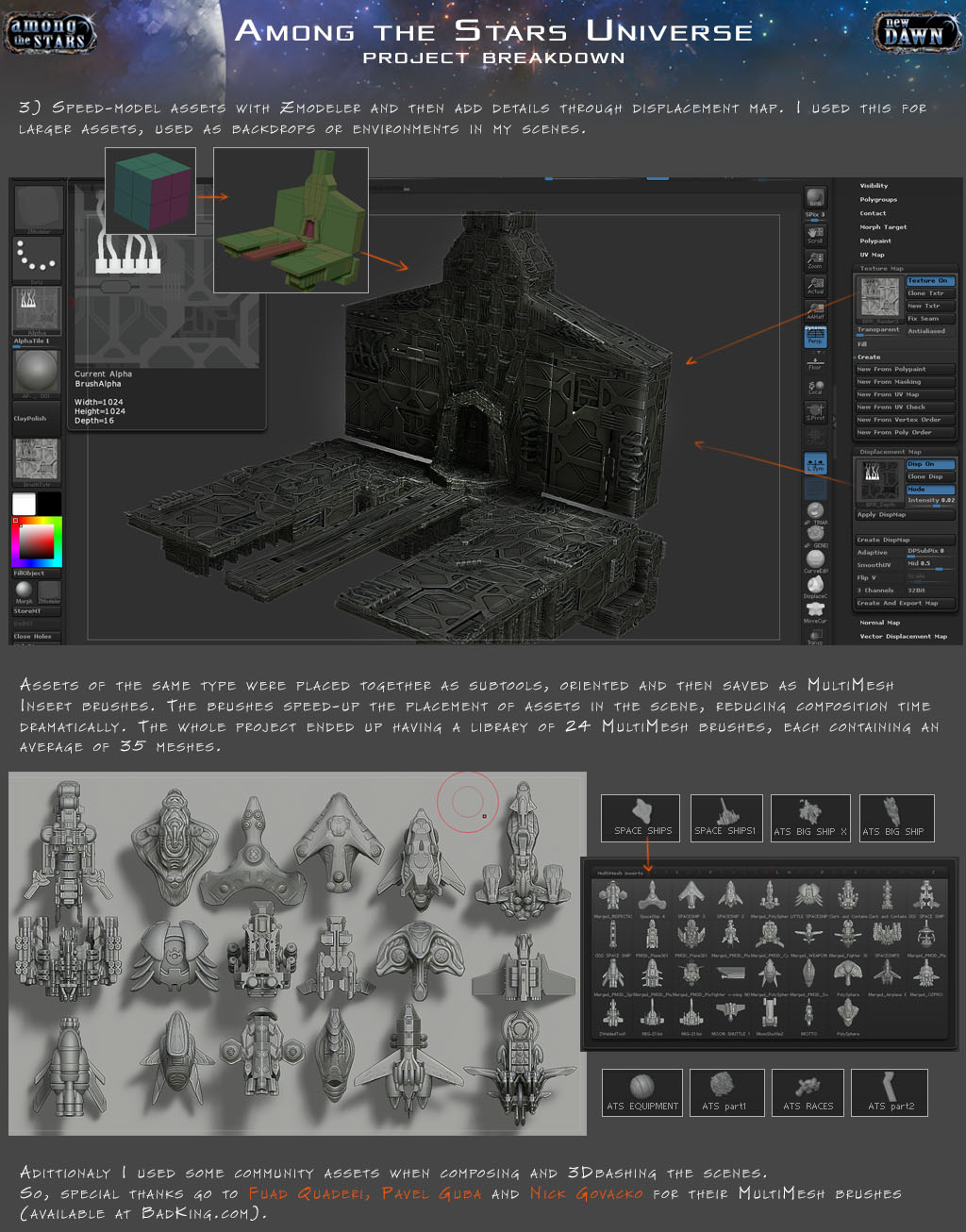

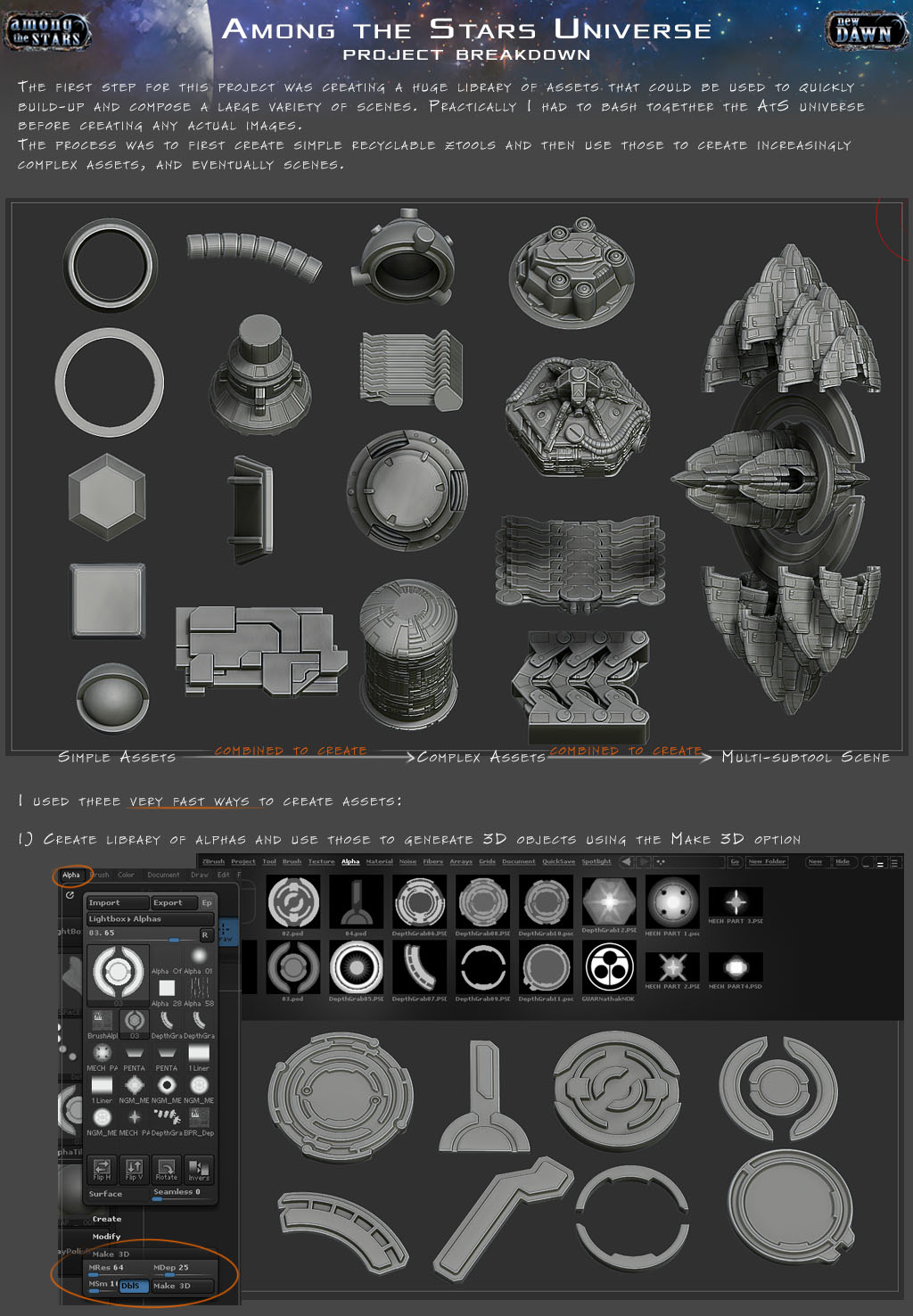

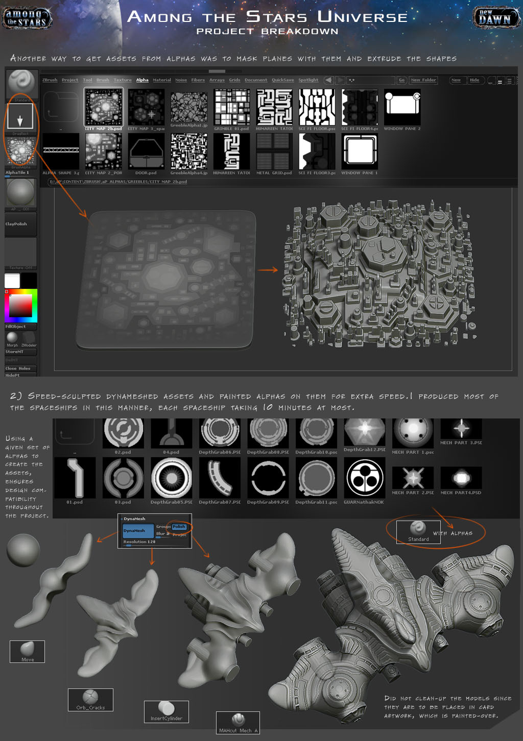

052 ATS Universe Project BreakDown
After having done dozens of card images for the Among the Stars game, I have developed a process for super fast production times.
Here is a complete project breakdown.
I hope it will be helpful and useful to some of you people
That is so cool! Thanks for the break down.
You’re very fast - that’s amazing!

The restrictions on modelling for injection molding and the methods you use to get around that are pretty interesting. Sounds pretty nightmarish if you dont have a way to deal with it!

nebular, ][-][4Z4R][)), Lexxx69 :Thanks. Speed is definitely not linear for me when working with Zbrush. It begins with asset creation and at that stage I just work on faith, because my workday is going by and I dont have any finished piece to boost my morale
The first time I tried this process I got pretty desperate, thinking that I was not going to make the deadlines. But once the library of assets begins to take shape, speed goes up exponentially, and suddenly you are ending up the day with two or three images. The process of creating these images adds more new assets as a bi-product, and suddenly the image output goes up to four images per day (at this point, clients are ecstatic and confidence goes up to the roof). At the same time, the library ensures that there is stylistic compatibility within the project, because each image shares forms and elements from the same pool.
Mahlikus The Black: Thank you! Also, the brushes you have shared with the community are GREAT! They were one of my main tools in this project.
TanTeckWeng: Thank you for reading through my Project: Elite (pg 8 on this thread). The restrictions on sculpting for a mass production product (especially when the final product requires no assembly) are huge. Without those methods of having live feedback concerning undercuts within Zbrush, it would not be viable for me to do the project at all. The alternative would be to work on blind and constantly go back and forth to a software that detects and shows undercuts. Another alternative would be taking a crash course and then doing the whole project on FreeForm 3D (which costs 25-30,000$). Those two litle tricks in Zbrush totally saved the day, and once you get used to working with this kind of matcap, the process becomes very fast, intuitive and even preferable to a far more expensive software.

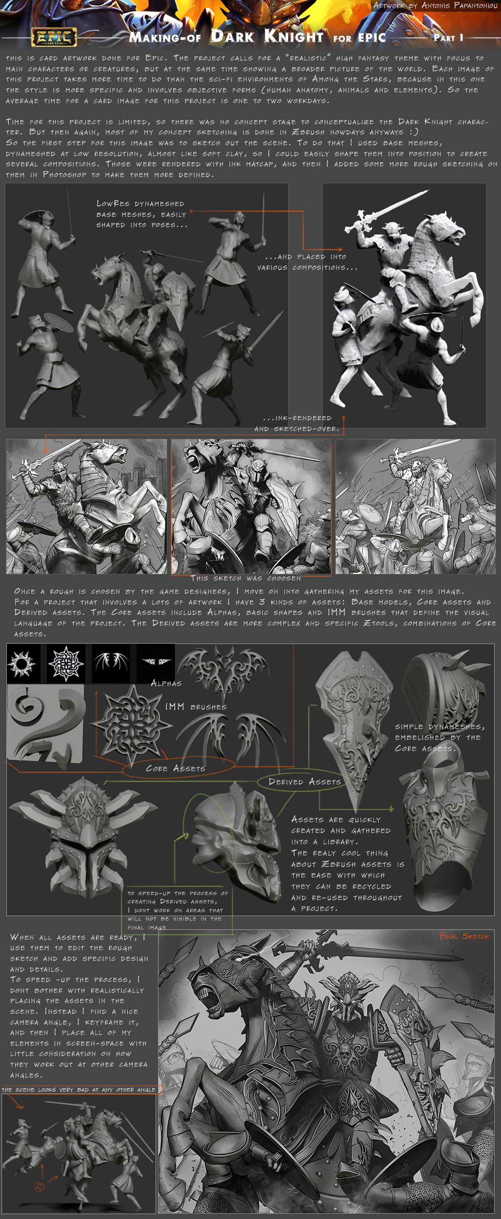

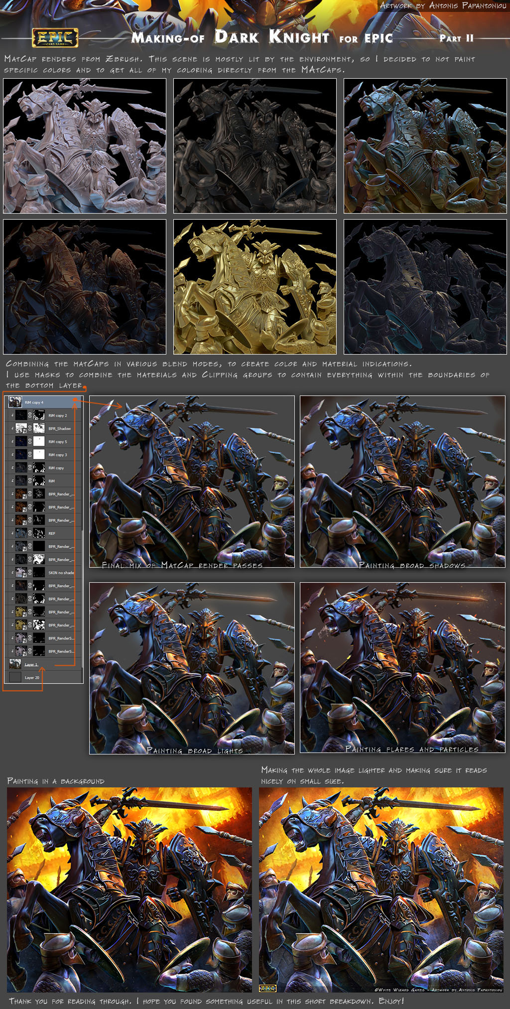

Mostly 3D bashed together in Zbrush. I also speed-sculpted over existing 3D assets to exagerate their form. Render in Zbrush. Paint over in PS.
…and here is a quick breakdown

Thanks for the breakdowns.
