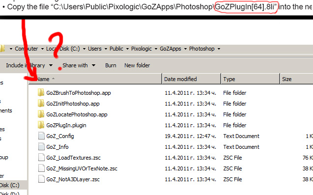

i can’t install it :frowning: for Photoshop ,
there is no files called “” GoZplugin64.8li ? or GoZplugin.8li "in the archive folder pixologic\gozapps\photoshop\ …

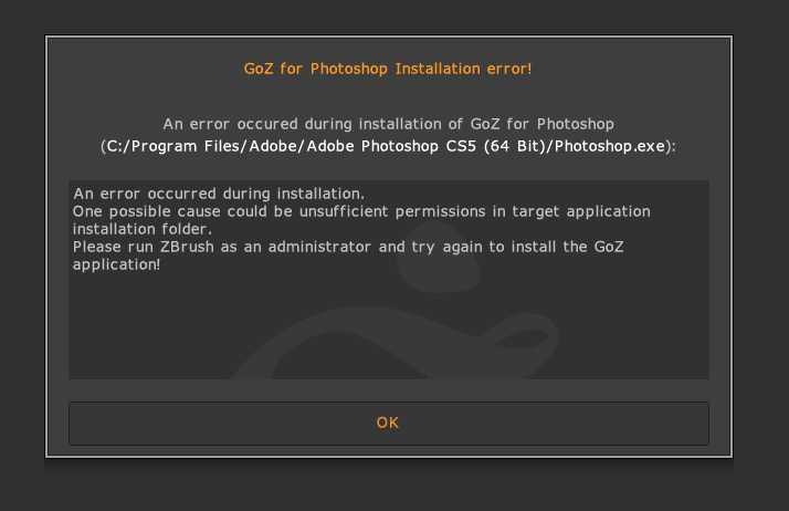

[error.jpg[/attach]–>%3C/font%3E"]](http://%3Cfont%20color=%22#9A9A9A%22%3Eerror.jpg

thanks Totyo ,
but i have a problems with the standart instalation
i run zbrush as administrator , but when i start to instal goz for photoshop this message is shows :
i think the problem comes from this two missing files that i mentioned above :frowning: this files is missing in the archive too
