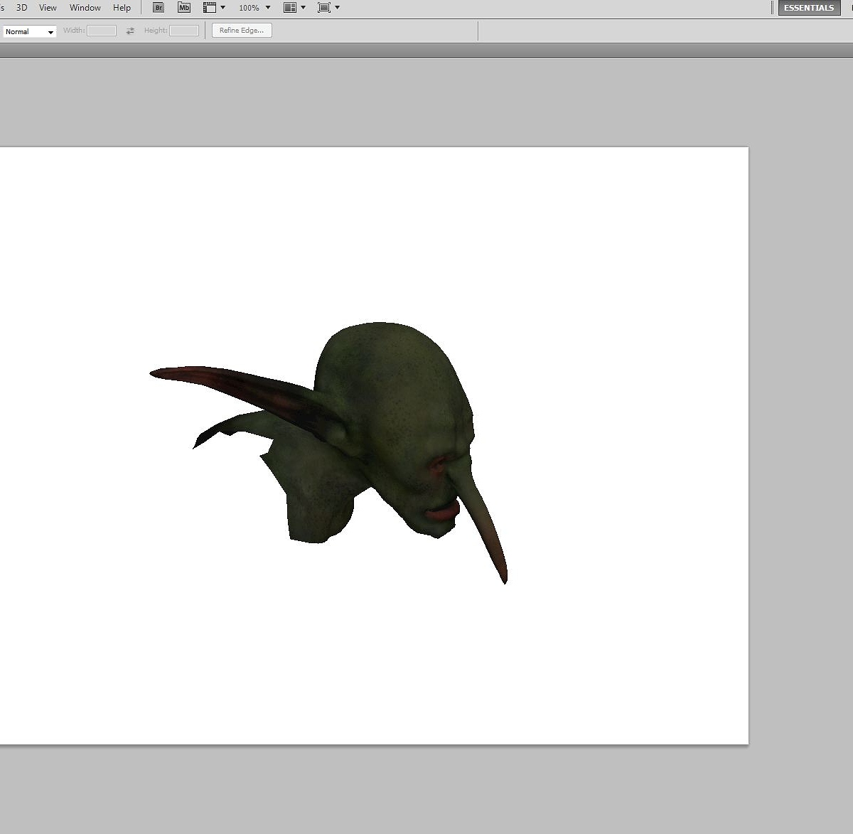

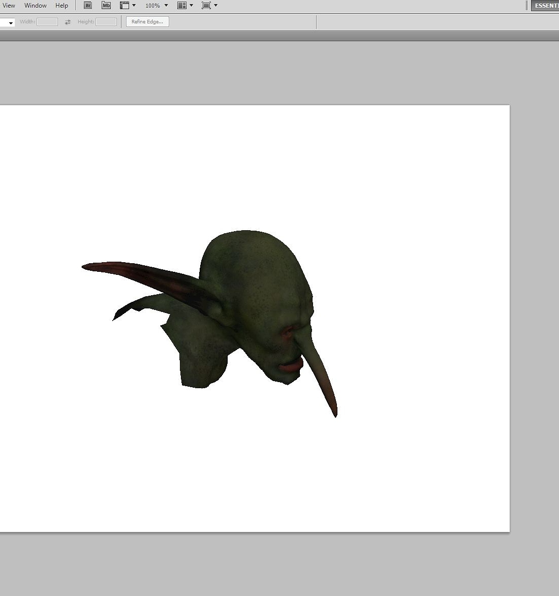

now all is fine :slight_smile: the plugin is awesome !!! but i have one question when i rotate the model in Photoshop the white background goes off . :frowning:
I look at the video tutorial from the zbrush site and there has no such problem when rotate model :frowning:
if you can help on this
Thanks

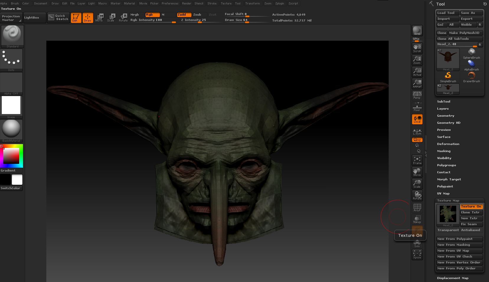

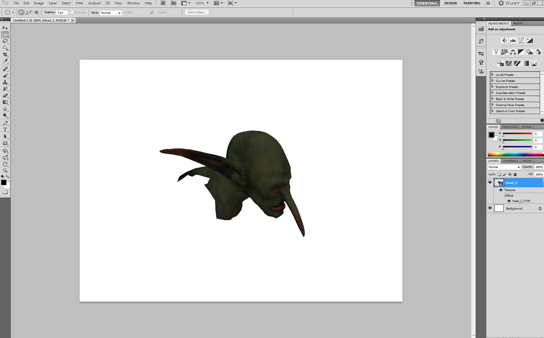

How come when I hit GoZ for photoshop it doesn’t open in 3D mode all I have is just a picture of my model that i can draw on…when I hit GoZ in photoshop - in Zbrush it says that it couldn’t export cuz it wasn’t a 3D layer…Am i doing something wrong? How do I make it appear as a 3D layer? Did I install it wrong or is it a glitch?
The install pdf says your model has to have uvs and you must apply a texture to it (it can be blank). Try that if you haven’t already.
yeah I am using CS5, I have UV’s and a blank texture applied but when I hit goZ…it just throws a picture of the model on the regular photoshop canvas not in the 3D canvas…I don’t know how to actually get into the 3D canvas…since I have never used that feature before.

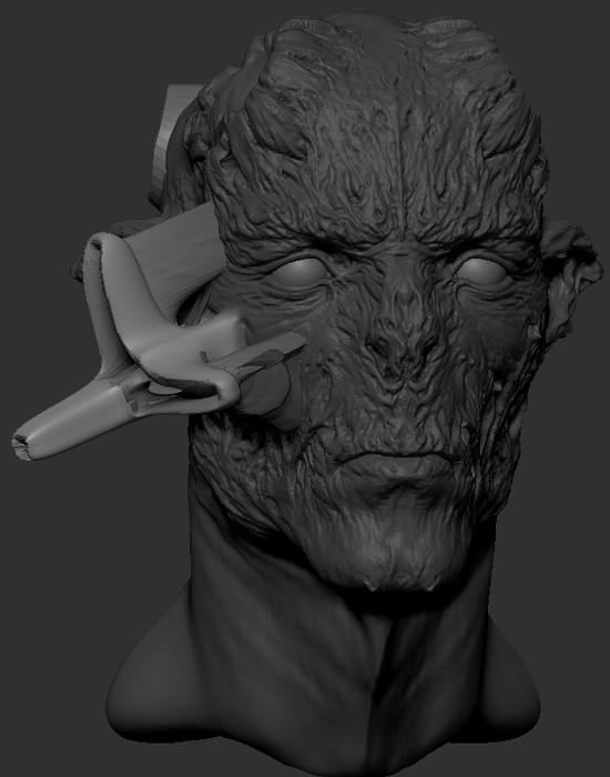

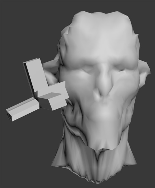

I’m sorry but am I the only one who’s finding GoZ pretty much useless when it comes to ZBrush<->3DS MAX? Looks like it’s only good for adding extra edge loops to the models that aren’t that complex.
Here’s how it works here:
Clicking GoZ in Zbrush.
Adding extra geometry to the mesh like this:
Clicking GoZ in MAX
Getting something like this in ZBrush:
Please tell me this is something on my side. I get this kind of stuff on every model I have here. It was happening with the first version and it’s happening now with the latest.
This is what Happens to me :confused:
Hey Arthur,
In Photoshop, on the left hand side (your Tool palette) near the bottom you should see two icon (tools) that have a looping circular arrow on them. Clicking the first one should allow you to rotate your model.
