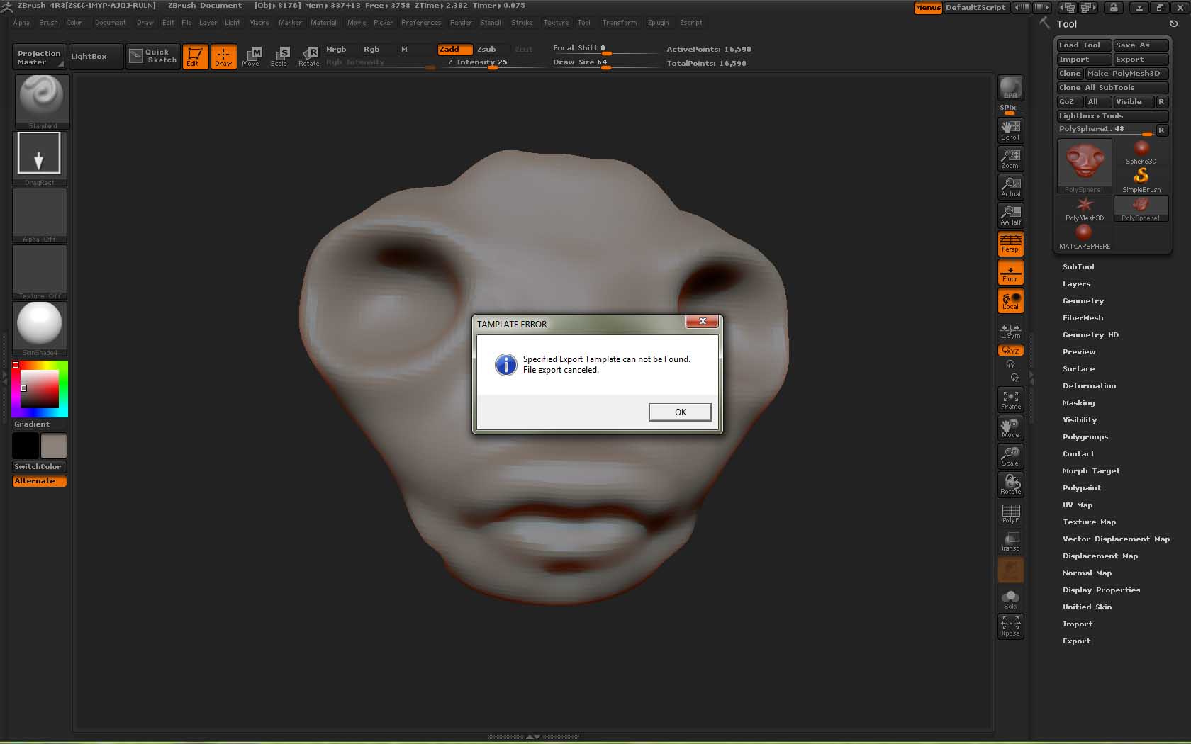

When i hit the goz button i get this error
“Specified export tamplate can not be found
file export canceled”
it works for Maya
I followed the install to the letter. i did it three times with the Goz updated version
GoZ works when i am in 3ds max and send it to Zbrush. i just dont understand what is wrong:confused:

You should upgrade to ZBrush 4R3 which include an update of GoZ.
Try redefining the max path. Preferences/goz/pick the path to max. Hope that helps, goz is great.
:slight_smile:
Thanks Kanga for the suggestion but i did that as well but i tryed it one more time and no luck. :confused:

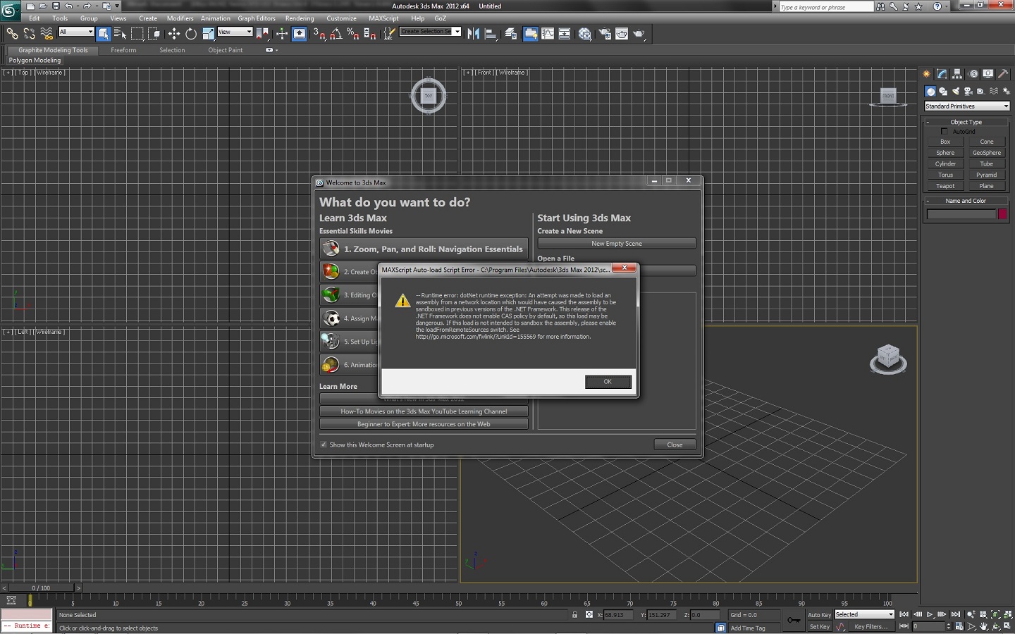

i get this error when i use GoZ to 3dsmax 2012 64
it works when i send it to Maya and Photoshop just not 3dsmax can someone help. I uninstalled and reinstalled both.
:cry:
I am running:
Windows 7 64
Zbrush 4R3
EDIT: Found the solution was to press the little “R” button next to the GoZ buttons. Hope this helps others in the future
