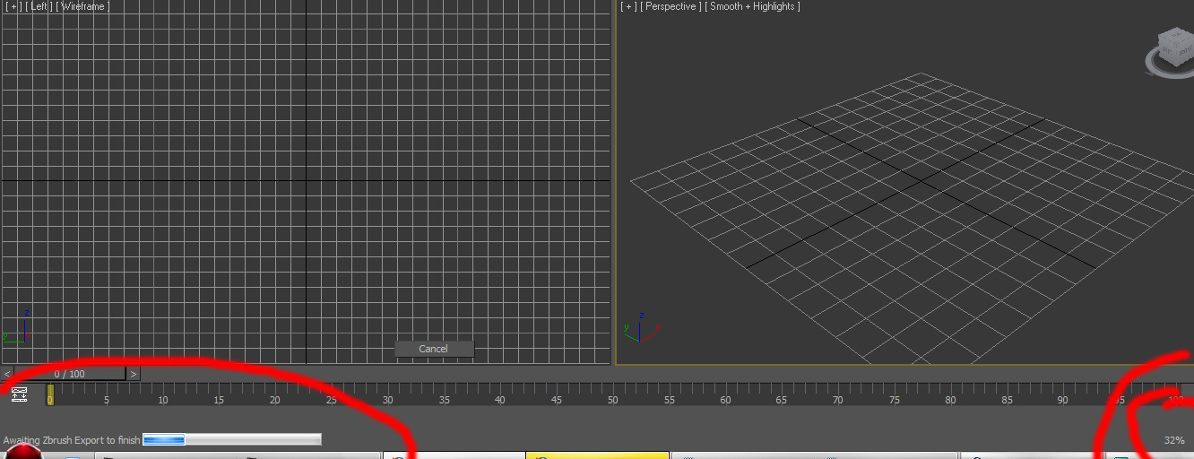

Hello! I install script.But when i push button “from zbrush” i see next:
and this continue to endlessly.
Then when i push button “to zbrush” nothing happen
I don’t know, could a couple of things. Do you have a ztool selected in zbrush? Does zbrush give you any error message? Does zbrush window maximize at all? If you could please provide more details, maybe I could help you out a bit more :wink:

Hello Norman3d!Yes zbrush window maximaze,no error meseges,yes ztool selected in zbrush
Norman3d.It’s video with my problem:
http://www.youtube.com/watch?v=E9Ux0oEqtXw
Maybe zbrush import/export?
Could you try installing GoMax again? Do you see a GoMax_Export and a GoMax_import under “Macros” in Zbrush?

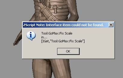

gettin this message…what am i doing wrong please help…
how can i uninstall GoMax?
I don’t think you installed GoMax properly do you have a
ZStartup/Zplugs/GoMax.txt ?
In order to uninstall drag and drop the mzp file into the max viewport and select uninstall.
thanks for the fast reply …i’ve reinstalled now it works like a charm :slight_smile:

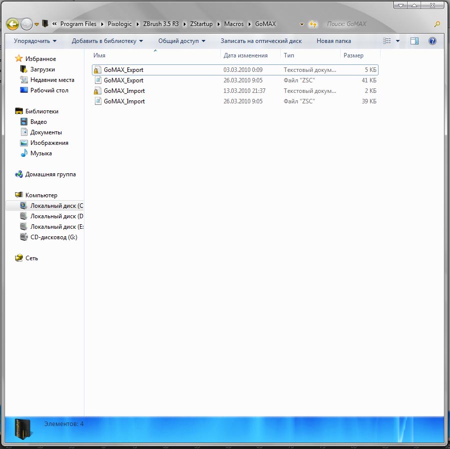

Hello Norman3d! In “Macros” zbrush next files:
Intresting files txt with lock.It’s normal?
Yes! It’s normal! Could you do me a favor? In Zbrush, go to Macros, GoMax and hover your cursor over the buttons and let me know, if there is a hotkey assigned to them.
yes it is…alt+shift E and R
I know it is. I’m asking foxmax, I suspect maybe he is having some trouble, maybe due to the russian characters.
