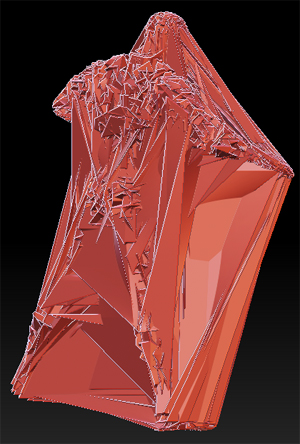

first of all, amazing job. i’ve done a bunch of tests on simple objects at home and it seems to be working great.
at work, i’m having the same issue with each release. my manual obj exports from max into zbrush work perfectly, but GoMax gives me this:
does it not use my saved settings in the obj exporter?
What 3dsMax version do you have?
max 2009 64 bit
And what version of ZBrush do you have? 3.5 R3, right? It’s quite strange that the mesh is exploding if it’s Zbrush 3.5 R3, since it should detect a new point order (in case the vertex got messed up), and import it properly.
looks like double verts, (each face has it’s own verts), i would try playing with your export settings in max
i’ve seen some weird stuff like this before back when i used wings3d
yes, i’m using r3.
hmm, i might have some insight…i did a quick test exporting this same mesh manually twice, both times with max’s gw:OBJ exporter. once with “relative numbers” checked and once with it unchecked (how i always export). the relative numbers mesh was exploded in zbrush. i never have this option enabled in my export settings, but am i correct in assuming that goMax is enabling it somehow upon export?

MattSilverstein: Only in maxscript 2010 can we set the export settings, however it SHOULD use the last settings put into gwExporter so your last successful manual transfer (import and export) will determine which settings you will get.
I nearly forgot about this issue in earlier versions, I will put in a option to have the dialog open when exporting and importing so you can set the settings yourself. You should then only need to do this once and can then turn off exporting with dialogs.
