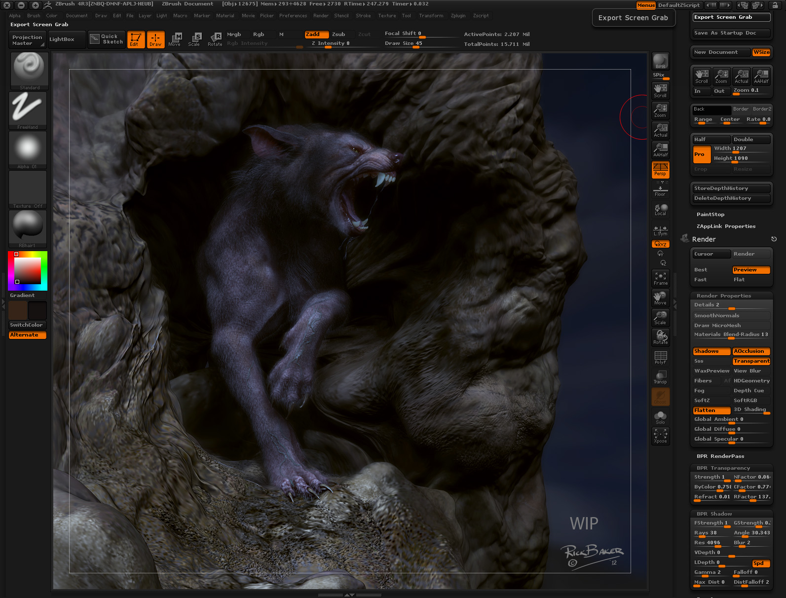

Working on this some today I got the beginnings of the cave to work. I did a quick render just to see how it looks and I have to say I’m impressed with what you can get right from ZBrush. I thought I would post a screen grab show the render settings and also how it looks with no post work in PS(but I did put my name and wip in PS.
Can’t figure out how to not have the document settings in the shot. First try it was right over the image . This time on the side but moves the render settings down. I pretty much used Maxter’s transparency settings.
I was going to try spotlignt on the cave but can’t seem to get spotlight to work so I quickly polypainted it. I was able to add images to spotlight and but when I turn on the circle thing ,it is transparent. The little icons show up when I mouse over them but when I turn on RGB and zadd and paint over the image it just paints black. Any ideas what I am doing wrong?
Anyways still a work in progress. I want to make the cave thing better add some roots and maybe a little dead grass and a BG rock formation.
