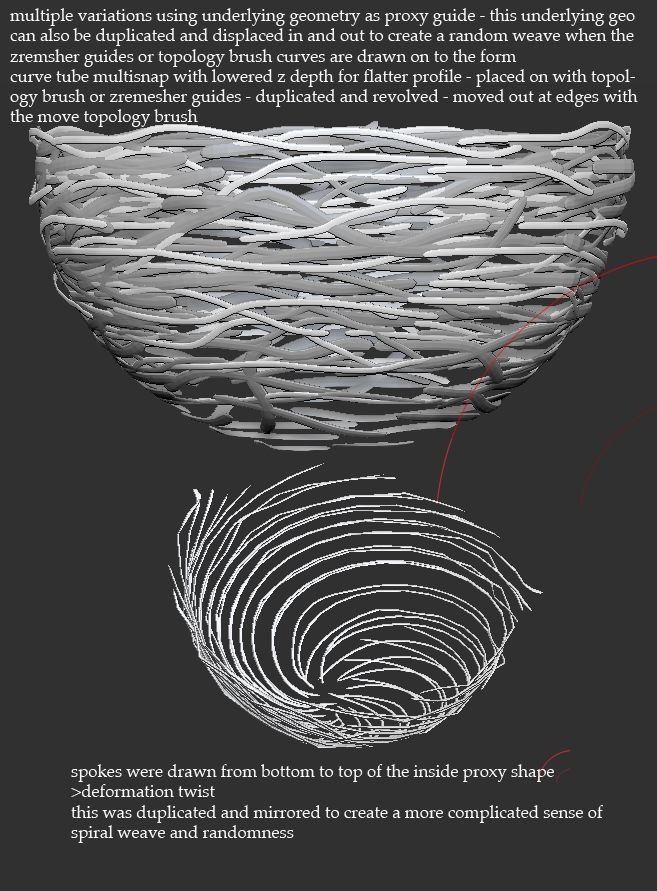

Creating A Bird’s Nest In ZBrush Using Curves. A recipe.
Curve Multi Tube (with snap switched on in strokes>curve) with a lowered z depth for flatter profile was used for the main construct of the nest - curves were drawn around the proxy form with the topology brush or zremesher guides. The advantage of the Curve Multi Tube brush is that it will draw out all the geometry over all the visible curves at once with one click. The created geometry was duplicated and revolved - moved out at edges of the nest’s curve as well as woven with the move topology brush.
NB: That curve tube multisnap does not allow for size tapering at the curve ends - of course you can taper these manually using the smooth brush etc. To allow for automated tapering of curve (curve modifiers size , curve falloff) use a brush such Curve Tube Snap instead.
A torus was used as a proxy shape at the top of the nest - this used Curve Tube Snap which does allow for a size taper but not to all visible curves simultaneously - instead each zremesher curve was tapped - then press 5 - then tap the next drawn curve etc around the proxy torus.
Spokes were drawn radiating out in straight lines from bottom to top of the inside proxy bowl/nest shape using used curved tube snap . Next >deformation twist was applied to give the spiral weave effect .This was duplicated and mirrored to create a more complicated sense of spiral weave and randomness throughout the nest.

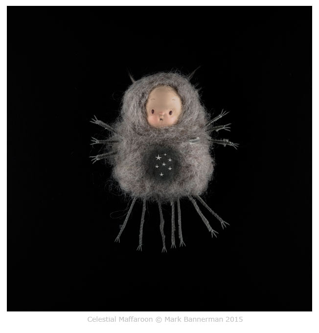

Some collaborative work with a friend Julie Hannah who kindly accepted my commission to fuzzily fabricate the core essence of my ZBrush designs in felted wool. The project? Sleeve illustrations and illustration inserts for a music cd for the Scottish song writer and musician Tom Baird for whom creating an intimate collections of creatures with stories of their own always feels appropriate .
Buffered Maffaroon
Tootle Faced Maffaroon
Langside Maffaroons (Tusked and Tato)
Sparkle Maffaroons
Ascending Maffaroon
Celestial Maffaroon
Floating Maffaroon
After photographing the designs in felted wool ZBrush was used to bring the work to further detail and completion either as complete 2.5D pieces (one of which I posted some time back) or with rendered elements exported out as grabdoc textures or bpr renders from ZBrush and composited in photoshop then brought back in to ZBrush etc.
In keeping with the handcrafted soul of the characters I used Shadowbox - it being a mesh creation method that feels most like free drawing 3d forms intuitively. Fibermesh effects dropped to canvas , using fibermesh for grabbed textures or to make alphas etc to blend with existing elements was used plus many 2.5D techniques utilizing scratch layers in ZBrush to generate media assets on the fly to bring back in to the working layers. To create a greater empathy between digital and real world media all zbrush projects were open but unsaved. To be free from the digital safety net of saving, tools, projects, brushes, alphas , textures etc at the risk of losing work was very much part of the process. In a strange way the greater part of the works preparation had been kicking back and enjoying some real world painting for a couple of weeks prior to beginning the work
