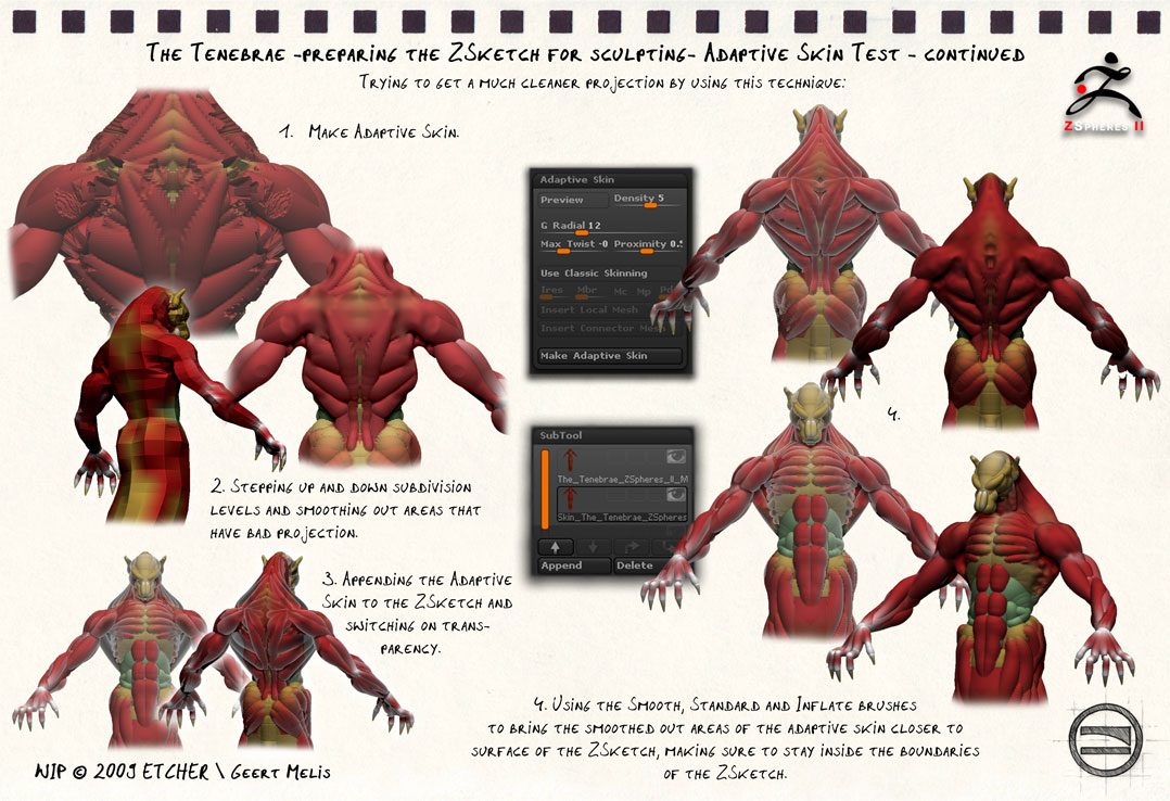

Threetails: that’s great news Cam! I’m so looking forward to see how your initial tests will turn out. I’m experimenting with Adaptive Skins right now, as opposed to Unified Skins to get cleaner topo. I’ll post my findings tomorrow! This new stuff couldn’t have come at a better moment for us!

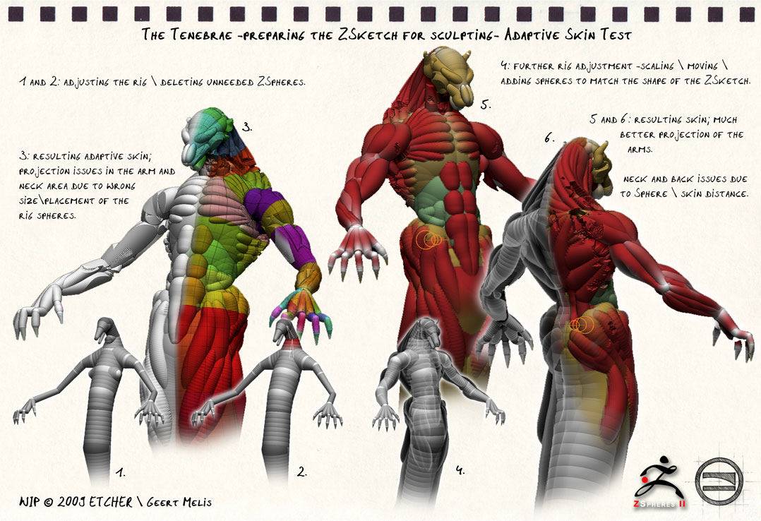

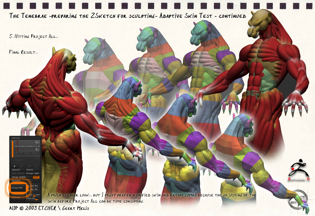

Experimenting with adaptive skinning (instead of unified skinning)– hope to post the results tomorrow!
Hi all! :slight_smile: .
Posting the remaining sheets on my ZII testings.
These sheets are a follow up to the ones I posted a few pages back and complete the testing on the Tenebrae.

Thanks for showing us how you managed to repair the projection issues.I was building up forms and running into the same problems dispite the sub level increments thus dumping my work.Atleast I can move on again…Thats about the 30th thankyou ,now I wonder why your efforts are as yet to be featured on disc for sale.Im assuming your related to Santa Claus…ha ha…Catch you again soon ,cal

Calum5ZB: thanks for the ongoing support Cal! Always motivating for me to read you got some benefit out of the test sheets. I’m still not sure which method works best for me, I think I’ll probably go for the unified skin/retopo combo – we’ll see… .Quote:” now I wonder why your efforts are as yet to be featured on disc for sale.I’m assuming your related to Santa Claus…” such a nice comment! A disc…who knows, maybe some day… .Santa Claus… nope – no relation… just givin’ back to the community!

Thanks Etcher great update, the print out will be a very cool document, funny how it changes its meaning when it becomes real physical object, until then you are just an electron artist. Just bought a wacom so been playing and now after reading your post I’m off to alt shift, and find out why I should press make unified skin or adaptive skin instead of Make a Polymesh3D.
Don’t know if you’ve already seen this but just in case.
Support says: TIP In order to get the most efficient unified skin from ZSketch , try the following procedure…
  1. Set Unified SDiv to zero, and adjust the Resolution slider as low as you can while still getting the major shapes visible in the preview skin.
  2. When done with the above step, increase the SDiv level as high as you need in order to get the fine details visible in the preview skin.
  3. When done, press the “Make Unified Skin”. (Make sure to use the “Make Unified Skin” button, not the Make PolyMesh3D button)
If done correctly, you’ll end up with a low resolution mesh at the first sub division level with high frequency details at higher subdivision levels.
