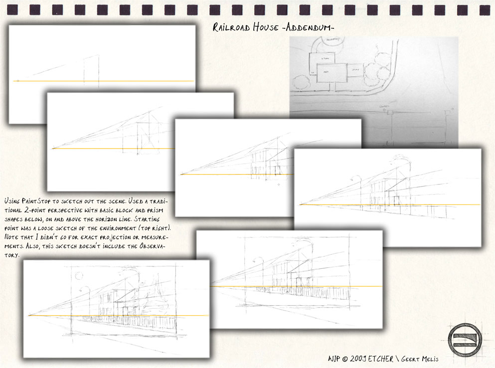

Great character sketches Etcher,also the perspective drawing I like it.
It’s what I like in PaintStop, this immediacy to grow up ideas,and you are really good in these things:)
