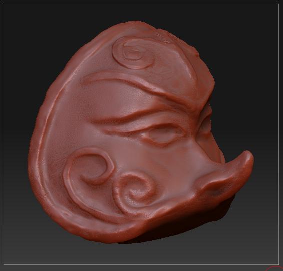

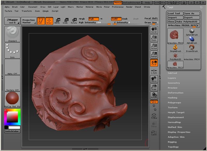

I’d try making some strategie passages … I make a “fasta” retopo and save as OBJ …
Take the mesh (many holes and crazy topology) into ArtCAM and simulate a toolpath, and save that simulation that correct the holes and now in Zbrush I have a good mesh to retopo …
On the photo the “bad” initial mesh …
And the good mesh nice for work on …
Now I have to make a test with retopo by hand, but I'm steel beginning ... easy I'll arrived ...

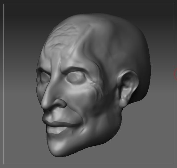

The head that I made into an exersize …
Thanks again … I’m in love with ZBrush … think will make nice thing with it …

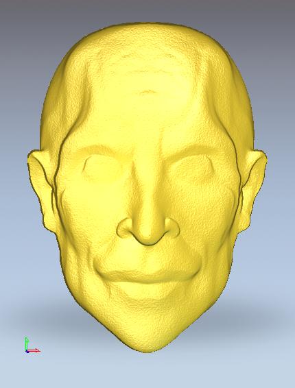

And here an ALPHA of the head to put on a broche/pendant in ArtCAM
