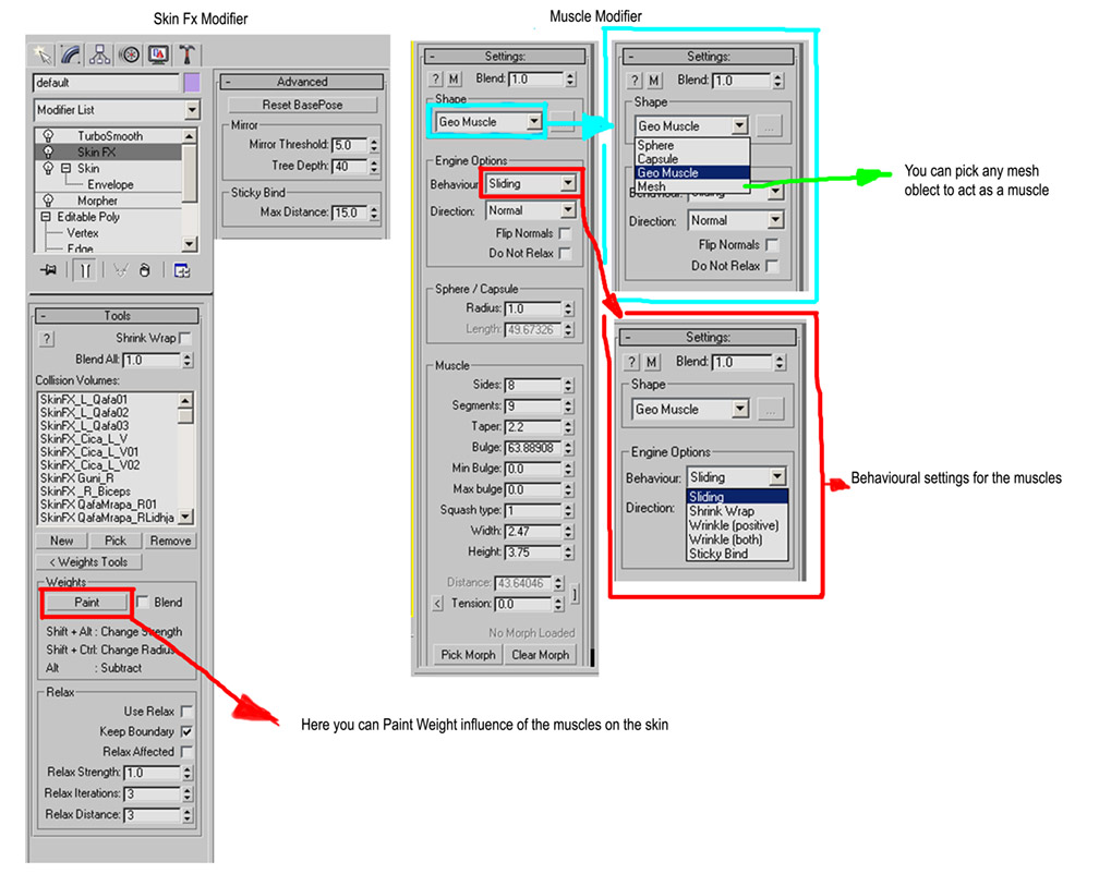

Subnormal:Thank you. Those muscles act more like “Muscle Bones” than splines but they are much more complex than just that. As far as the rigg goes there is the regular puppetshop rigg than some muscle bones for some difficult areas like shoulders and neck so I don’t loose volume, and extra bones for the chest area for better skinning. I hope this explains it.

Longsight: Thanks. You can download Demo versions of both Puppetshop and SkinFx and play with them a little. Below is UI view of the Skin FX Modifier with some small explanations. Obviosly there is much more to it, but I thought this may help a bit to get you started

AVTpro: Thanks. Muscles are done with Skin Fx and that’s a plugin for 3Ds MAX . You probably use Maya since you mentioned TK muscle and I think thats a plugin for Maya not Max. In any case I hope you get to work with muscle system of any kind.

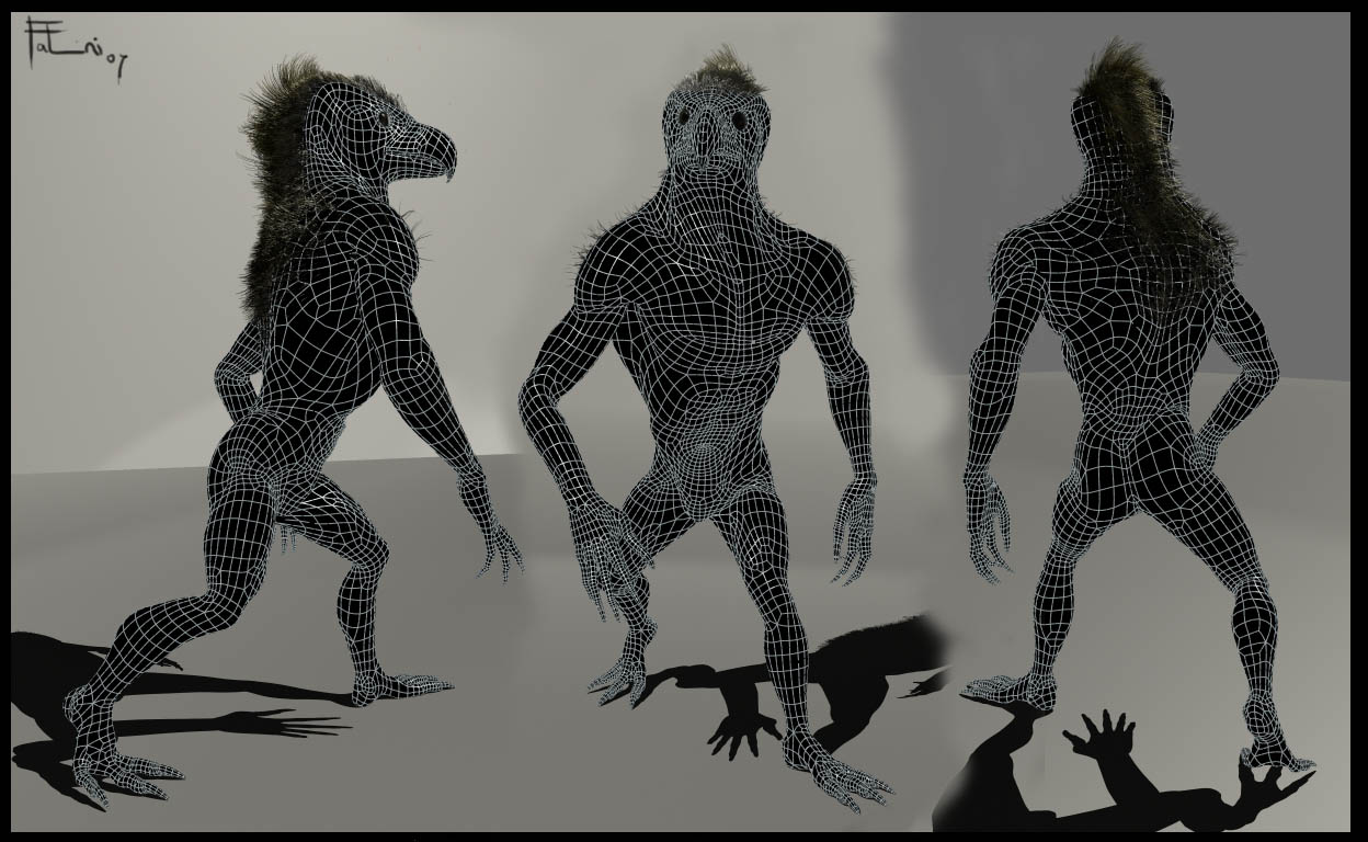

Nibiru: Thanks a lot. I’m glad you like it. Now to answer your questions. Low poly count for the model is 8150 and the high poly number is more than 1.5 milion. Below is the wire of the model. I hope this gives you an idea. Thanks again.
Jason Belec: Thanks for the links and advise. I bookmarked the links and will take a look at them in more detail when I get some time. You noticed quite well that the left side isn’t the same as the right and thats becouse I didnt add flex modifier to the muscles of the left side, but they still deform the mesh. As far as them acting more like fat than muscles I’ll take a look at that and try to fix it if I can . In any case thanks again, you’ve been great help to me with your comments and suggestions.

cool model !! the only thing i culd say is that his upper part is big,compared to lower part. so he would tend to fall down while walking (the quadruped walking mode fits better indeed in this case)
other than that, its an awesome work for sure.

Finally managed to see the walk cycle & it looks great! I dont mind the ‘swagger’, I think it fits the reality that a predator needs to keep his head, (or his eye level) , quite still while walking. What IS a problem is how far the knees must bow outwardly from the body as they pass underneath, this could be fixed by raising the buttocks higher somehow. Perhaps if only the metatarsals were flexible, or the tarsus was longer or the femur shorter? Whatever the fix, this bow-legged gait would clearly prevent the creature (I like ‘Homogryff’ too!) from gaining any sort of speed, at best it could possibly manage a Hyena-like canter. Not so much a problem for an arboreal animal or possibly an omnivore existing mostly on carrion (which the sparsely plumed head and powerful beak would suit perfectly) - it would certainly chase the vultures and Jackals away, but it would need to steer well clear of whatever brought down the carcass!
