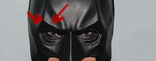

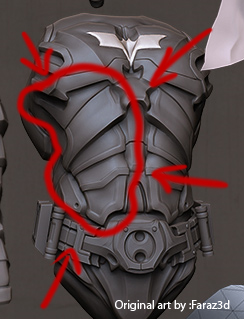

Don’t know if this is the right thread to post it in but was wondering how sculpt stuff as seen in the pictures below?
Read stuff like
for sculpting i use clay,standardbrush with lazy, pinch and flatten brush , but the most is pinch. using pinch with and without alt(zadd zsub) give really different results
But I just can’t seem to make it work.
Anyone got any good tips or like a good video that demonstrates a good technique?
Thanks in advance ! :slight_smile:

there are several techniques for this. you can experiment with the new Trim and planar brushes in 3.5. Use masking to pull out the parts that you want to extrude out.
A lot of people use the combination of flatten with the pinch brush. You need to mask out parts that you do not want to effect and use the flatten brush to flat the surface and then go back with the pinch brush to define the edge. Remember to also try using the ALT key with the pinch brush. It will create a really nice effect.
Paul
i would say its a combination of techniques…but to get such detail (in zbrush alone) I would use projection master and sculpt with alphas.
you can use the mrgbz grabber to create alphas from anything on the canvas.
Then use that to sculpt with in projection master…although you can sculpt with alphas using the 3d brushes I still use projection master for details because it gives more control over each stroke.
then retypo when you have theform right.
you could also extrude polys…
