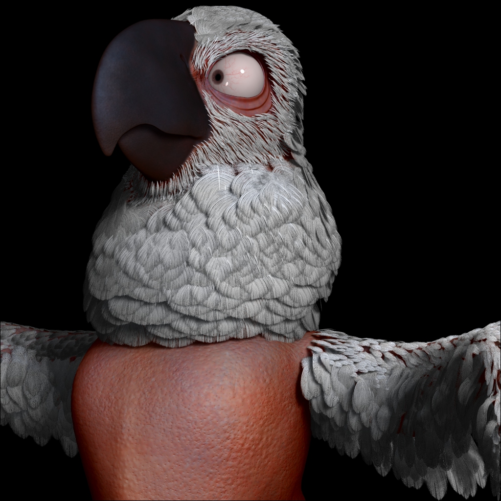

Hello fellow ZBrushers, its been quite a while since I have had a chance to post anything on the forum. Here is a piece I’m working on Nigel the protagonist from Rio; I’ve spent quite a bit of time exploring FiberMesh for creating feathers and this is what I’ve gotten so far. I’m going to work on poses for him once I’ve perfected feathering techniques as always C&C welcome.

awesome detail of fur… keep it up… it would be great and helpful if you would share the techniques how u made the fur…
Very nice, a lot of character in the beaky face. Would also love to see a breakdown of your feathering technique. Thanks for sharing.
Looks great so far … Great expression and the feathers are awesome! :smiley:

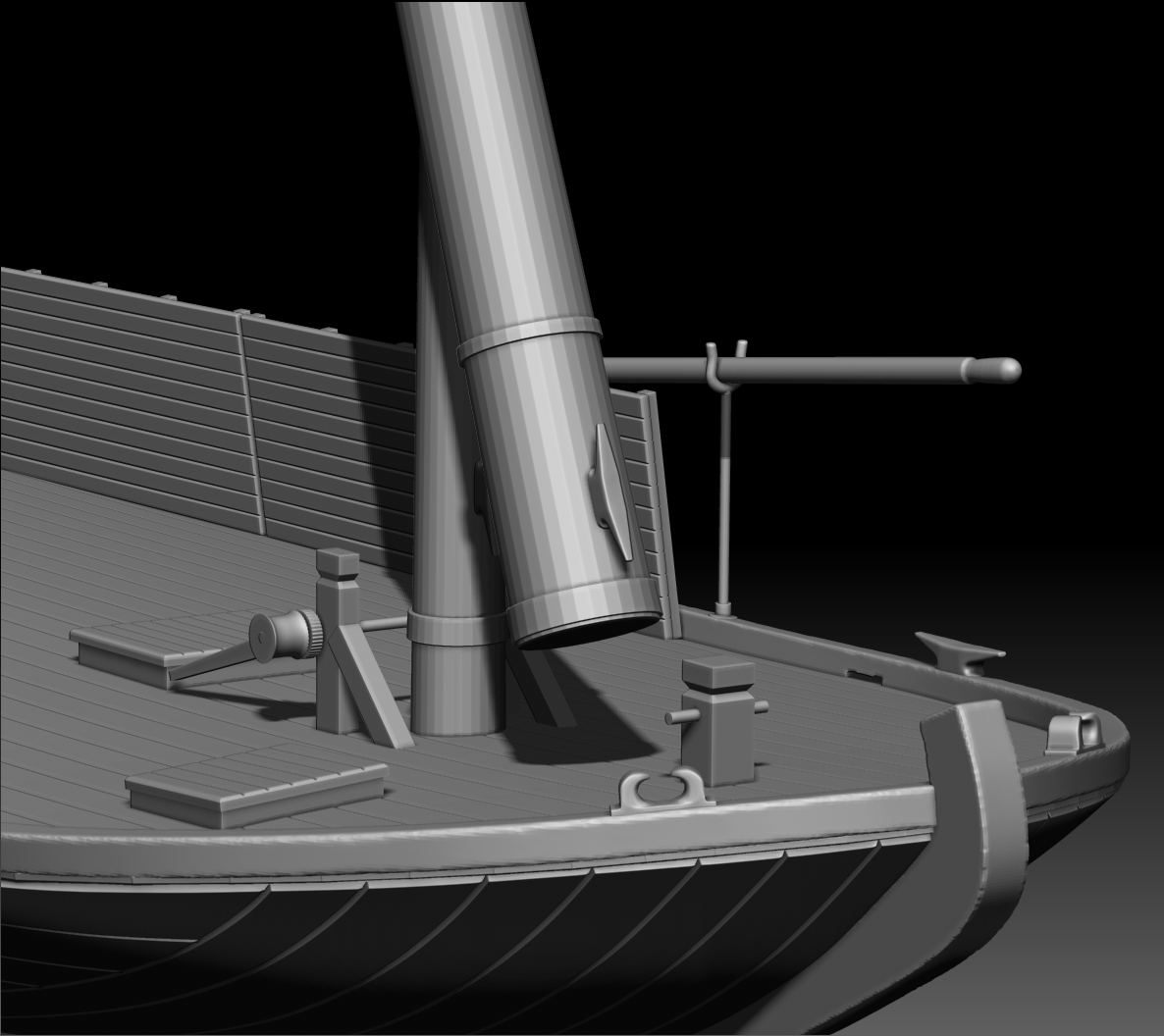

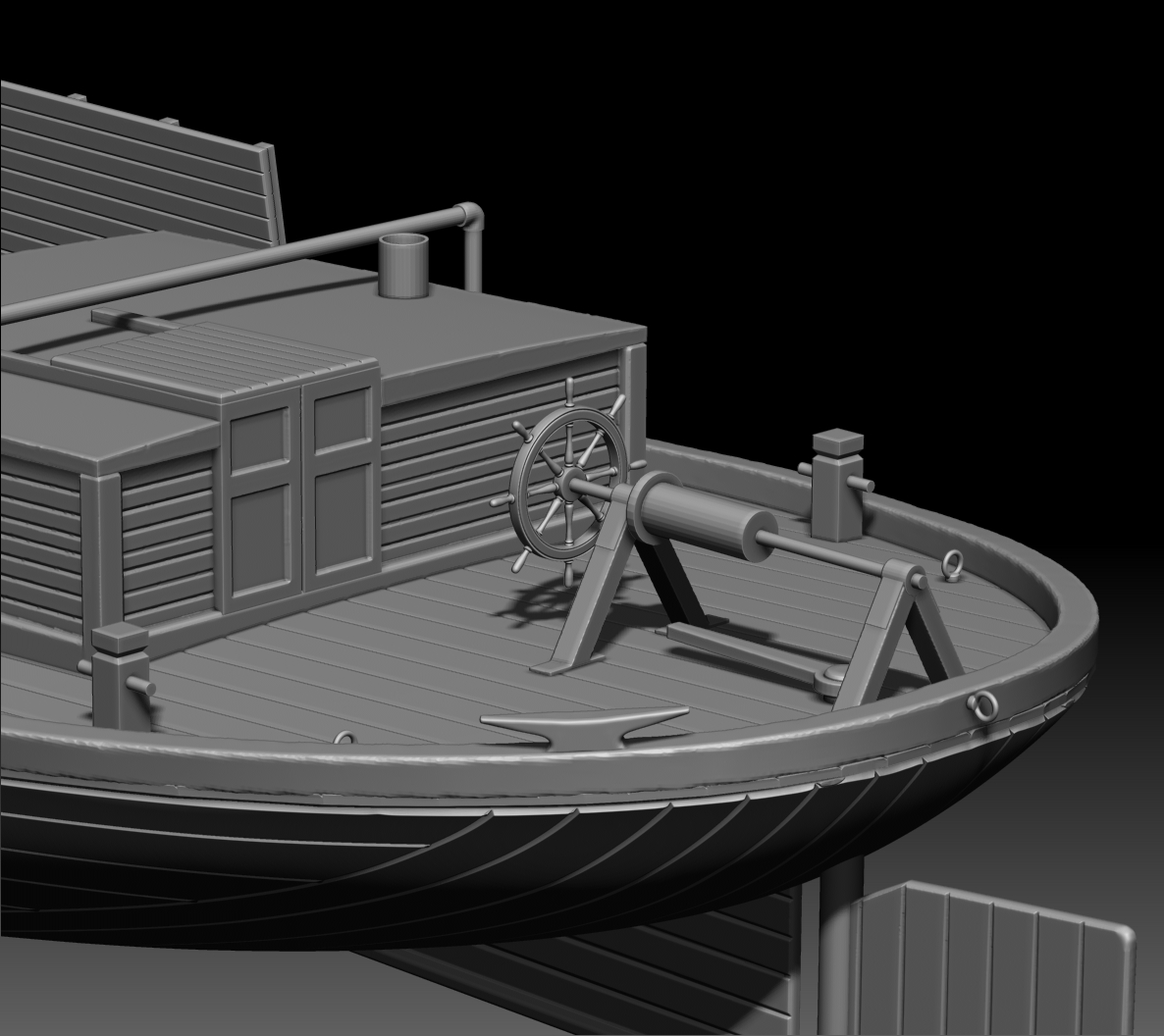

Hi everyone, it has been ages since I have had a chance to post anything. Here is the latest piece I’ve been working on. I hope you enjoy it. It’s still very much a work in progress all work done in ZBrush. This is a Gundalow which was a shallow draft barge-like sailing vessel used in this area. C&C always welcome.

This is pretty good :slight_smile:
I’ve often thought about trying to make boats (specifically a greek trireme) in zbrush, but i can’t figure out the best way to make the basic shape of the to start with.
How’d you do it? Shadowbox?
AnthonyA85, thanks.
Making the hull was tricky to figure out; it took me quite a while to develop a procedural method. I tried pretty much everything including Shadowbox. Nothing quite got me where I wanted to be. I finally came up with a good method thanks to some of the new tools in ZBrush 4R6. Specifically the Slice Curve and the Bridge Curve Brushes. Where I mention deleting something I always do that on a duplicate of the subtool; keeping the original in case I need to go back and redo something. I would also recommend trying this first on a simple hull form like the one I’m using to get the process worked out before doing a complex hull shape. This seems like a lot of steps but it is actually quite fast and intuitive once you get the hang of it.

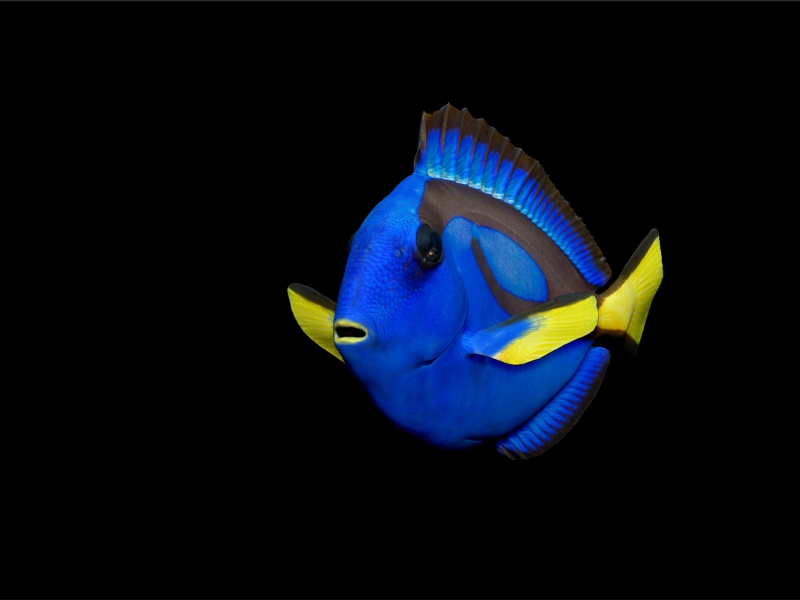

Hi All,
Here are a couple of fish I did recently.

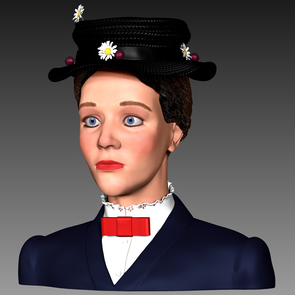

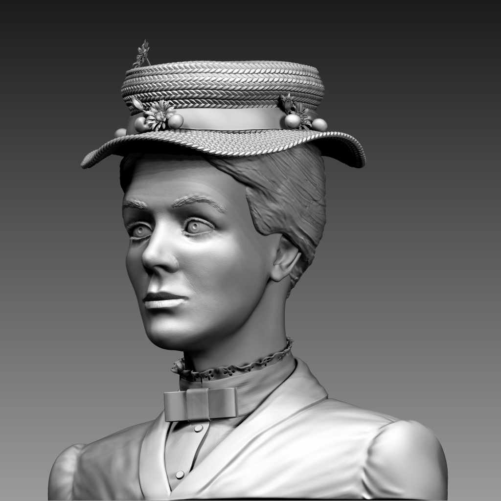

Hi Fellow ZBrushers,
This year marks the 50th anniversary of the film Mary Poppins. In honor of a great film and Walt Disney; I am embarking on what I hope will be a series of sculpts of some of the characters from the film. When my daughter was just 2 she and I watched this film many times. It was a magical experience we would sing the songs and dance to “Step In Time” and “Let’s Go Fly A Kite”.
My first sculpt is Mary Poppins portrayed by Julie Andrews, I hope to do her justice. This is still very much a work in progress so any Crits & Comments are always appreciated.
First a bit of reference:
Now my WIP:

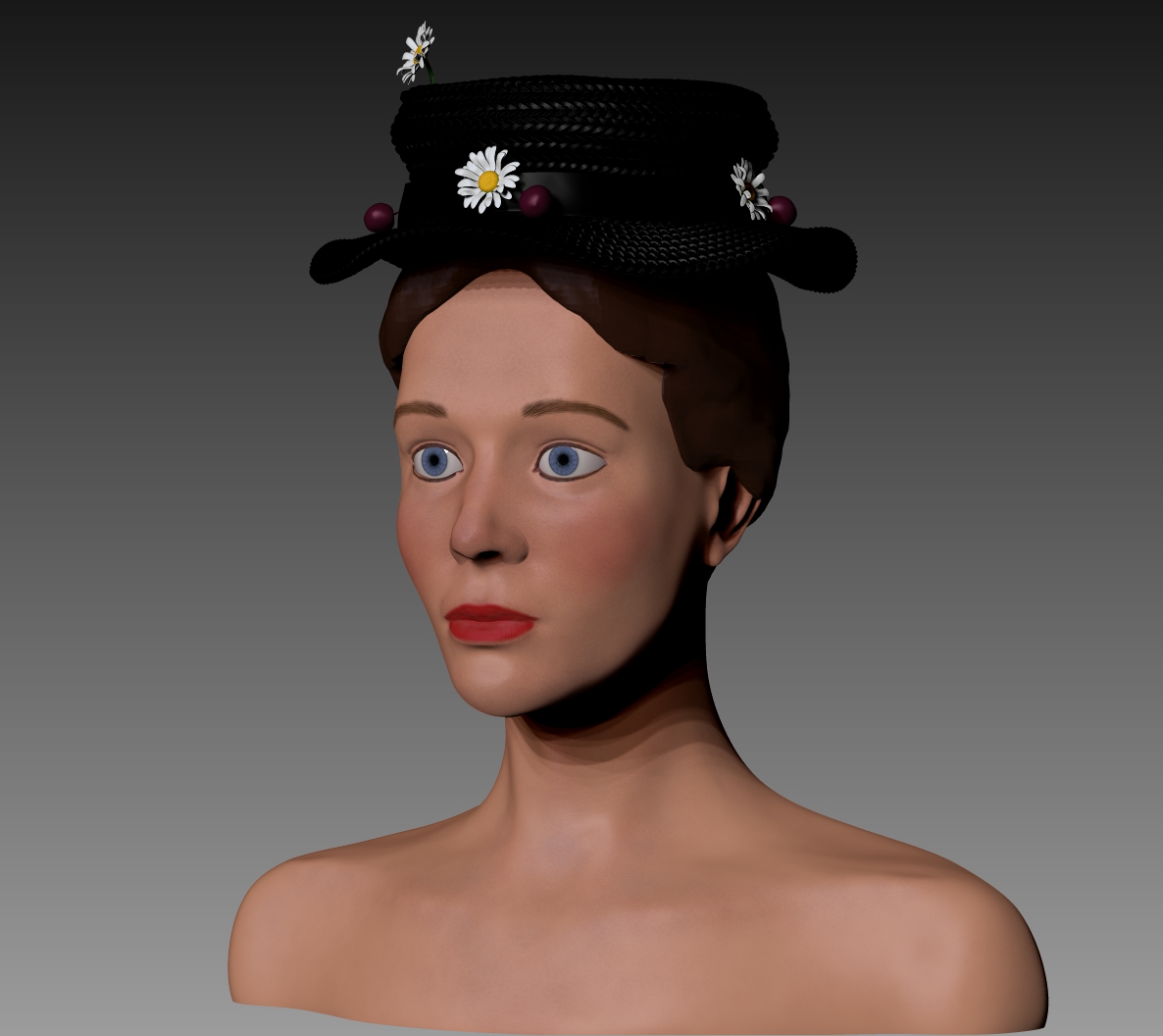

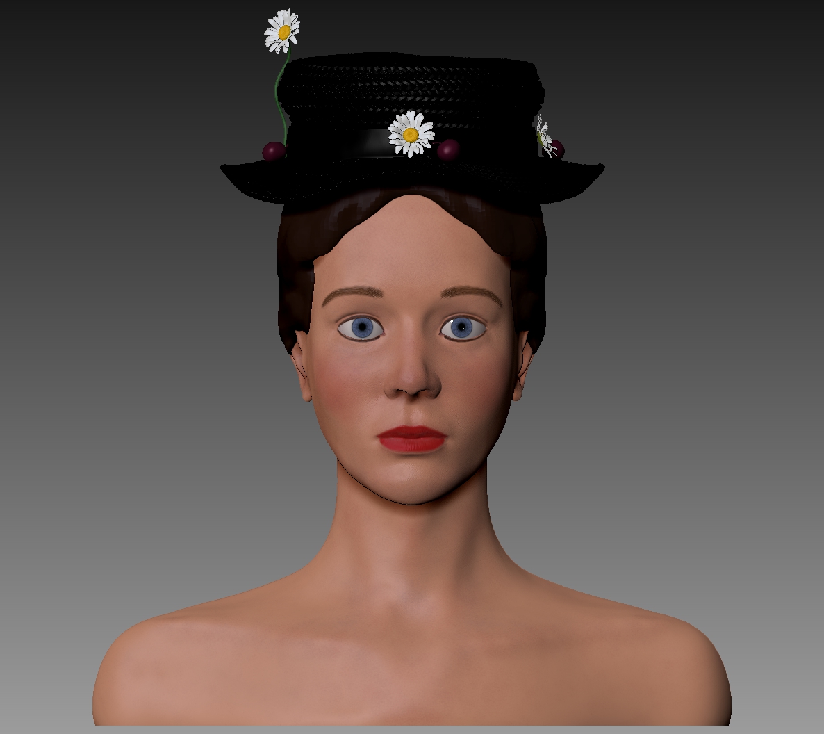

I haven’t had much time to work on this but here is an update on Mary Poppins, C&C welcome.
An update, C&C welcome.
Another update, I have tried to adjust the features a bit and get rid of the “deer in the headlights” look to the eyes. Hopefully the eyes better match the expression which admittedly is still a bit wooden. C&C always welcome.
