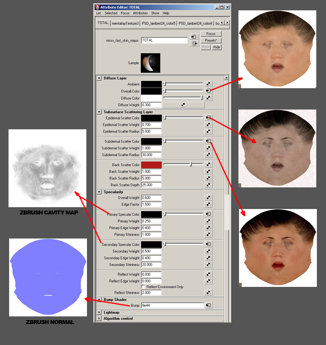

This are the textures I used. The weight values here are not important becouse I am going to breakdown the shader and compose later in photoshop.

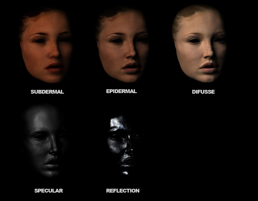

For breaking down the shader, I made different ones changing the values of the weights. For example for the diffuse pass, the weight of diffuse is 1 and epidermal, subdermal, specular, etc is 0.
With this shaders I got this renders:

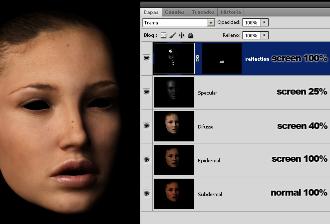

Then in photoshop, I used this blending modes to create the final skin.
Look that I made a mask for the reflection pass. Maybe you can duplicate the spec to create different brights in different zones, change the contrast, etc… This is ok for me becouse i am creating still images. If it were for animation, I would have to paint the weight of the textures before rendering the passes.
