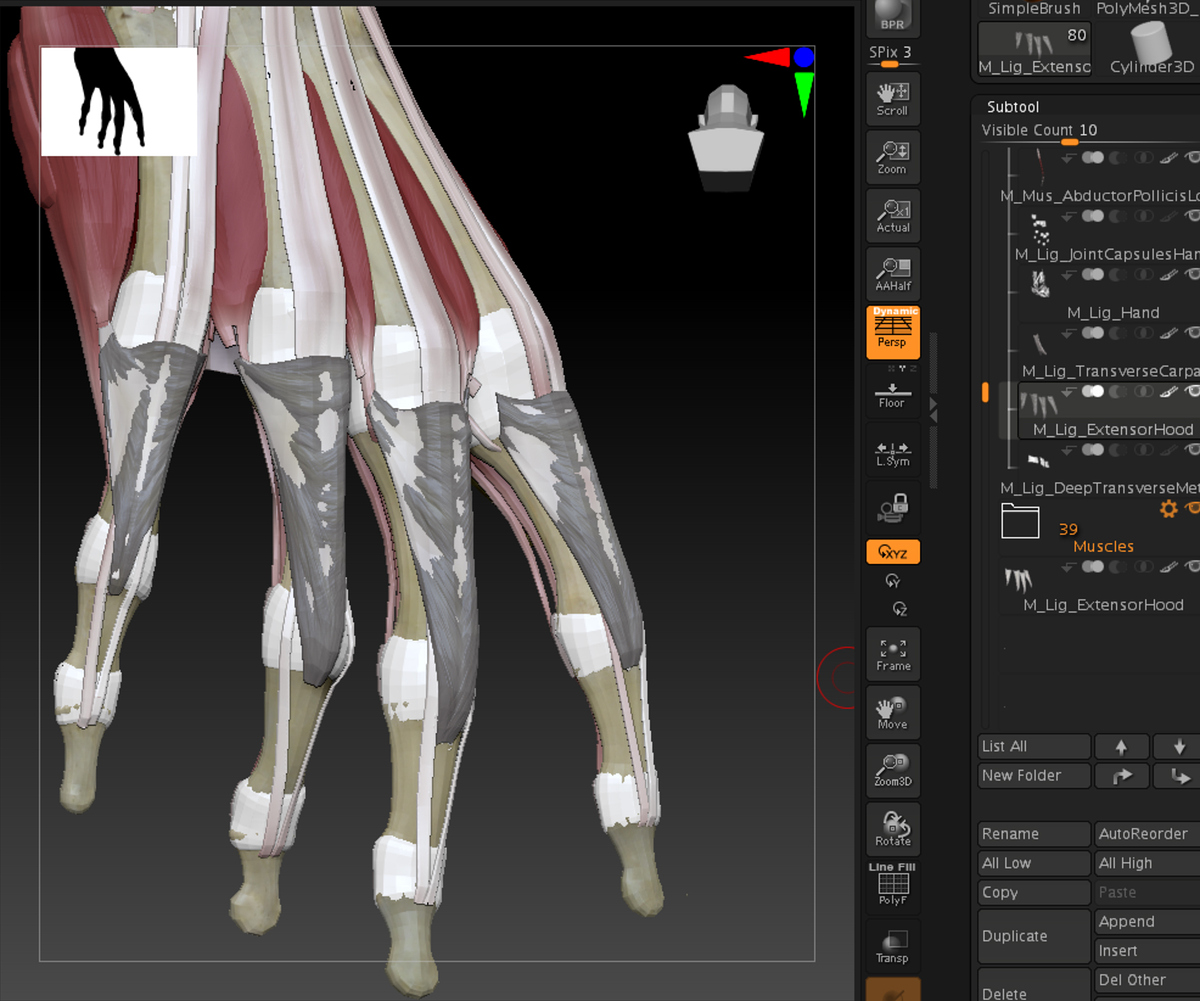

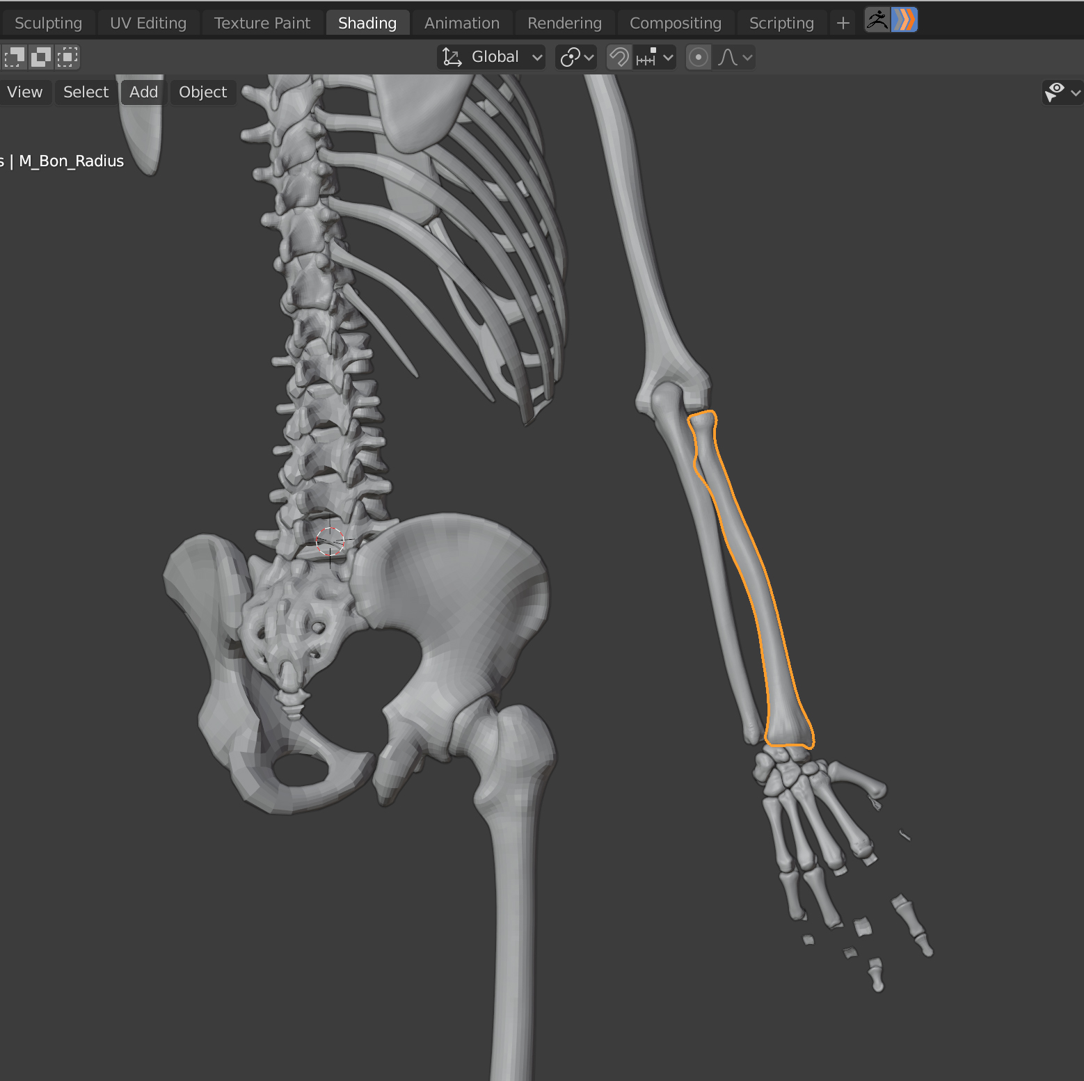

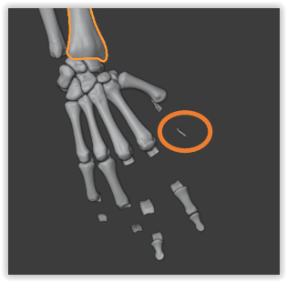

Hi, I’m trying to get GOZ working between blender and Zbrush. For some reason when I try and import SubTools to Blender some of the SubTools are missing, any ideas why this might be?

hi, are whole subtools missing or only parts of them? in your picture it looks like some bones are only partially transferred

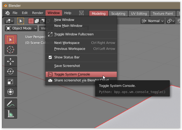

And can you check if you get any errors in the console when sending subtools from zbrush to blender, that would help to identify the issue

Hi, thanks for the help with this. I’ve tried installing the new add-on but still having the same issue. However, if I try sending the visible SubTools from Zbrush to a new blank blender file seems to import everything. Is only when I try and send the SubTools to my blend file that has other objects in there that I get the problem. The meshes that do come through are complete, those small meshes are actually ligaments.
I’ve appended the new blender file to the blender file with the other objects and seems to have worked. Is there a limit to the number of SubTools with GOB? I’m on a Mac so I don’t have that console option unfortunately, will see if I can find out how to access the console on a Mac.

i found some tutorial here how to get the terminal window for blender on mac os, would be great if you could try this and see if you get any errors.

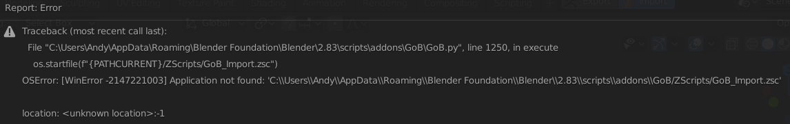

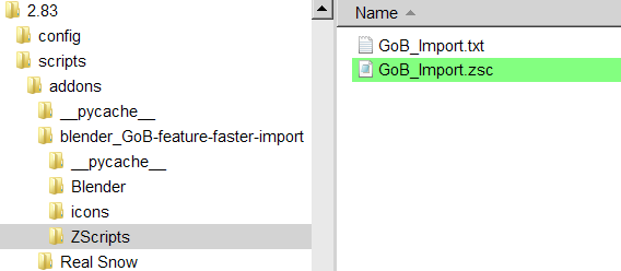

I am having problems with this latest version (3.4.6) running. I keep getting the following error report in Blender 2.83.3 when I click “Export to ZBrush” button. The “Import” from ZBrush works OK and doesn’t show any errors.
I followed the install instructions in the README.md file exactly.
@zber2 can you navigate to that folder location and see if that .zsc file is there?
The only thing i could think off would be that you have the addon installed under another name and there might be some confusuin.
Have you tried to remove the blender addon completely and copy it to the addon folder again?
@kromar This is the one that I downloaded… https://github.com/kromar/blender_GoB/archive/feature/faster-import.zip which was named “blender_GoB-feature-faster-import.zip”
I did the renaming that was suggested in the README.md file wich was…

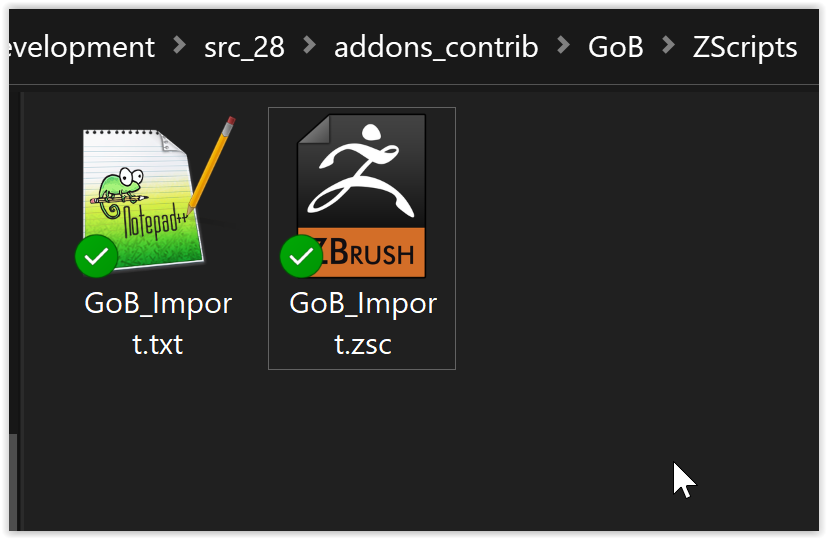

@zber2 can you try to run the zsc directly with zbrush? the error says it does not find the application so maybe you need to tell the system to open the zsc file with zbrush.
Are you referring to this zsc file
ZBrush is not an available option that I can select to open that file with.
I tried installing GoB via the Install button in Blender Preference and I tried putting GoB folder in manually and I still get the same thing. I’m on Windows 7 Pro if it matters.
I reverted back to GoB 3_3_8. That is the last one that works properly.
I really appreciate your efforts kromar, but don’t worry about it too much. Any new ones you post from now on, I will try though.
it looks like the default application is set to notepad on your system for the zsc file.
it should have a zbrush icon so that will be the default it opens with. if that is not correct the addon will not work since that is required to trigger the loading in zbrush.

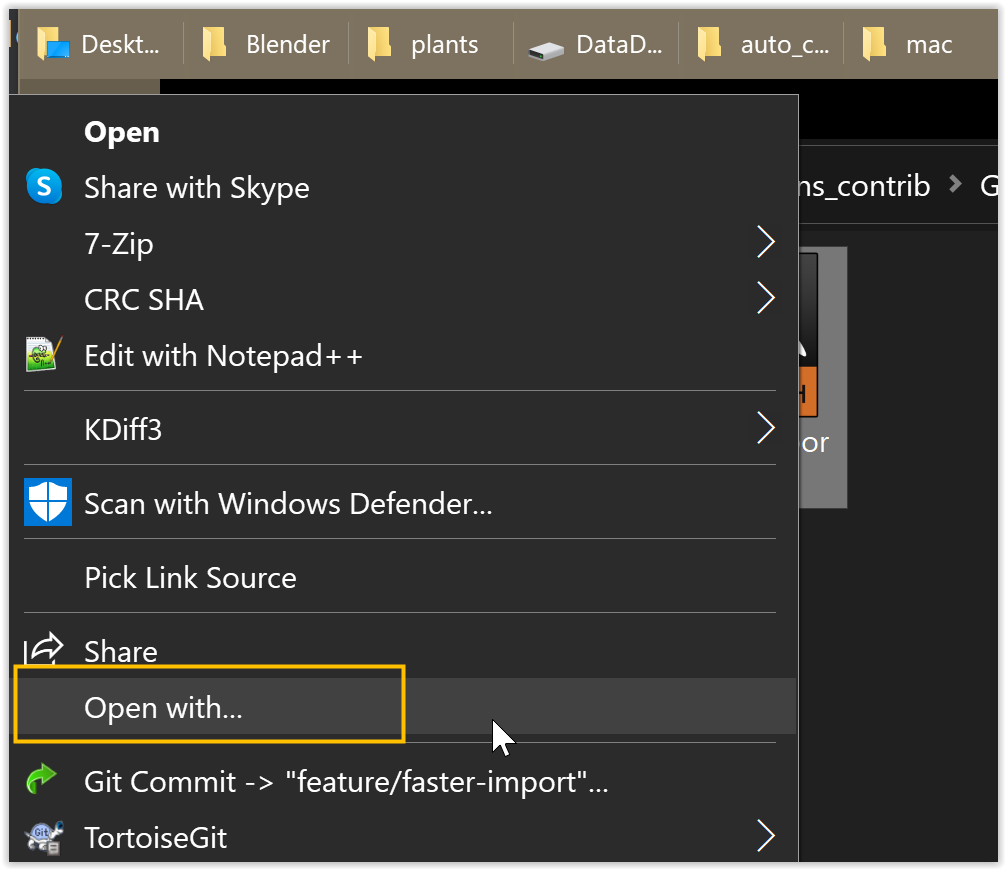

if you right click on that script you should find a “Open With…” in the context menu where you can specify that it should always open with zbrush. that should hopefully fix your problem.
Yes, I tried that, but it won’t give me ZBrush as an option even if I browse to the ZBrush executable.
hm ok that is strange.
can you try via the windows settings, if you type “default apps” in the search it should take you right to it.
there should be a option for selecting app for file extension, maybe you can change it in there
I don’t have “Choose default apps by file type” option though. I’ll see what I can figure out though. Thanks kromar.
if you have a older operating system you might need to change it in the registry. can you tell me what version of windows you are running?
maybe try searching for Default Programs
