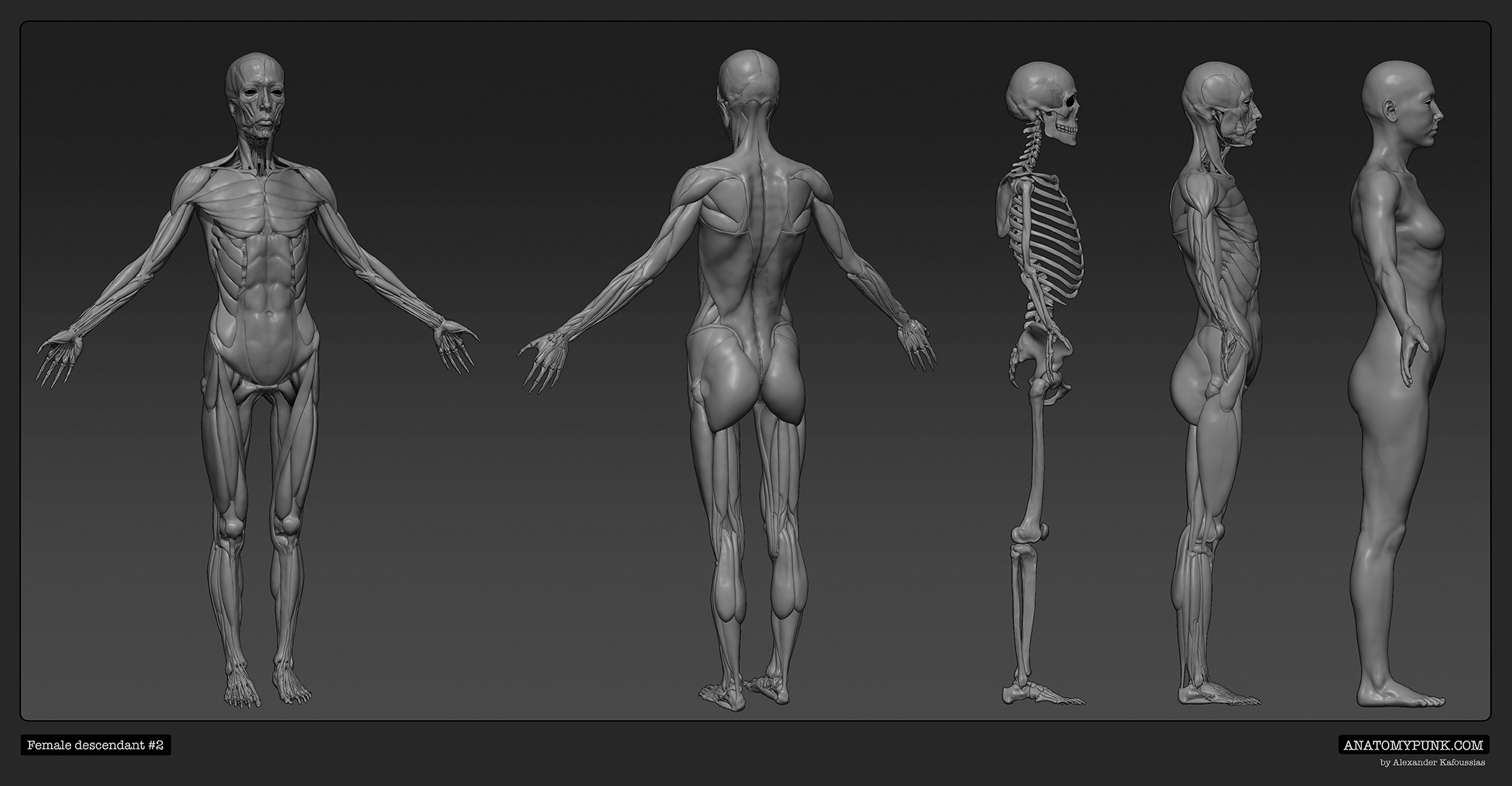

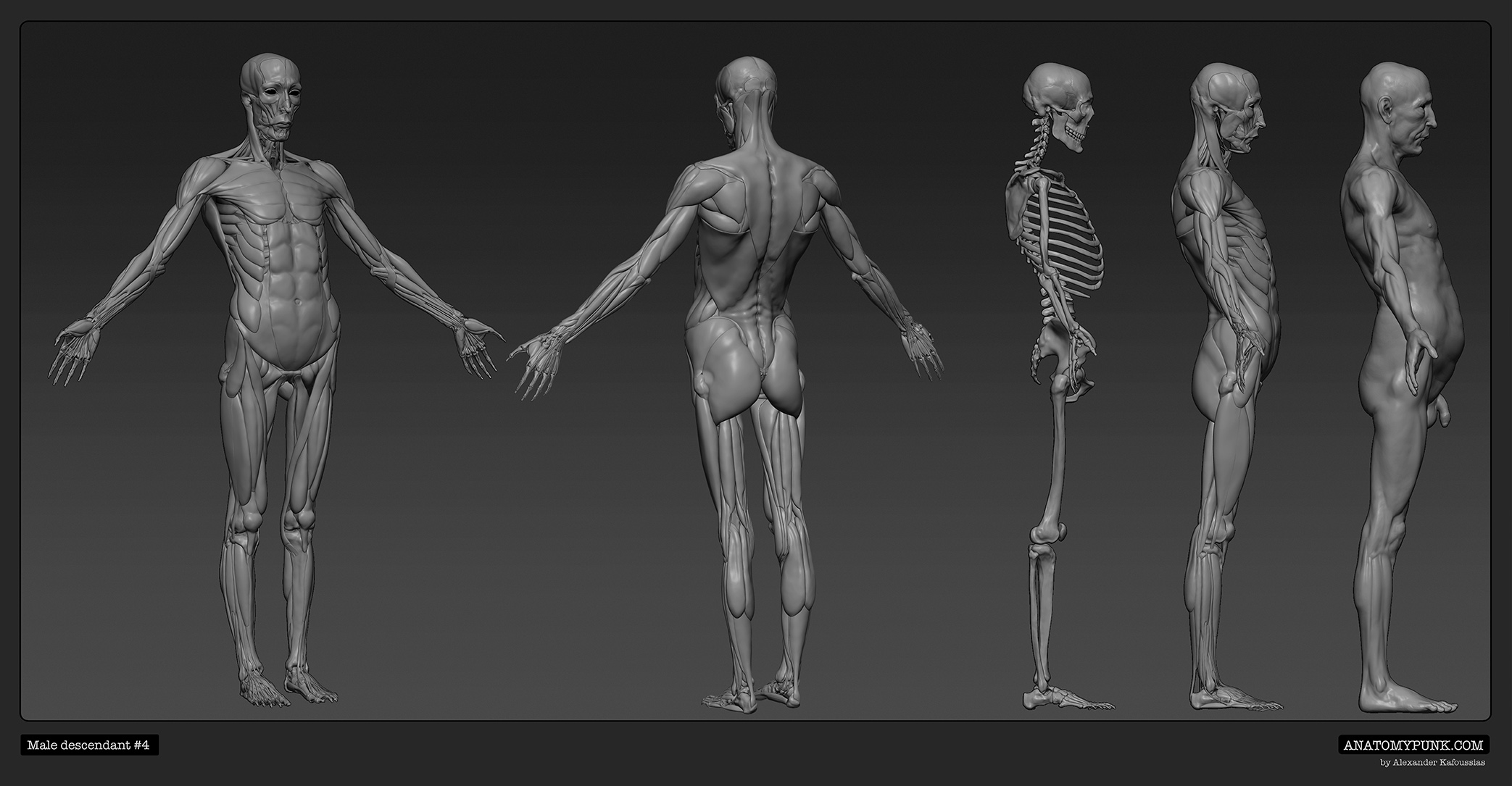

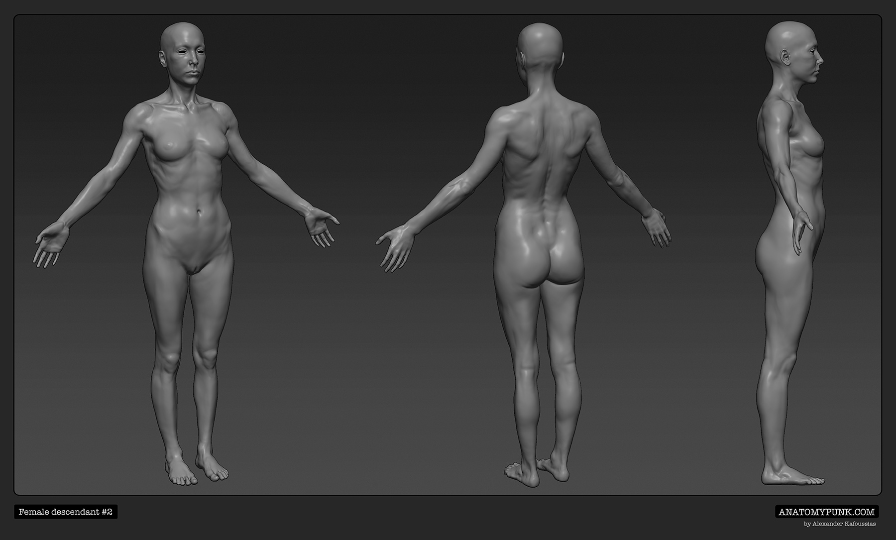

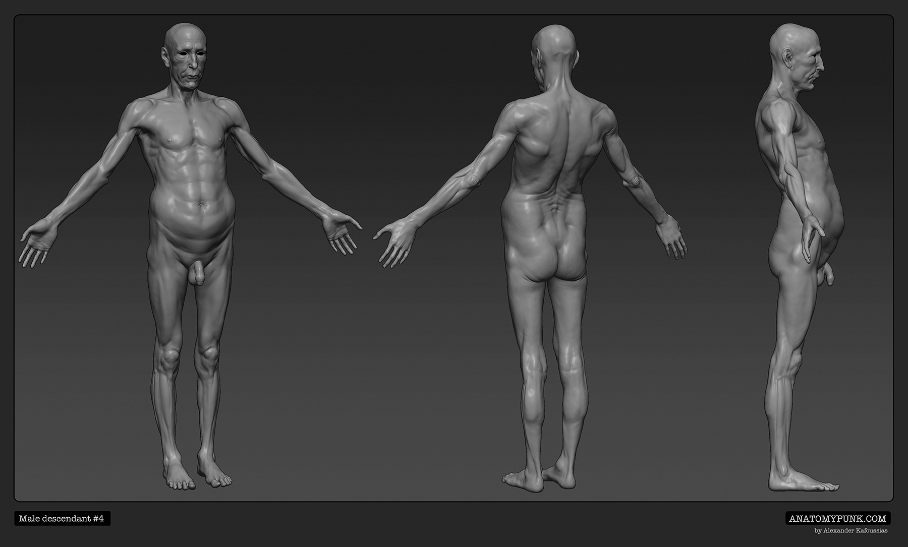

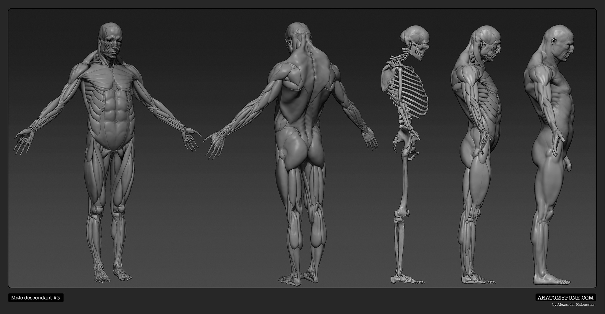

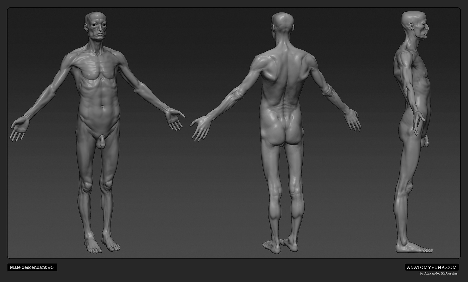

just wanted to add some new stuff. The purpose of this project was to refine the workflow, with focus on flexibility and speed. I managed to get down to about 4-5 hours per figure from scratch (from about 20 hours). Also, I experimented some with projection (Project all) which is the reason why things goes faster now. All of the figures below have been designed inside out and then got the skin projected on top of the muscle and skeletal structure (I do jump a lot back and fourth between skeletal, muscle and skin. Project-all is very forgiving). On top of that only fat and some wrinkles was added. I like the idea of designing the anatomy this way since it minimises the risk of bad design due to sloppy sculpting. I also tried to make them different from each other. This is something I really struggle with, I keep repeating certain designs which becomes very obvious in the end. Hopefully with some more practice I’ll get better at it.
Hope you like it
Alexander
