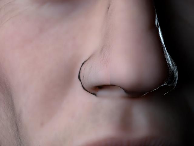

Hi, This looks like a good place to ask people about this.
I can’t figure out why my bump map creates these black lines in some creases of the face and wondered if anybody here has had similar issues and knows a fix? I’ve tried mapping 16 and 32 bit displacement maps and normal maps into Vrays SSS2 bump channel but can’t get a result.
Any help appreciated.
SquareSunStudios : hey thank you!
RHudson: I never had this kind of weird render, but I guess you are using a normal map? try to not use it and redo a render to see if it does it again. and don’t use 32 bit with Vray, do not work for the displacement excepted if you used it in exr format. I use 16 bit, it does the job and weight less.
zboot : Can you please remove your render from my thread please, it’s like it hijacked my thread I found. thank you
Big guns, I’m using a normal map in tangent space and it’s fine when I delete it.
I ended up reducing the contrast of the map where the dodgy shading happens. It’s not a proper fix but looks better than it was. Actually I get quite alot of unwanted shading from the normal in general so used a highpass filter to extract the tighter details and it looks to be ok for now.
